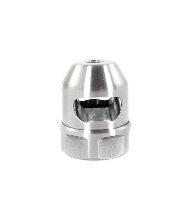

Going to put a longer barrel on my rifle, I’ll need a muzzle brake but I want to minimize the length.
This thing looks like the way to go.
Anyone have any experience?
Also about muzzle brakes in general; if your caliber isn’t represented how much performance loss will occur when you are forced to go a size up?

The first port matters the most, with something like 50% less effect for each subsequent port (1 unit recoil reduction from 1 port, 1.5 from 2 ports, 1.75 from 3 ports, etc.). With my long barrels I like folding and removable stocks.
There is technically a measurable difference in performance for jumping up a size, but your shoulder won’t notice.

You get ~half of the total effectiveness from the first port. Your shoulder will absolutely feel the difference between 1/2/3 mostly-identical ports; unless it’s a big magnum, 4/5 probably isn’t too different.
Your shoulder will not feel the difference between a brake bored for 6.5mm and a brake bored for 338 when shooting 6.5mm.

Yeah this is going on a 7mm, I don’t need loads of performance, just a little less would take it back into my comfort zone. Currently it has no brake and I’ve been surviving. I think it’ll work fine.
