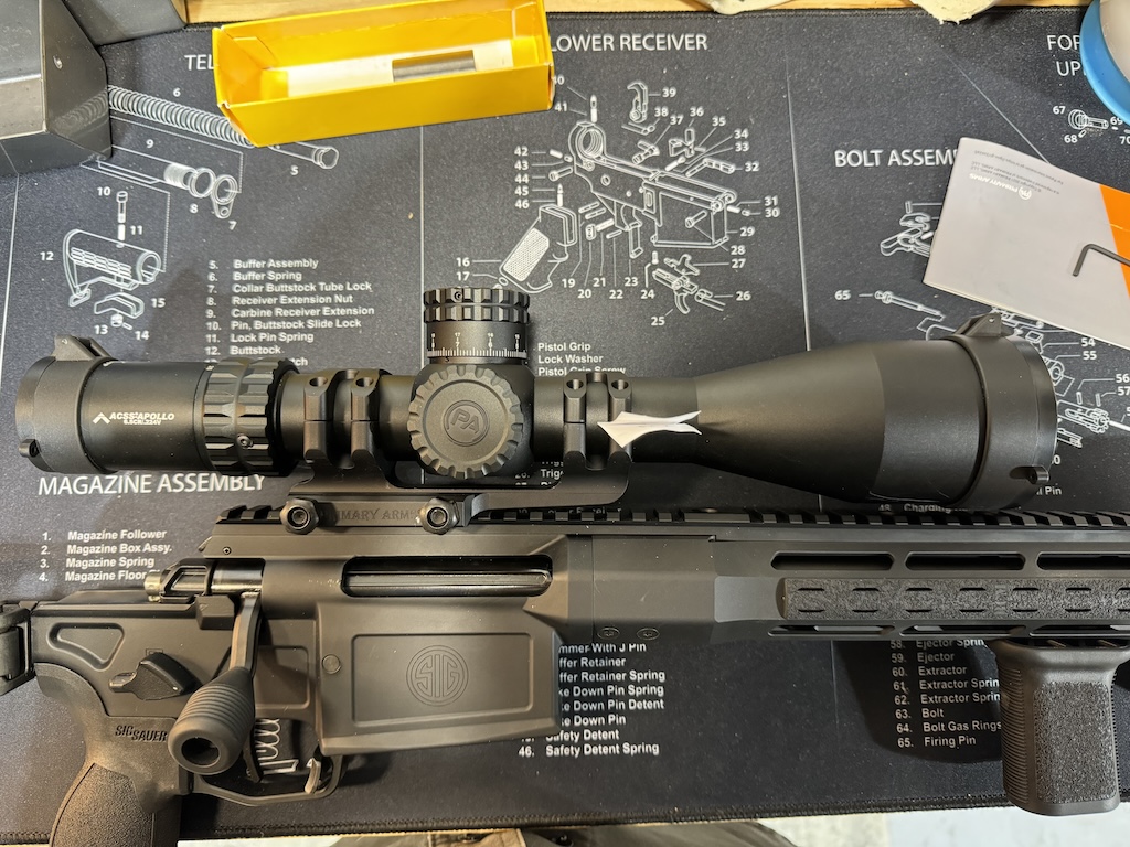

I jut tried to zero my new 5-25-56, however the zero stop is preventing me, I'm 8" high and dialed down to the zero stop. Other scopes allow adjusting the zero stop but I can't find any info on this PA scope to change it. Any help appreciated. Thanks.
Have you tried reading the user manual?
I just looked at it. Seems pretty simple.
Release the zero stop.
If you have a canted base, you may not be able to get a 100 yard zero.
Yes, I read it. It specifically says DO NOT adjust the zero stop until you are completely zeroed. Boldfaced print. I am not completely zeroed. I sent a support request to PA, waiting for their reply. Was just wondering if anyone else went thru this same thing.
The first thing I do when I zero a scope is release that zero stop and only get it set once I'm zero'd where I want.
I don't see why that would matter or why PA would specifically say not to touch it until you are zero'd..... adjusting the zero stop is part of zeroing 🤨
Sorry! Manual should be clearer. If you don't have enough elevation to zero you are either bottomed out or do need to adjust to give you more elevation. PM a phone number and I will walk you through it.
obviously, you need to release the zero stop to get your final adjustment.
My experience has been that scopes typically do not have the zero stop locked from the factory, apparently they do things differently.
FWIW, that is, in my opinion, poorly written and I certainly can't fault you for following directions.
Marsh1, thanks. A rep from primary gave me instructions. Went to the range today and was able to zero elevation? However windage hit it's stop today. Have a few inches to the left I still need to go. Is the procedure for windage similar? The manual mentions nothing about adjusting that.
It would be helpful if you told us about your entire setup, rifle, base, rings etc...
When tightning your rings to the base, be careful, if you run one ring down all the way untill it is tight, you might have your scope angled to one side.
Loosen all lthe screws holding the rings to the base, when you tighten, tighten in increments and alternate between front ring and back ring until they are snug. Watch the body of your scope as you do this, you'll likely see it see saw slightly side to side as you tighten the rings to the base.
There could be other issues, but try this first.
No such adjustment for windage. You should not need it. fday beat me to it in asking about your setup. A picture would also help
Thanks Gunny, rifle is a Sig Cross STX in 6.5CM. Scope is a PA 5-25-56 and rings are a PA GLx34 Cantilever 0 Moa scope mount. I did alternate when tightening the rings, spacing seems ok, a folded piece of paper fits equally between the ring clams with just a little tension as the paper slips in. I'll loosen and redo just to make sure it's not off side to side. Unless you have another idea what it could be.
Is there any particular reason you went with a cantilever mount on a bolt gun?
They can certainly work, but they are typically used on an AR type rifle. (Lots of folks do use them on bolt guns).
Do you have either another rifle to try the scope and mount on, or another known good scope in a set of rings that you can mount on your cross?
What we need to do is find out if it is a rifle problem, a mount problem or a scope problem.
I have had rings that wouldn't fit properly in one picatinny rail, but fit fine in another.
Tolerance stacking is a thing and can be frustrating.
I have had good luck with these and it would be a low cost way to troubleshoot if it is related to the mount.
Amazon product ASIN B0BBLCGF8P
I went with that mount only because PA recommended it with purchase of the scope. I may just go with your suggestion for those rings, they're just $35 and I've probably spent that already just trying to get on paper. Any suggestion on what profile rings I should get for this scope, low medium or high? (pic above shows scope on the gun now)? Scope is 34mm tube. I used an online calculator and came up with a high profile. Thanks so much for your help. I'm new at scope mounting, but had no problem mounting and zeroing PA's 1-6-24 on my AR but this one has been difficult.
