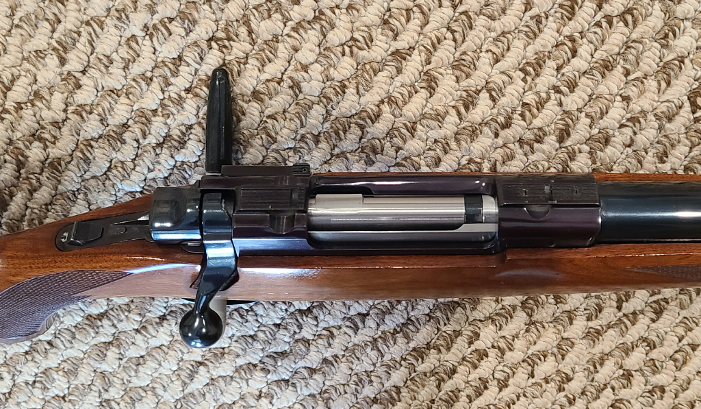

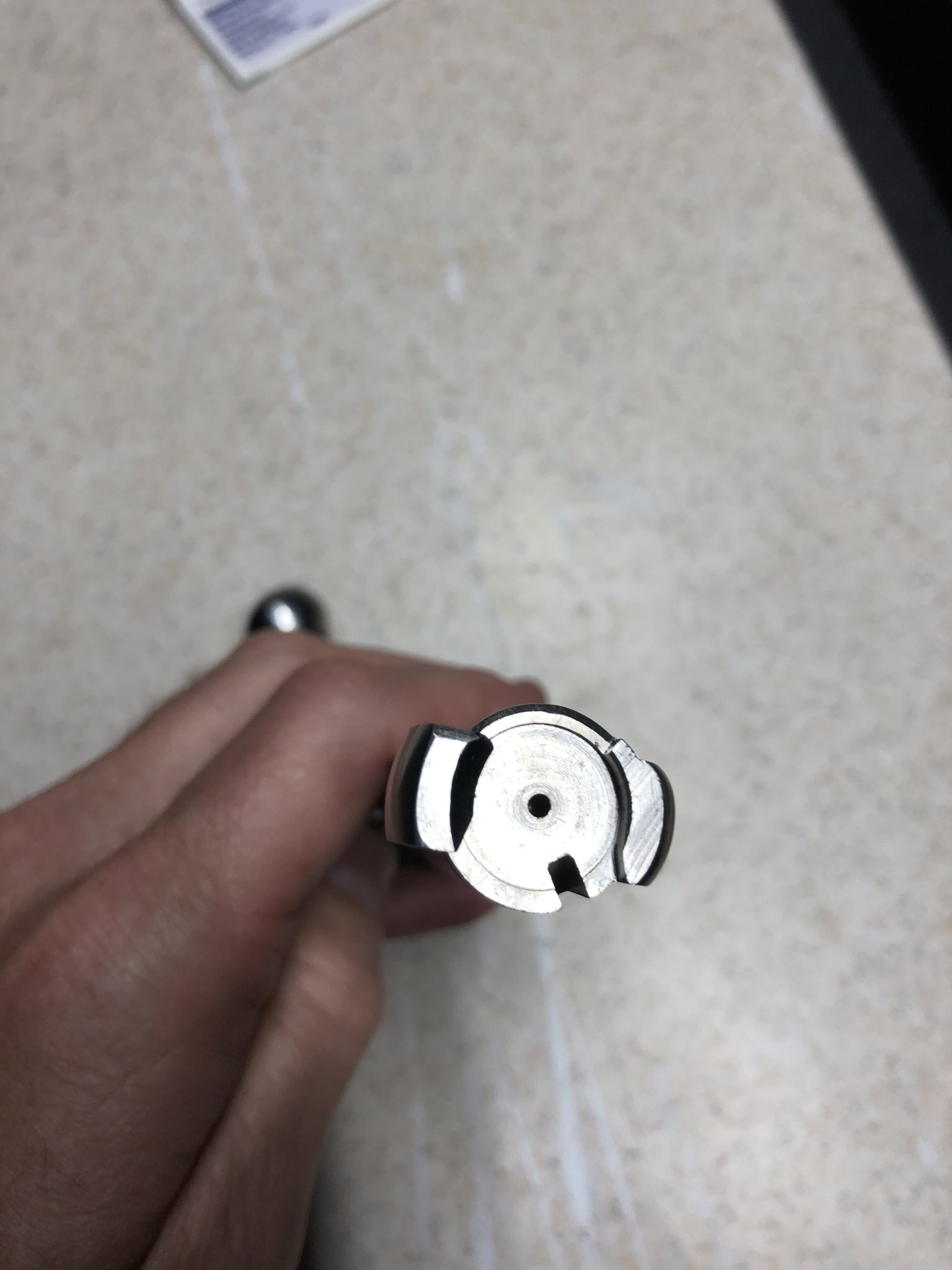

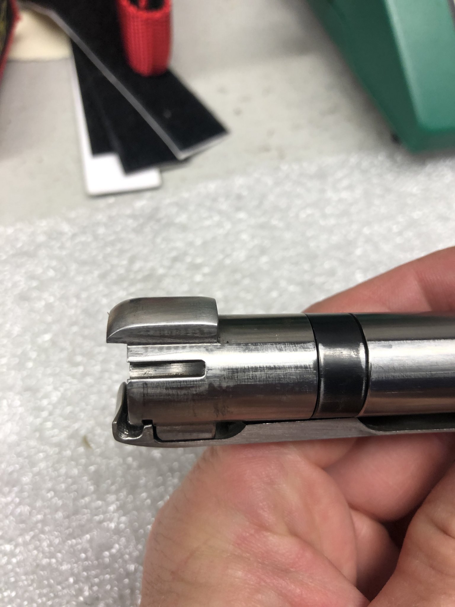

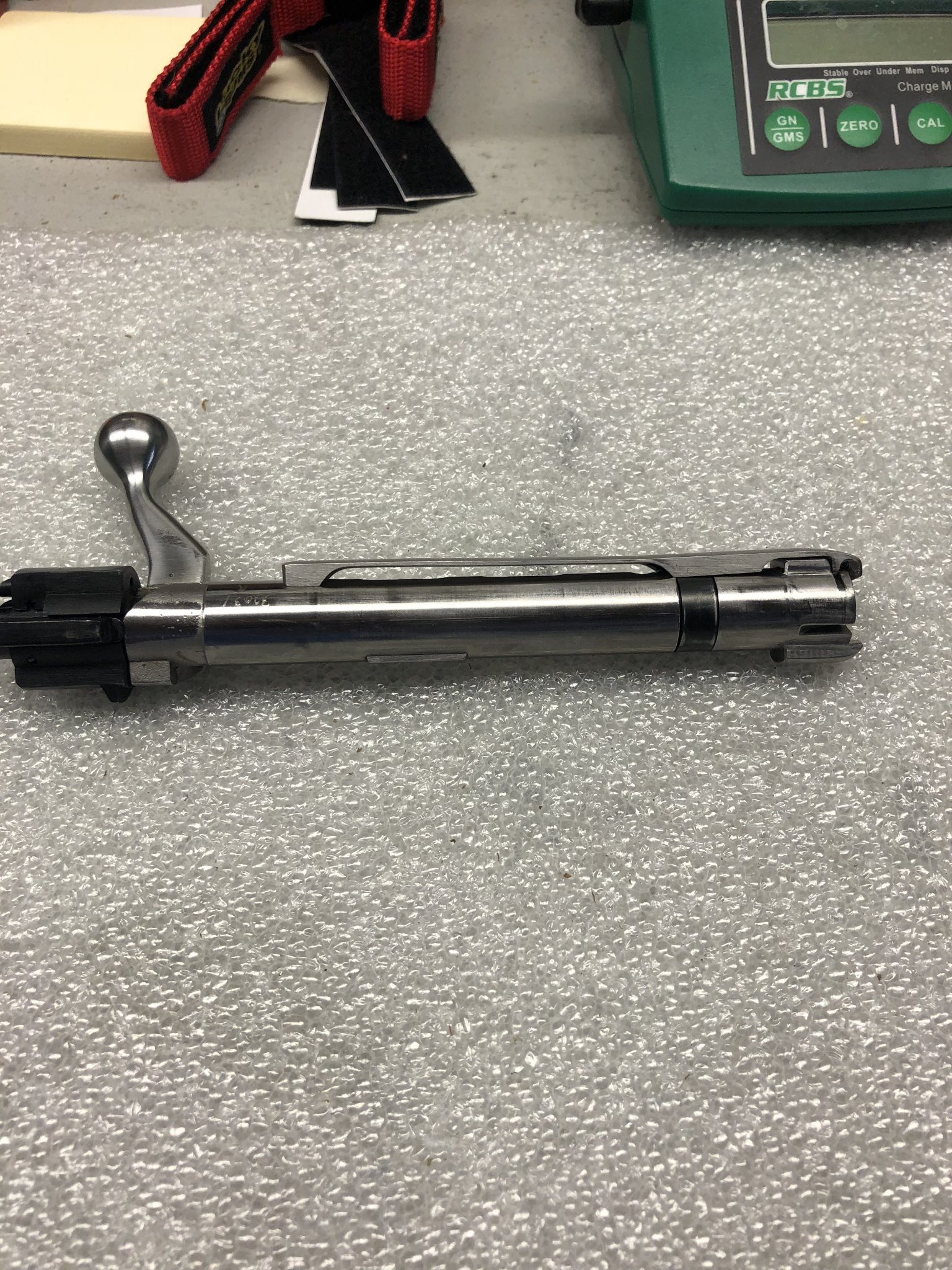

I will post a few pics below, ask if you need a pic of something. Long story short, a friend asked me to mount a new scope on a family members rifle and also mentioned that it’s not ejecting spent cases ( case gets extracted and lays there sometimes causing a jamb).
How does this gun eject cases? (first m77 I have looked at)
From research it appears to be a transition m77 to m77 mark 2.
Tang safety
No plunger on bolt face

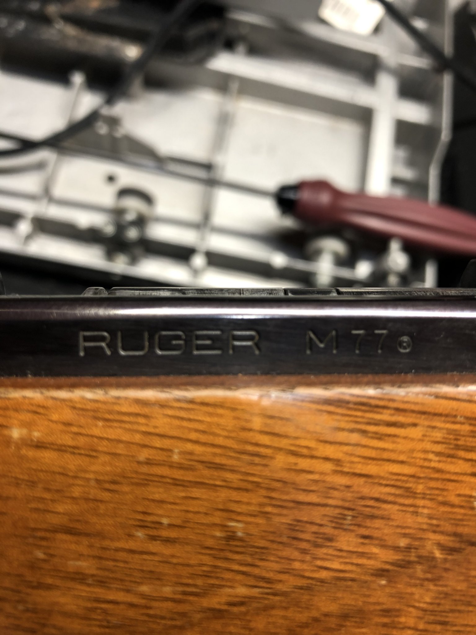

Labeled “Ruger m77” on rifle
Hear are some pics. How does the rifle case ejection work on this gun. Trying to learn something here and there is no good information on the web to explain.

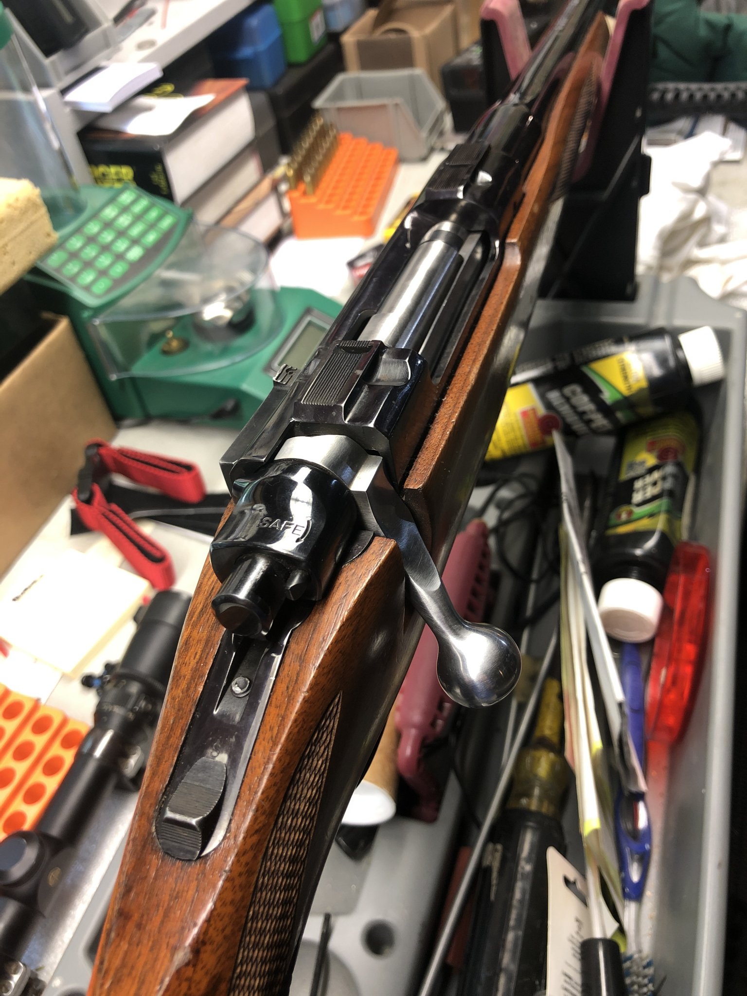

What is this slot on the bottom of the bolt?

Tang safety Ruger’s did not come with manual ejectors; as stated above it should have a plunger ejector.
They changed over to plunger ejector with the MK II. I have had a few of each, and still have a tang safety m77 in 270.
Maybe a smith tried to convert it? Post a pic of the bolt face.
Disclaimer- I’m not a Ruger Historian so my first statement could be incorrect.
Tang safety rifle with a non tang safety bolt shroud.
And I believe the bolt handle should be blued.
The serial numbers match making you feel it's a "leftover parts" gun?
I noticed that also. Bolt shroud is for a MK-II and is marked as such.
Also, an 80s M-77 bolt handle would be blued and probably have turned plum by now.
OP, check the serial number on the bolt vs the receiver. The only way they will match is if someone re-etched the number on it.

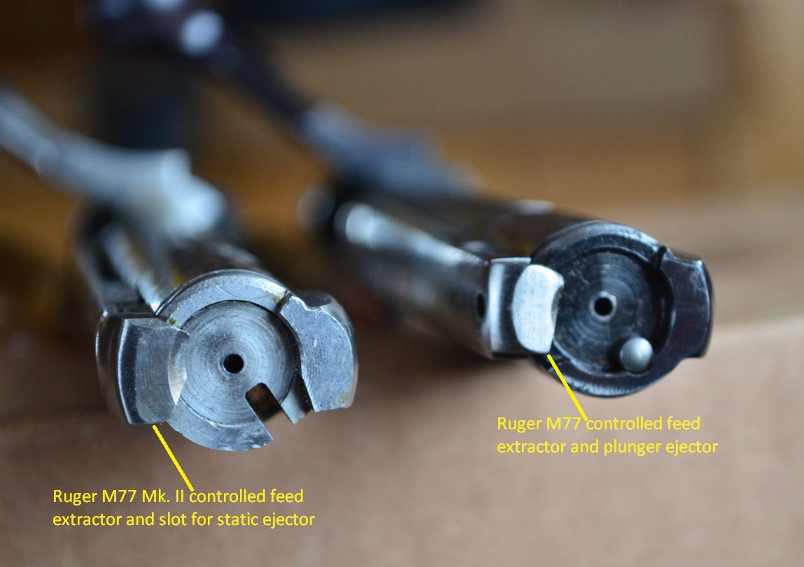

The more I look, the more confused I am. Two photos stolen from the net. Both styles. (well, all three)
(Mauser, Ruger, Remington) Ruger cut farther from center.
Below, closer to center.

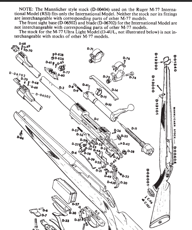

This is a pic of my 1978 M77V I sold a few years ago, action was a purple color and barrel and bolt handle
were dark blue. I thought it had a manual ejector but it did not it has a plunger that you can see in the parts
schematic D-8 D-9. This particular example showed superb workmanship in the fit and finish.

The OPs bolt is incorrect, but modified to work.
It's clear that the bolt is a MK-II, yet the serial number request has gone completely ignored.

Well, as others have stated, the M77 tang safety were all push feed bolts with the extractor plunger button in the bolt face, they stopped making them in 84.
What you are showing is a m77 tang safety with a modified bolt, so a gun smith had to re-build the bolt ( looks like a m77 bolt head, with a mkII bolt face) and placed a fixed blade extractor in the back of the magazine. So as stated the serial numbers will not match anymore.
On edit, the bolt head is from a mkII as well, it looks like the firing pin shroud is from an old m77 bolt, it doesn't have the indent for the 3 position safety.

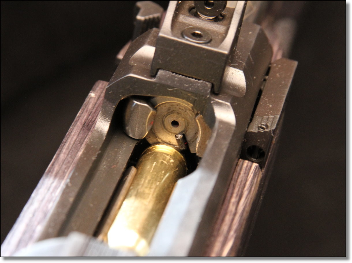

On the m77, when the bolt was pulled back the shell would eject as soon as the neck cleared the port, now with this modification, the shell is ejected when the bolt is pulled back to its stop point.
sgtsmmiii is showing you a picture of what you should see when the bolt is all the way back, and if you are not seeing this then the extractor is sticking or absent as he stated.

With that said, the OPs bolt is from a MK-2. His action is a tange safety model. They don't belong together, but it works to fire it.
