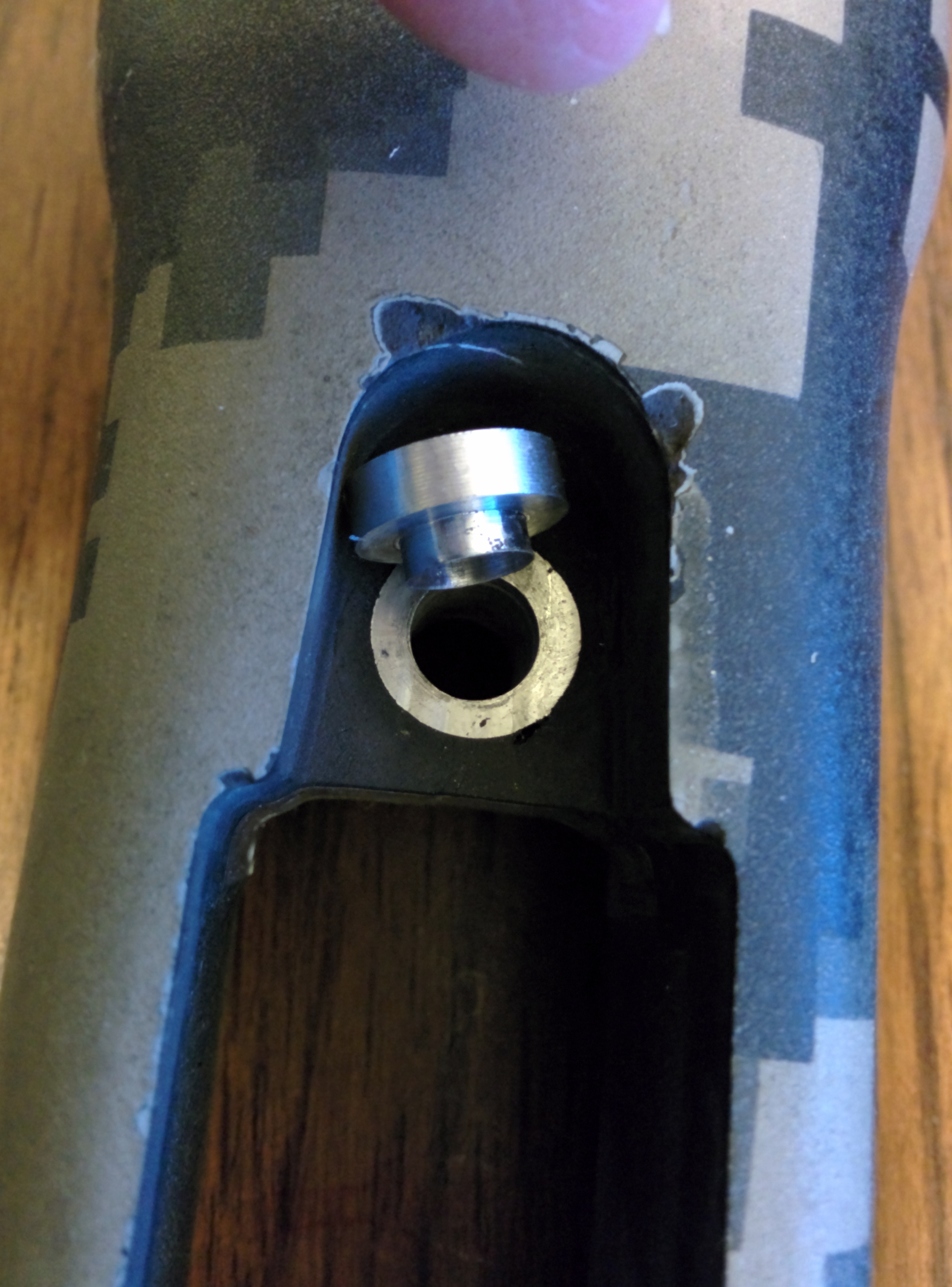

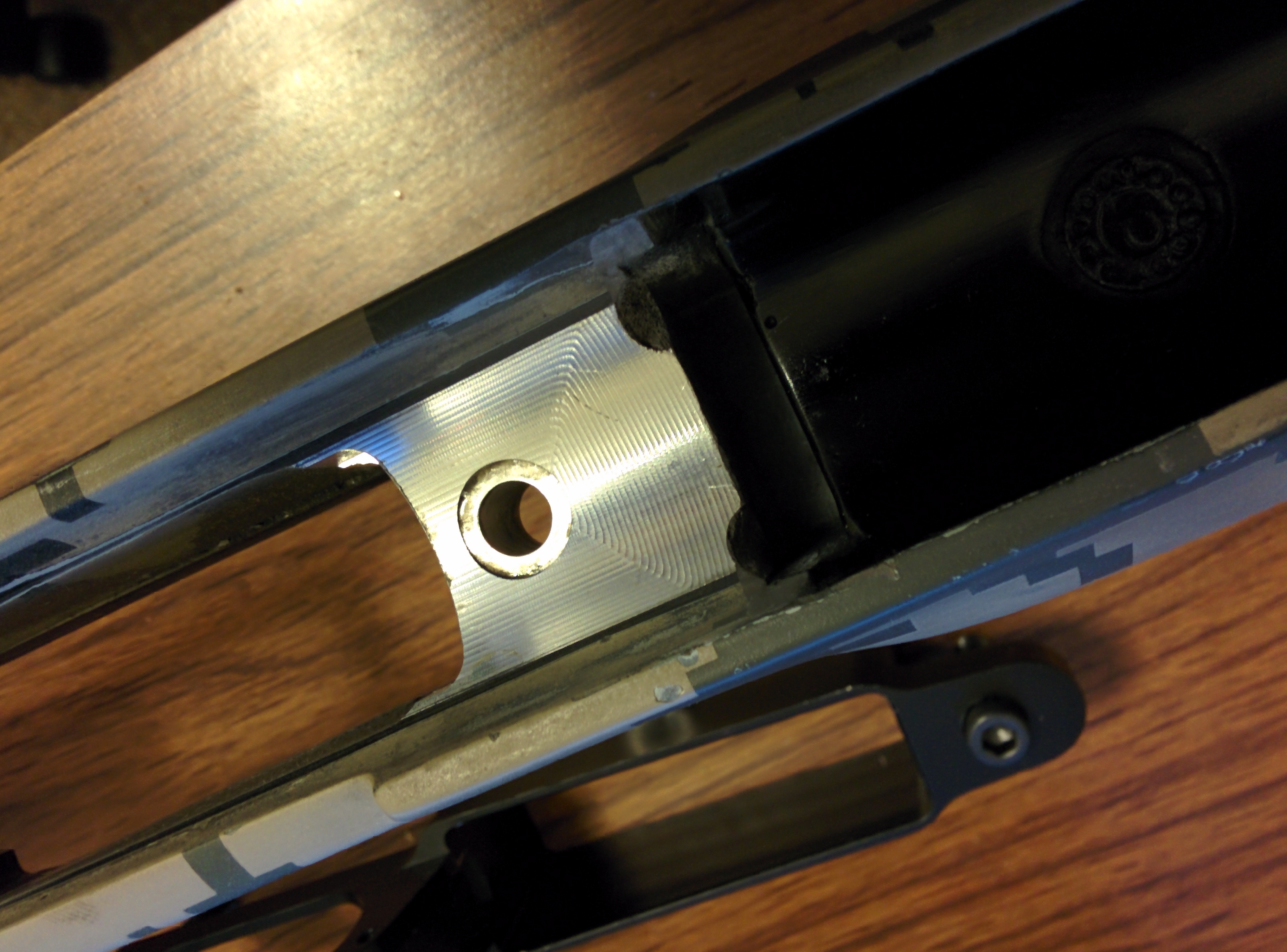

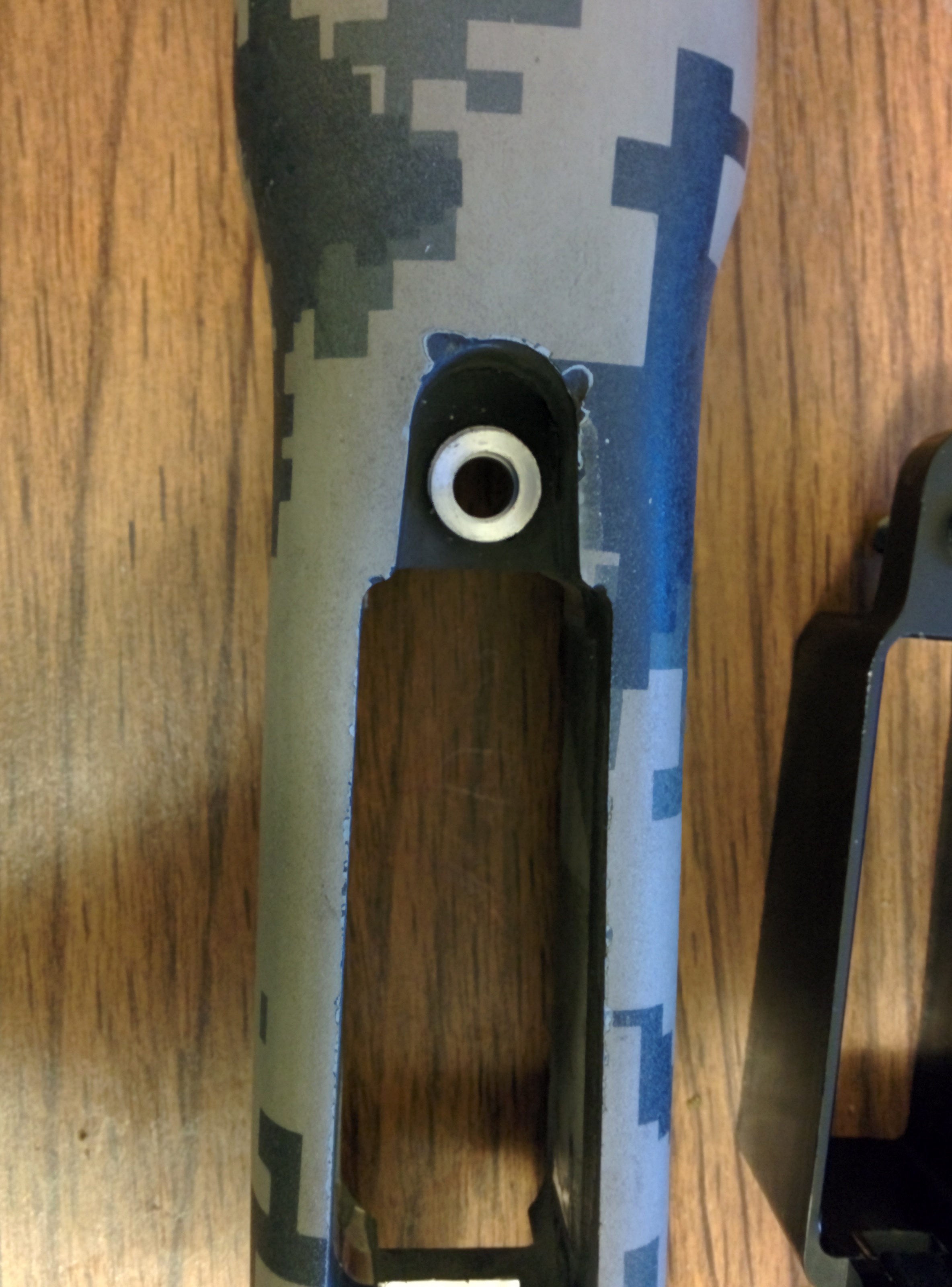

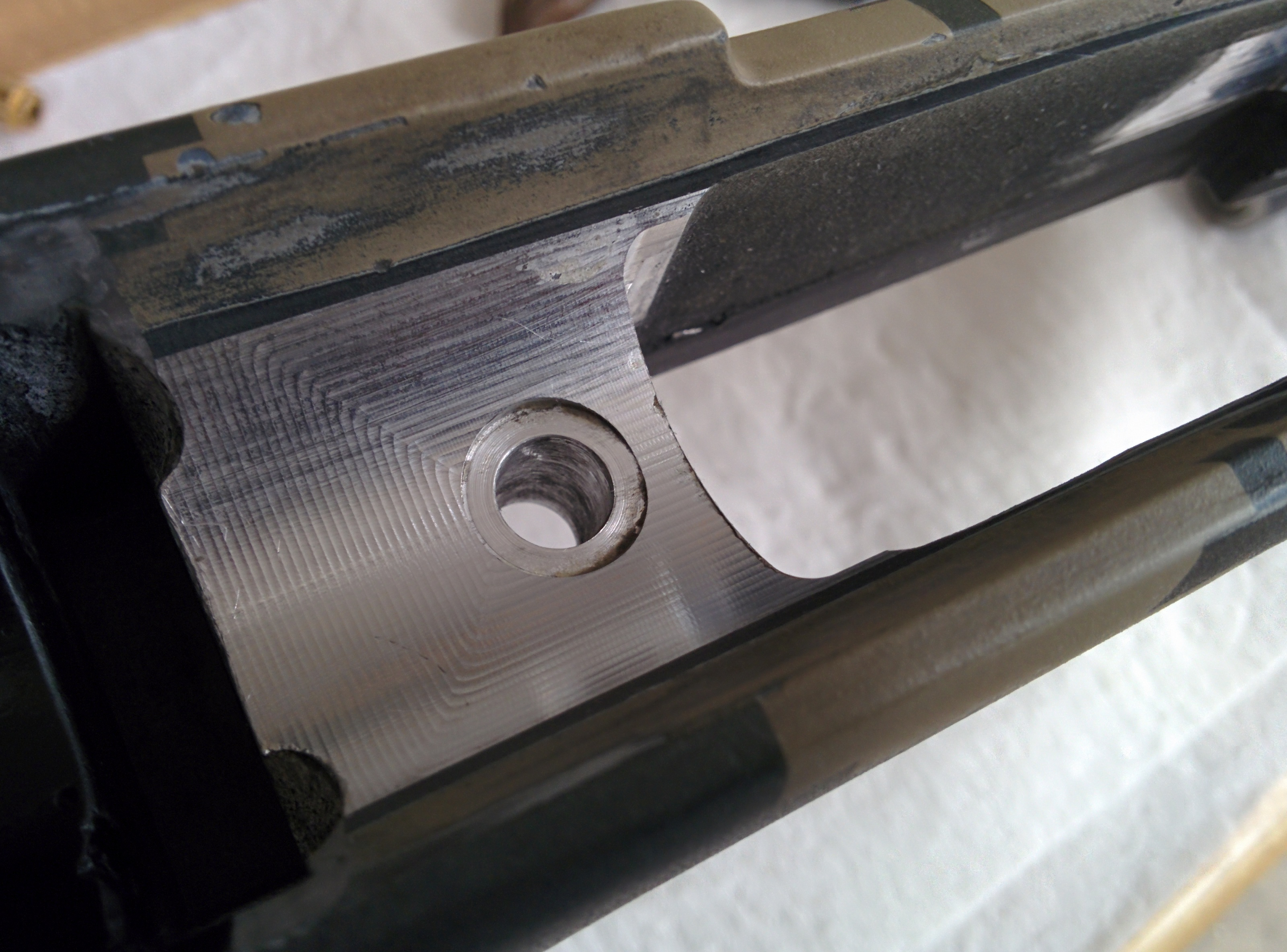

I've done a couple (and had a couple done by LRI). I don't have any pictures off hand, but I can get some later. Anything in particular that you need to see?

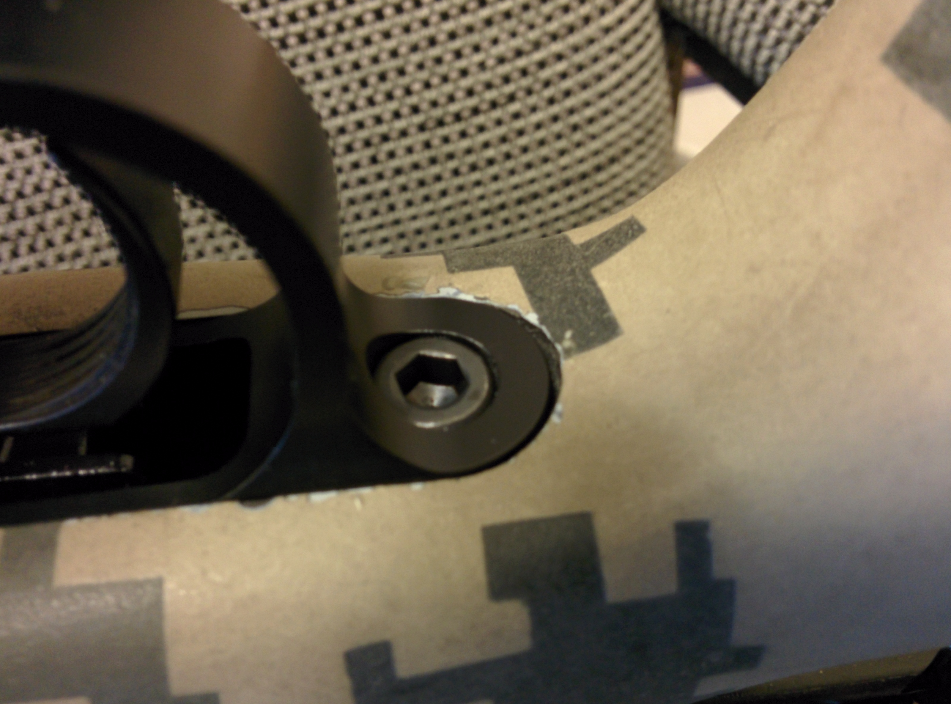

Here's a pic that was on my phone. This doesn't help you but it shows Chad's awesome tricked out mill work on the bedding block.

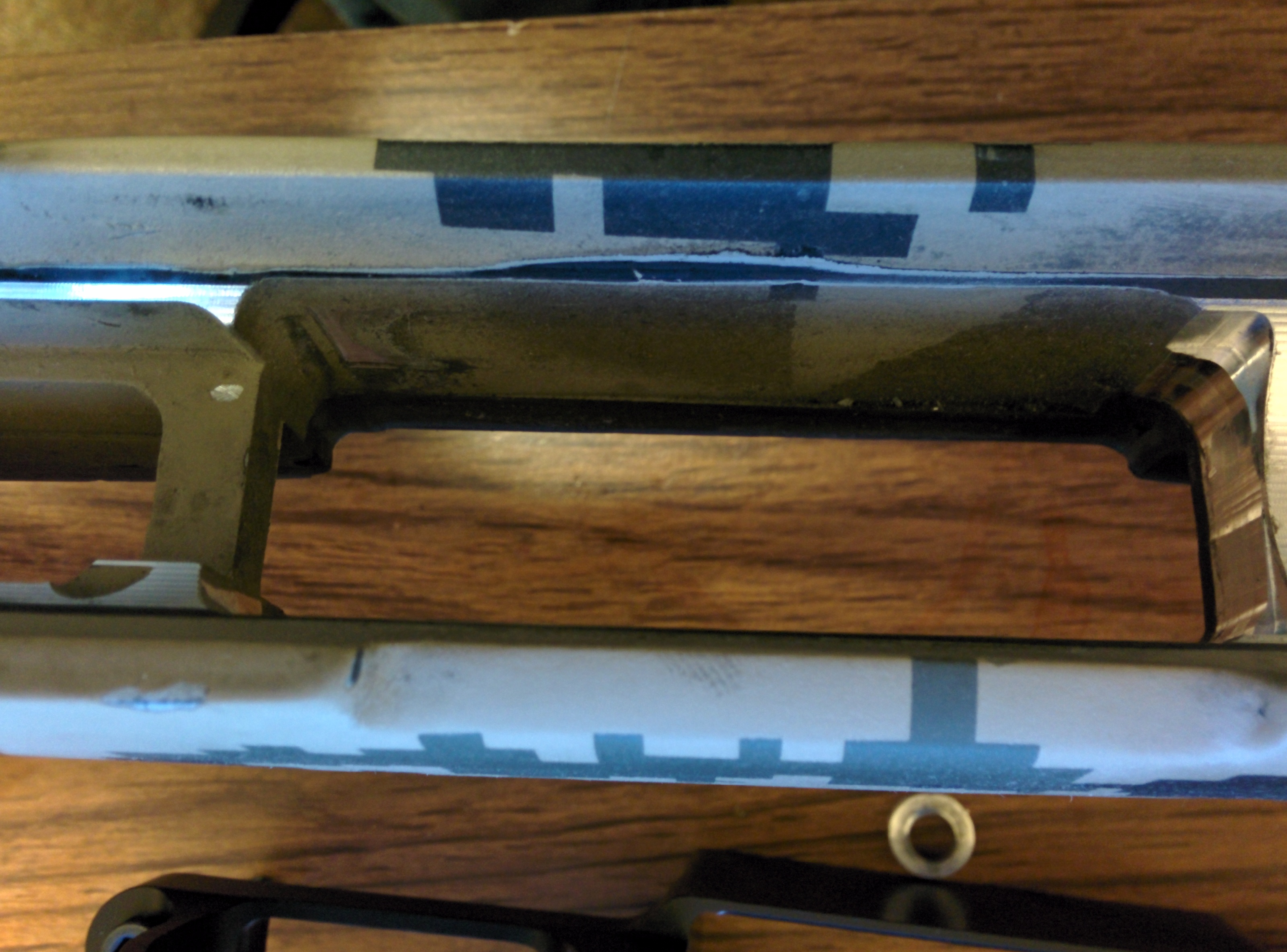

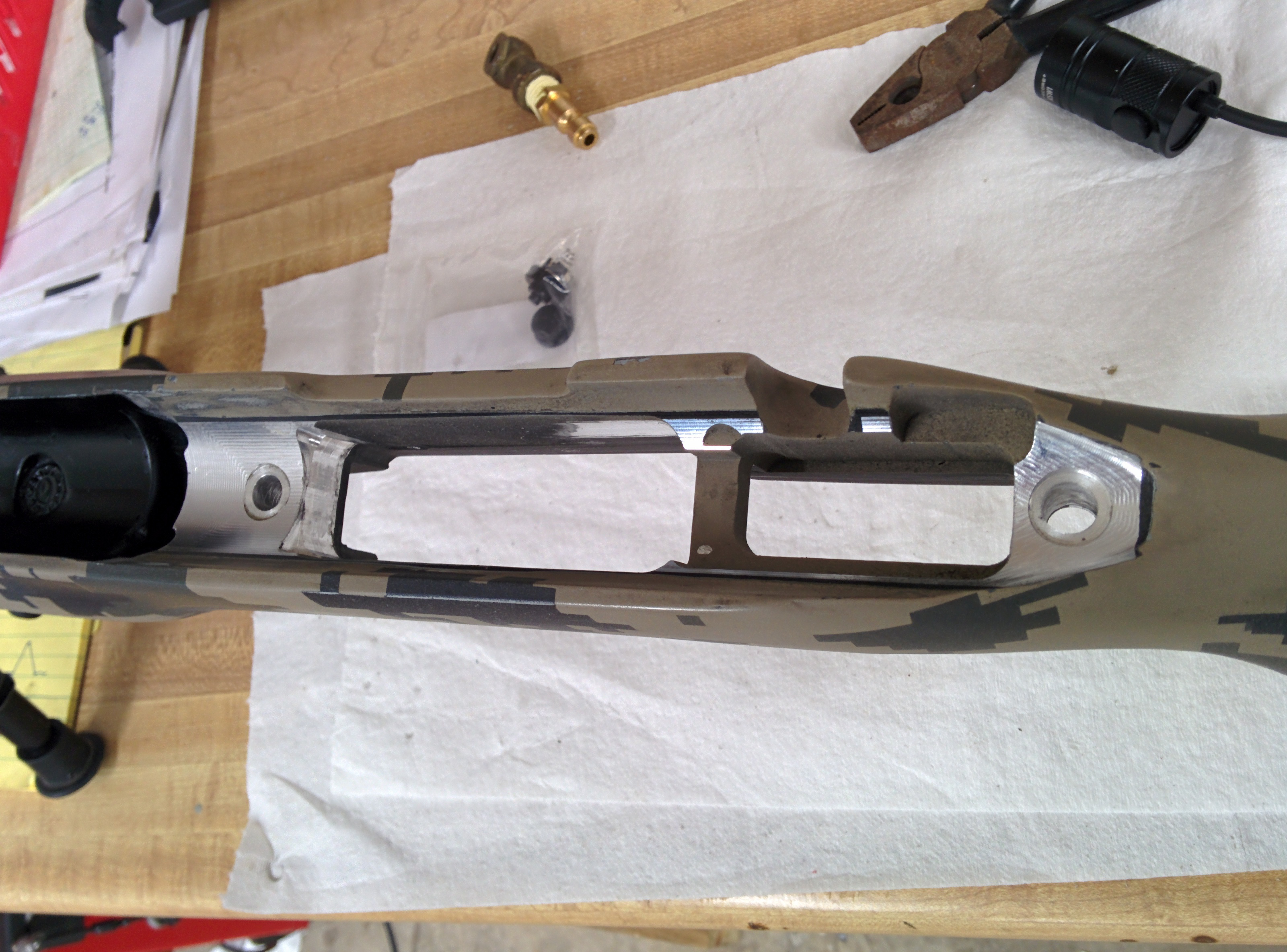

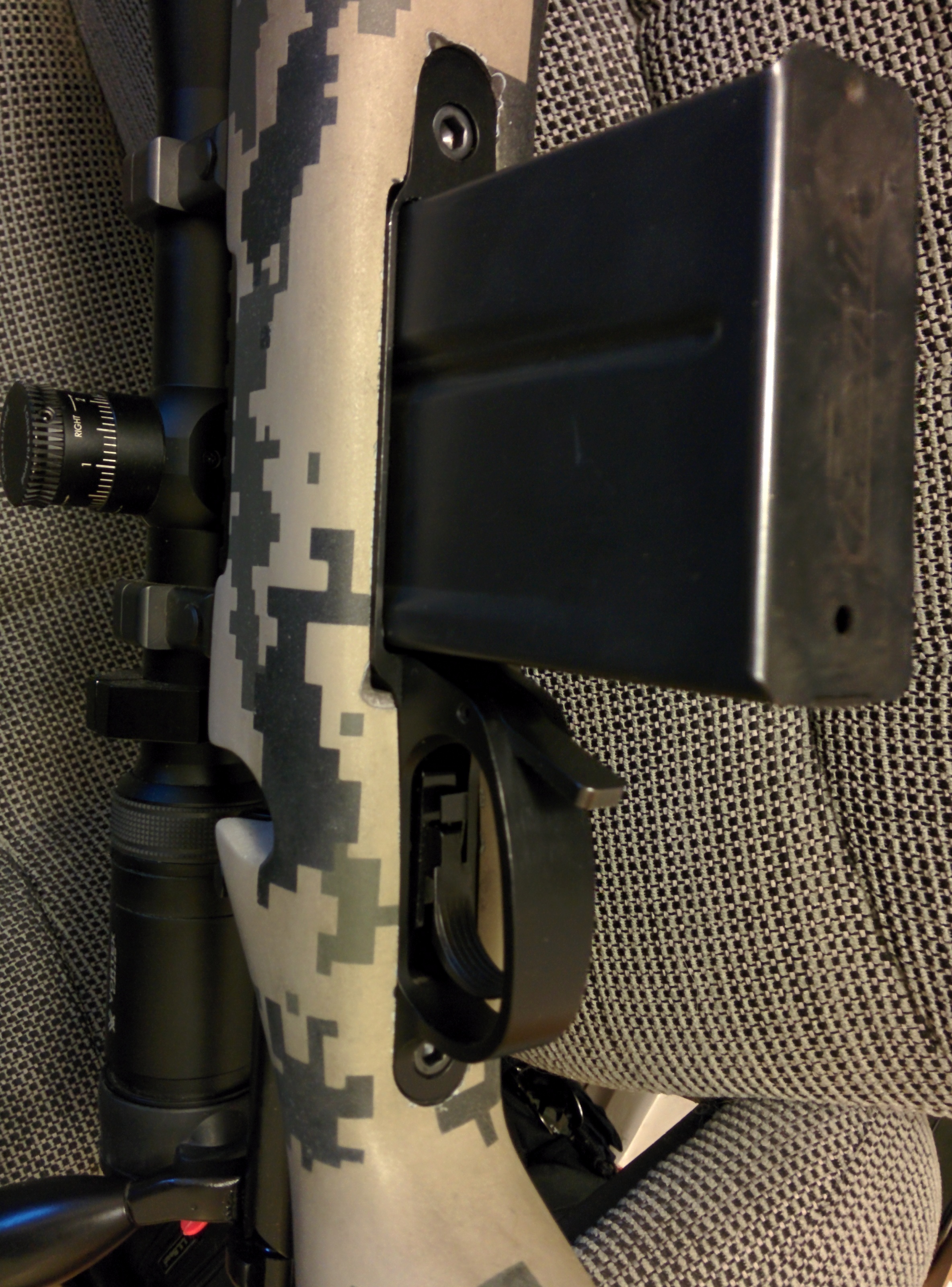

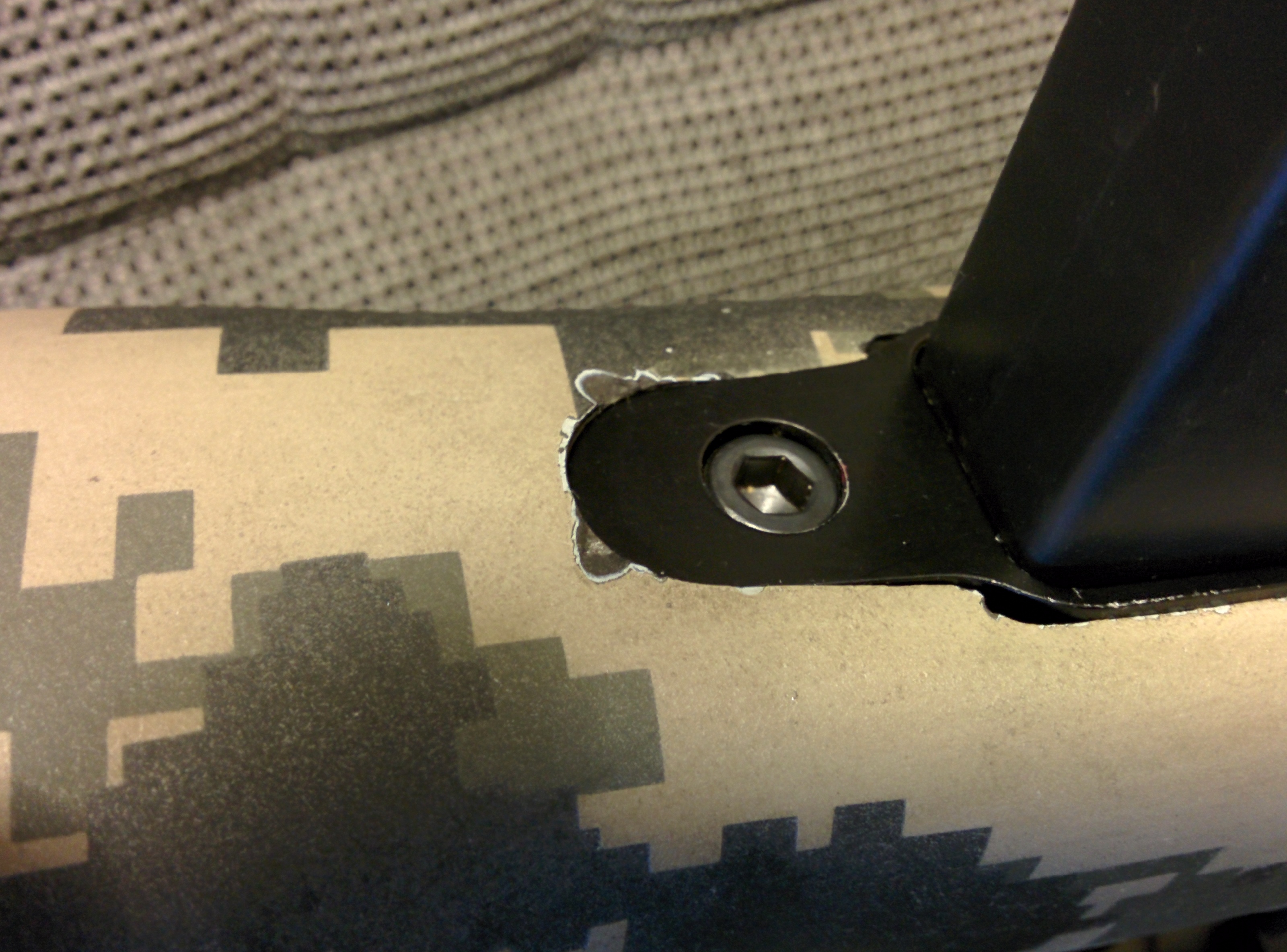

Funnily enough I finished one a couple of hours ago. It's pretty much a Badger M5 inlet. The only problem is the way the HS stocks arch upwards (or downwards with the stock sitting upside down) between the front and rear of the inlet. It leaves the step on the DBM sort of sitting up in space as the stocks aren't flat between the action screws. They are quite a nice DBM though, particularly for the price.
