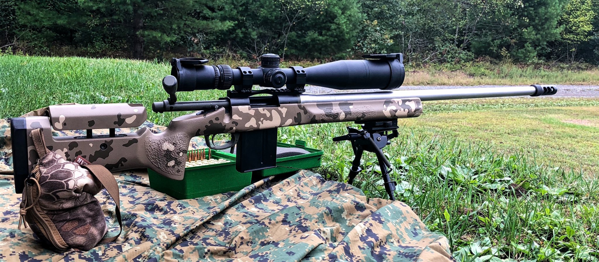

I use the bighorn invisnuts, i like them. If you can fab up a good clamping wrench you could probably skip their torque wrench.
