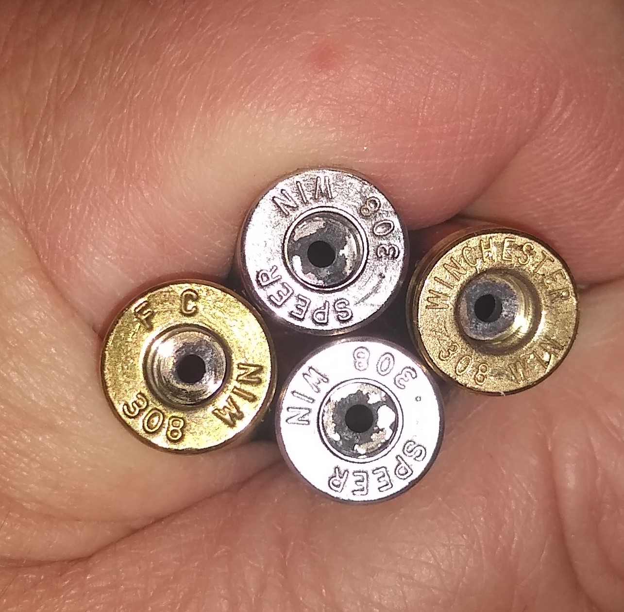

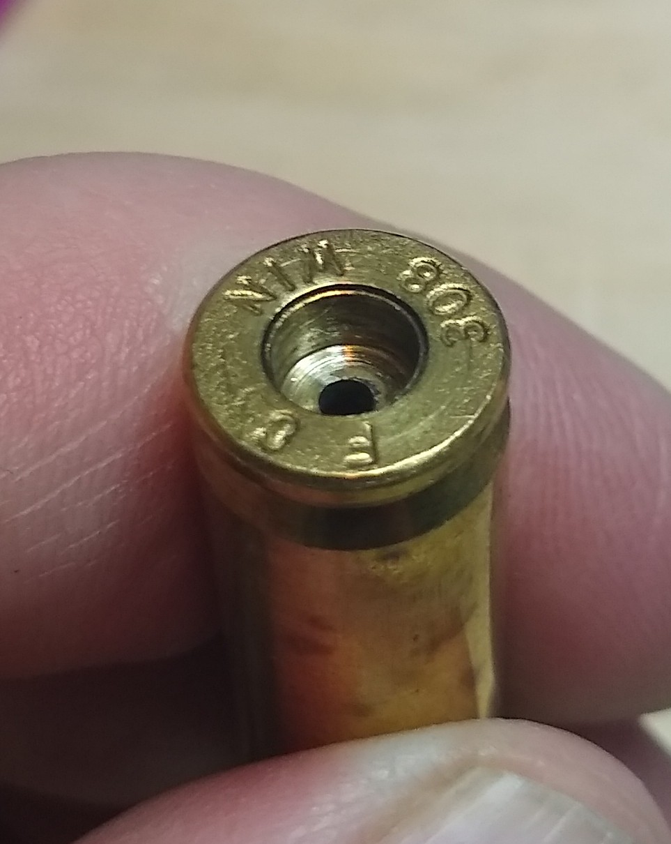

I have Speer nickel plated in 308. May I ask, were the primer pockets crimped or is that some indentation from stamping? Mine were Gold Dot and appear to have a crimping ring on them but others have told me it is too uniform for a crimp.
Also, how did you prep the primer pockets? A Winchester large rifle fits fine in mine fine using a Lee Priming arm after I run it over a Lyman reamer, uniformer, and cleaner.

A picture is worth a thousand words. It should be pretty easy to tell by looking. Or by trying to seat a primer. You could de-cap them and feel where the crimp would be with a pick. There should be a chamfer at the opening of the primer pocket not a ledge that catches the pick.

The nickel Speer brass appear to have a crimp and I contacted Speer to see what they say but haven't heard back, yet. The other pic is FGMM so what looks like a crimp can't be.

Primer pockets were crimped on the 223 brass. To prep the pockets I use a Lyman small primer pocket reamer.
The FGMM and the Speer look crimped to me. You can see where material has been stamped where there would normally be bevel to guide the primer in.
