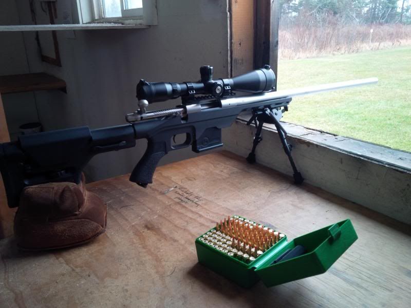

    I added the front rail on it, along with a rail mount bipod adapter because the swivel wasn't long enough to attached into the rail. Seems comfortable enough, just wish they would develop a place to put your hand on the forearm, some sort of skid plate similar to krg's for the w3. I think a 16.5" barrel would be right on this chassis, when I rebarrel it will be between 16-18" depending on caliber.
    sorry for the phone pic.
