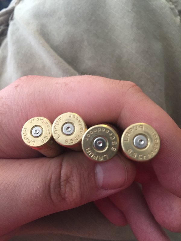

I just loaded up some charges with H4350 from 42.5 to 44grains. Using 139 scenars 20thousandths off lands, going to see where pressure signs start. Will reply back with my findings if i remember
So i did (left to right) 42.5, 43.3, 43.6, 44.
Keep in mind im using a large, factory firing pin, which is probably less than ideal for these nuclear loads on these small primers. Dont know if they loosened but i can report that later
Looks like your primer cratered worse with 42.5 than 44 grain... Any idea what happened there?
bad firing pin spring.
weakness was causing misfires and all primers to crater in a strange way, even light factory loads. the sizes and shapes just seemed to be luck of the draw.
got a newer action later on and no problems
