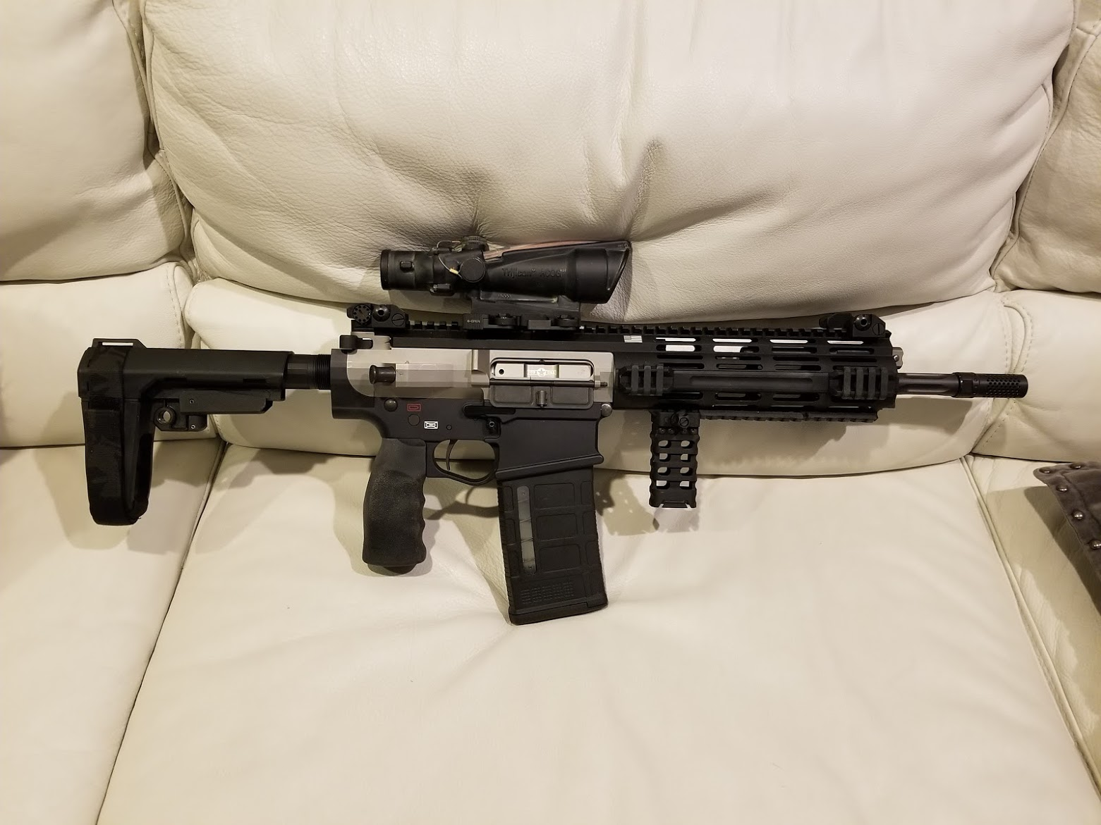

funny thing is, spend long enough accumulating parts and in the meantime pieced together this OG P308 that I like better than the 308s I was going to build. well, still have the other calibers to build once I secure this receiver extension :D
