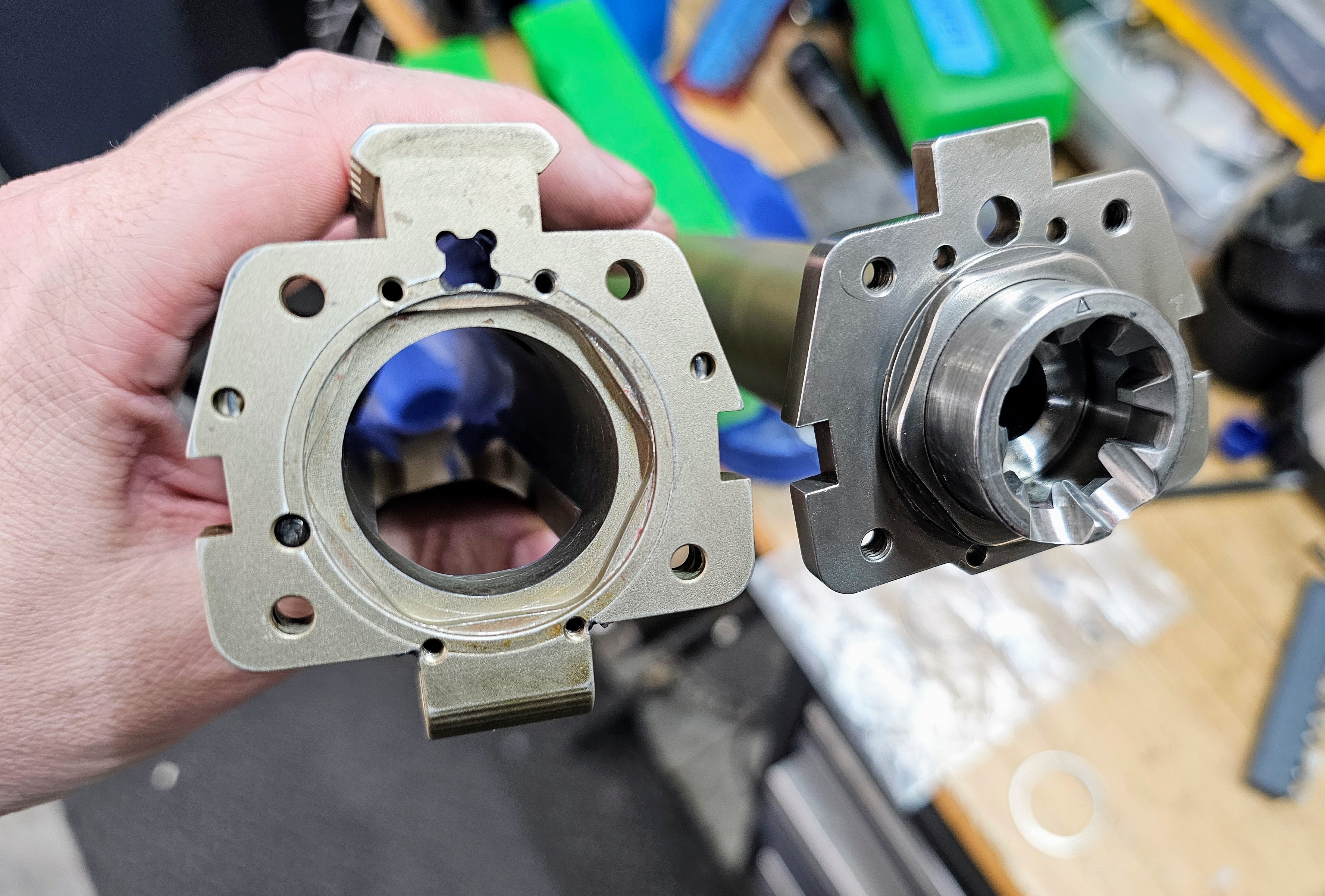

One thing I’m not sure I saw covered, but noticed in disassembly is the receiver extension is 1/2” longer than KAC or LMT. The longer stroke probably contributes to the softer recoil impulse.
img_3476-jpeg.8739590
longer buffer tube is necessary due to MRGG using the AR-15-length H2 buffer (3.25"), instead of the shorty AR-308 buffer (2.5"). if so, stroke length is the same.
my guess.
it's interesting that instead of going with the H3 5.5oz buffer, G put the weight into the tail end of the bolt carrier. I wonder how much weight, how much heavier is the MRGG bolt carrier in comparison to a run-of-the-mill AR-308 bolt carrier. I'm guessing it's more than a couple of ounces. That probably has more effect on the felt recoil, that, and the proper gas tuning, looks like a short dwell time, gas-port to muzzle, also.
I guess with that weight in the carrier, you can't just drop the firing pin down the tube any more when reassembling your BCG, it goes in via the hammer opening. no biggie.
my guess.
The buffer is AR-15 size like KAC and LMT, and the BCG matches OAL dimension with them. FWIW KAC also uses H2 buffer on their SR25 rifles. I really do think the stroke is longer unless there’s a weight in the receiver extension.
The carrier weighs 22.1oz vs 18.9 for KAC 6.5CM BCG. The firing pin does insert via the hammer opening, the manual covers it. There is no firing pin spring unlike KAC and LMT. Not fond of those couple things with the BCG nor the ejector positioning on the bolt face.
The gas system length is a fair bit longer than KAC as well. At least two inches for the journal position plus the additional length from the phased array ports.

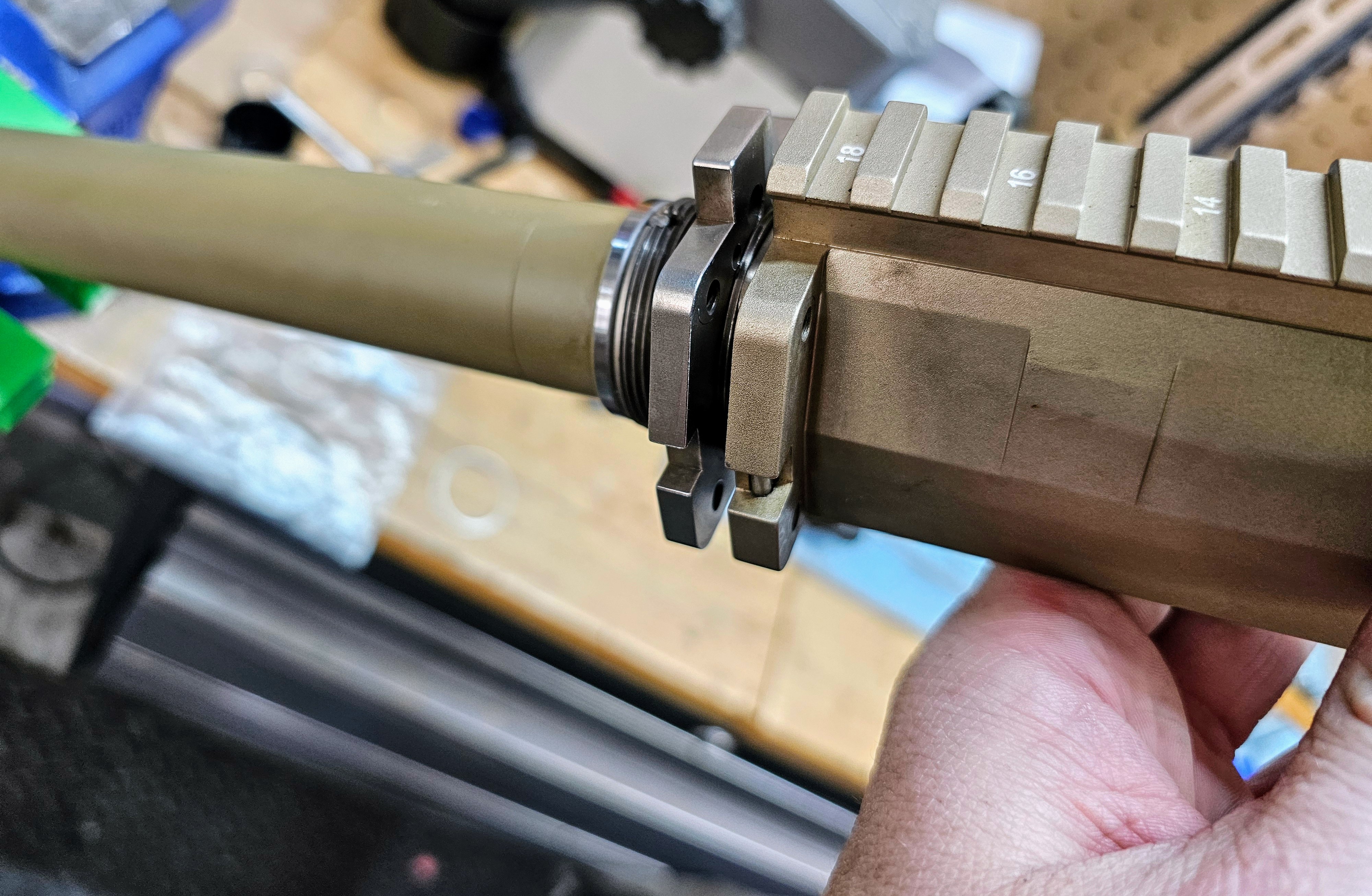

img_3496-jpeg.8740413
also curious about size of the gas block. seems to be larger than 0.750" diameter GB journal, is it a 0.875" or 0.936" gas block. It's also interesting that G didn't pin the gas block, like they did with the URGI, especially with this also being a military contract rifle. Just an observation, nothing more.
is the barrel nut steel? or aluminum? looks like steel. just asking because on the URGI it's aluminum.

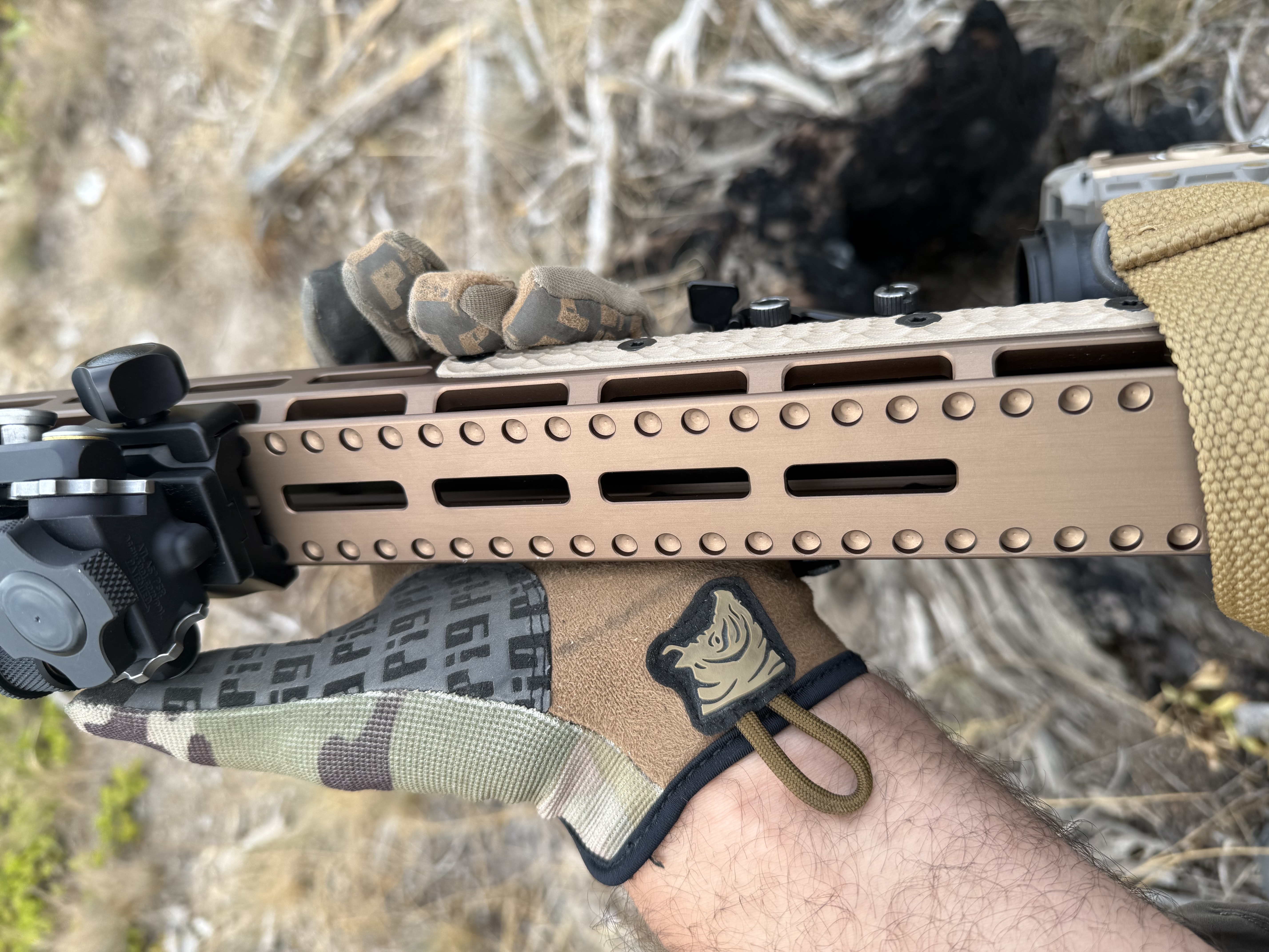

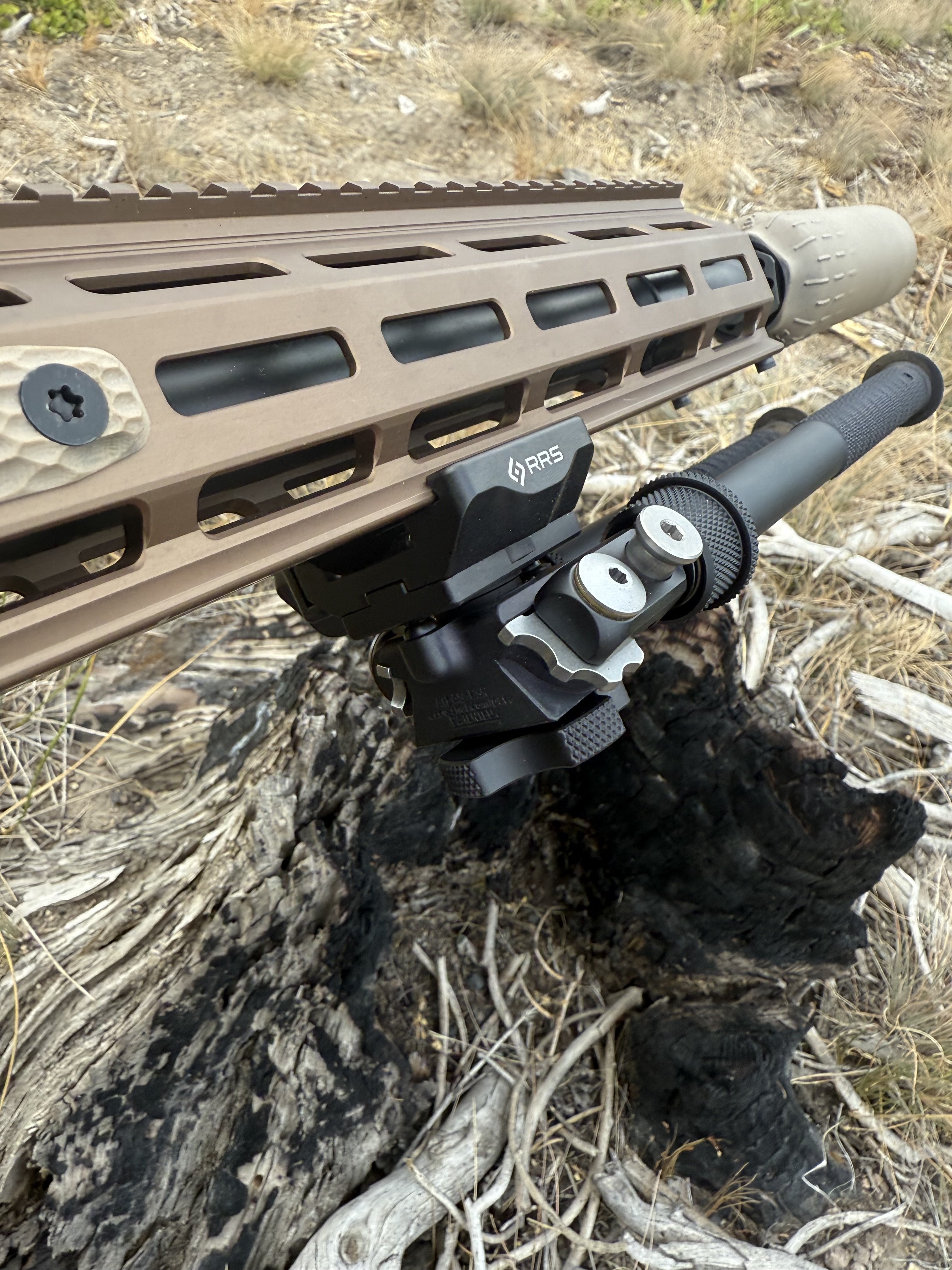

Gloves are recommended if carrying outside of prone or tripod use. It’s not terrible, but the Arca rail isn’t made for human hands.
Attaching bipods and tripods wherever you want, quickly, securely, and easily is nice. I’m not sure why the same thing couldn’t be accomplished with picatinny, but I’m familiar with Arca and don’t mind.

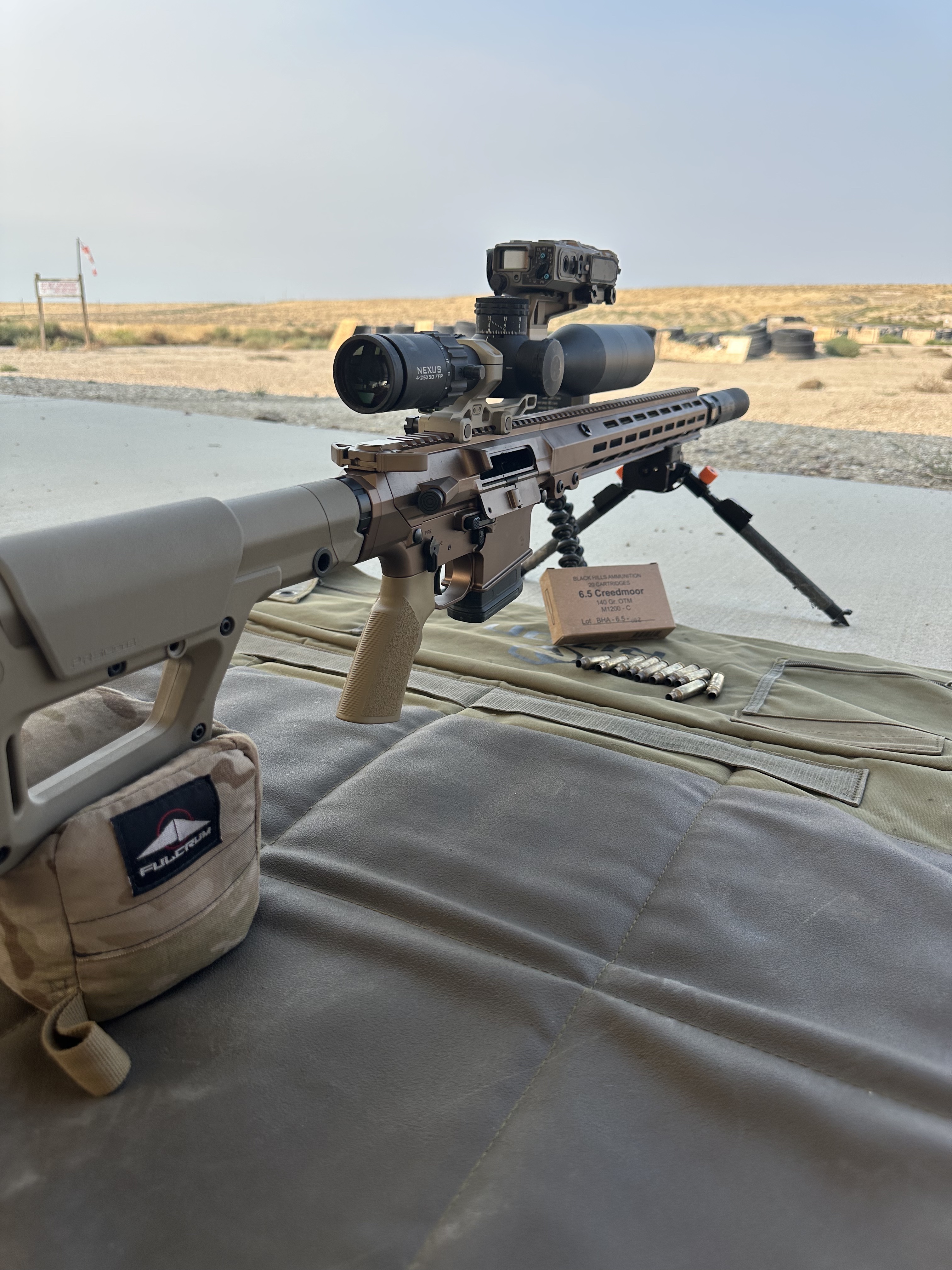

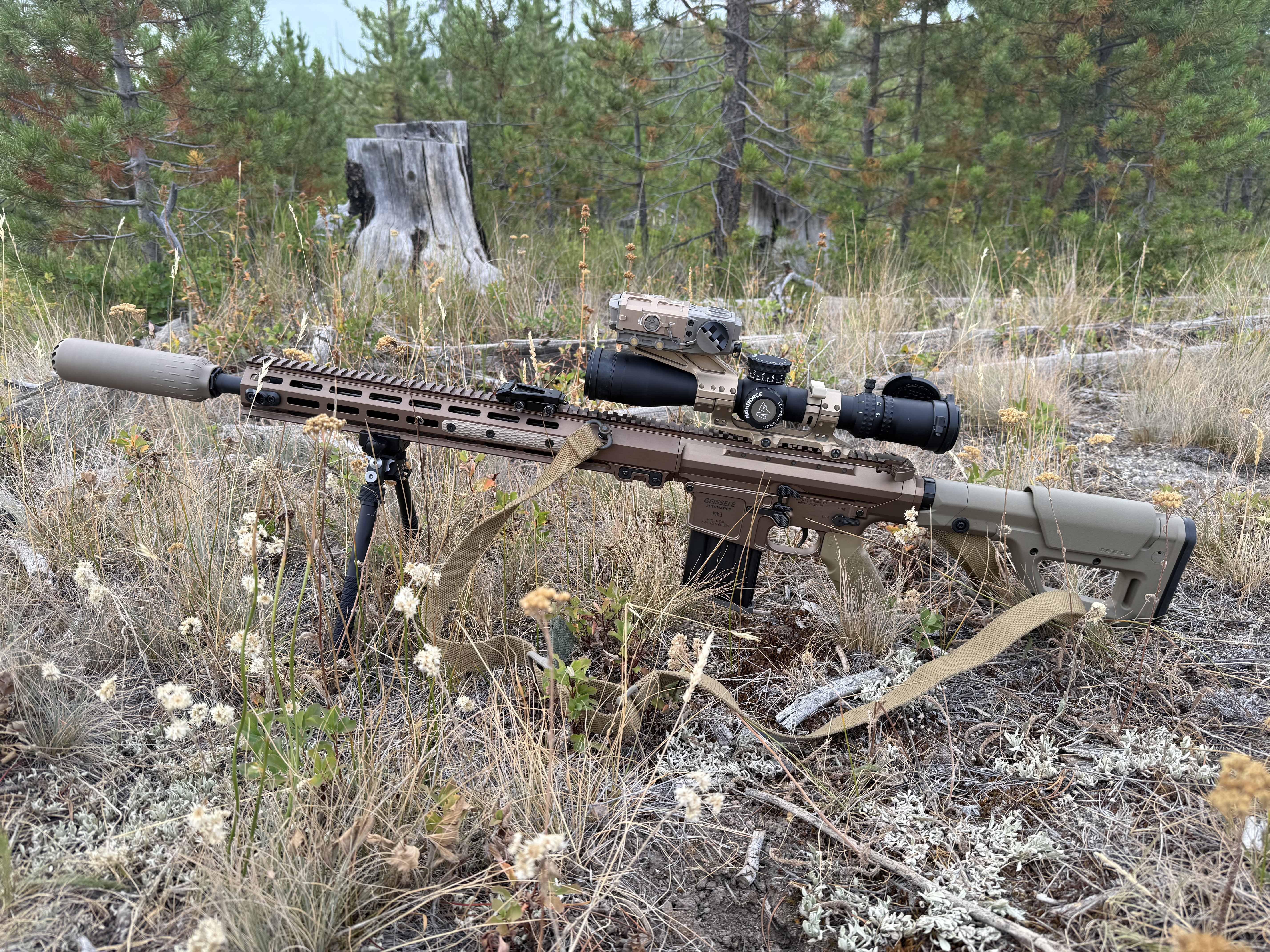

I found just the right environment for the fifty shades of FDE (100 miles north of Boise).

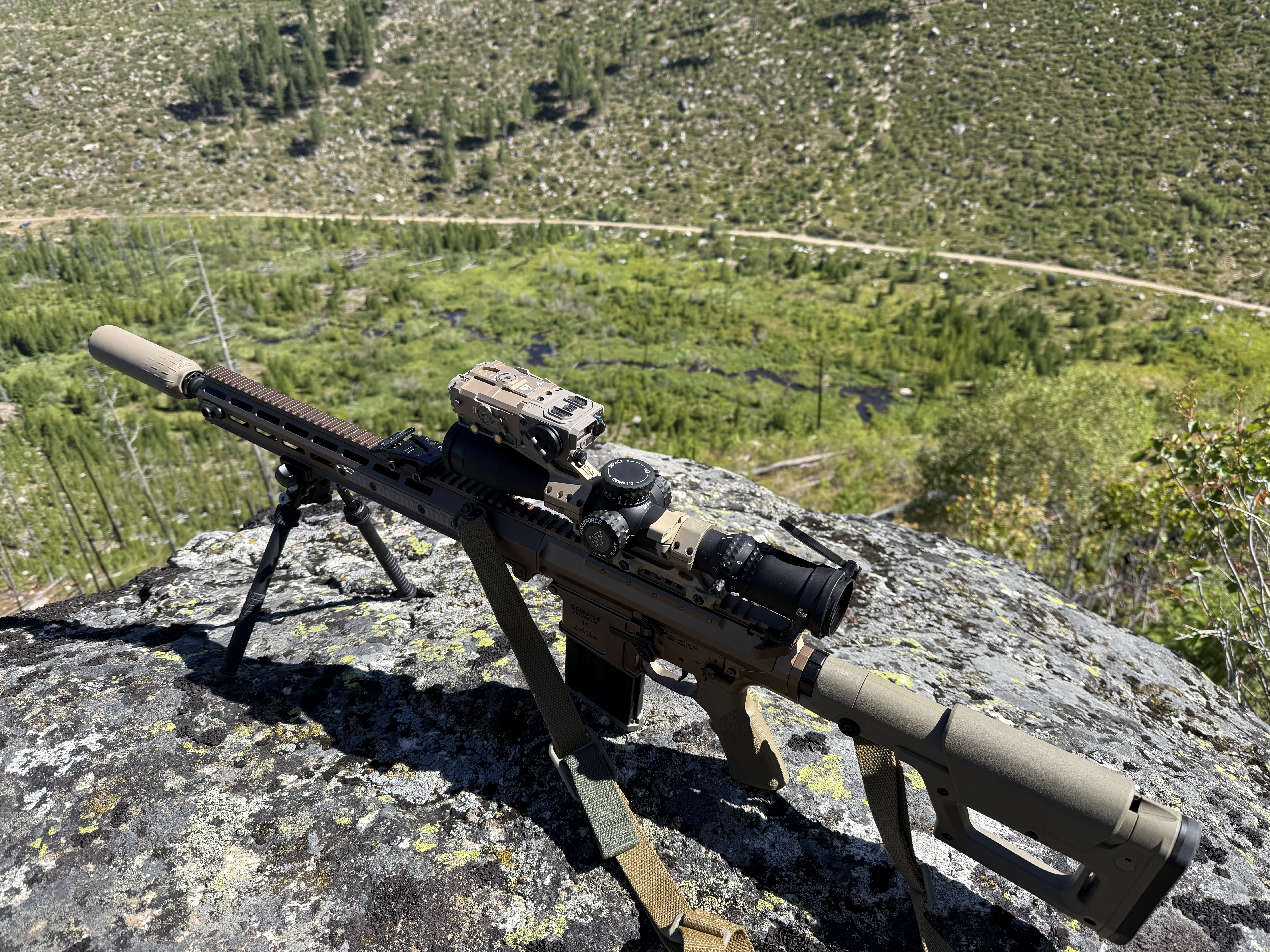

This is my road now. Maztech is sweet.

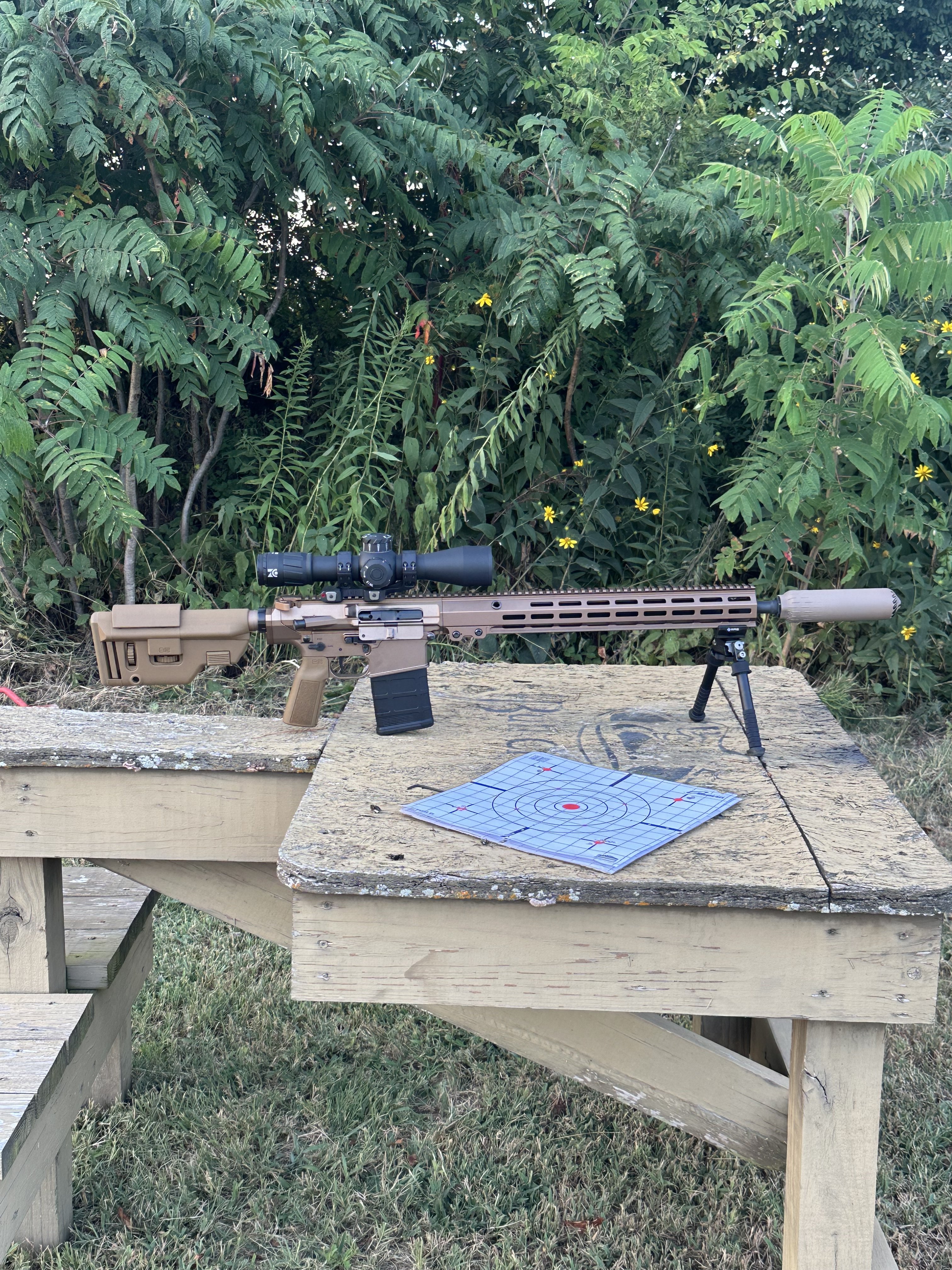

So. Bought a hux 762 ti flow and it was recently approved. Knew I wanted to shoot some groups with same lot of the 140 hornadys I used earlier. I absolutely shoot better with a suppresor on all firearms.
First things I want to say is I can’t believe how the can changed the recoil impulse. It’s the softest large frame by far I’ve fired. It was really soft before but this took it next level. It reminds me of a over gassed 556.
Changed the Magpul out for a b5 stock and grip which I highly prefer.
I continue to love this gun and really want a 14.5 or 16 inch version.

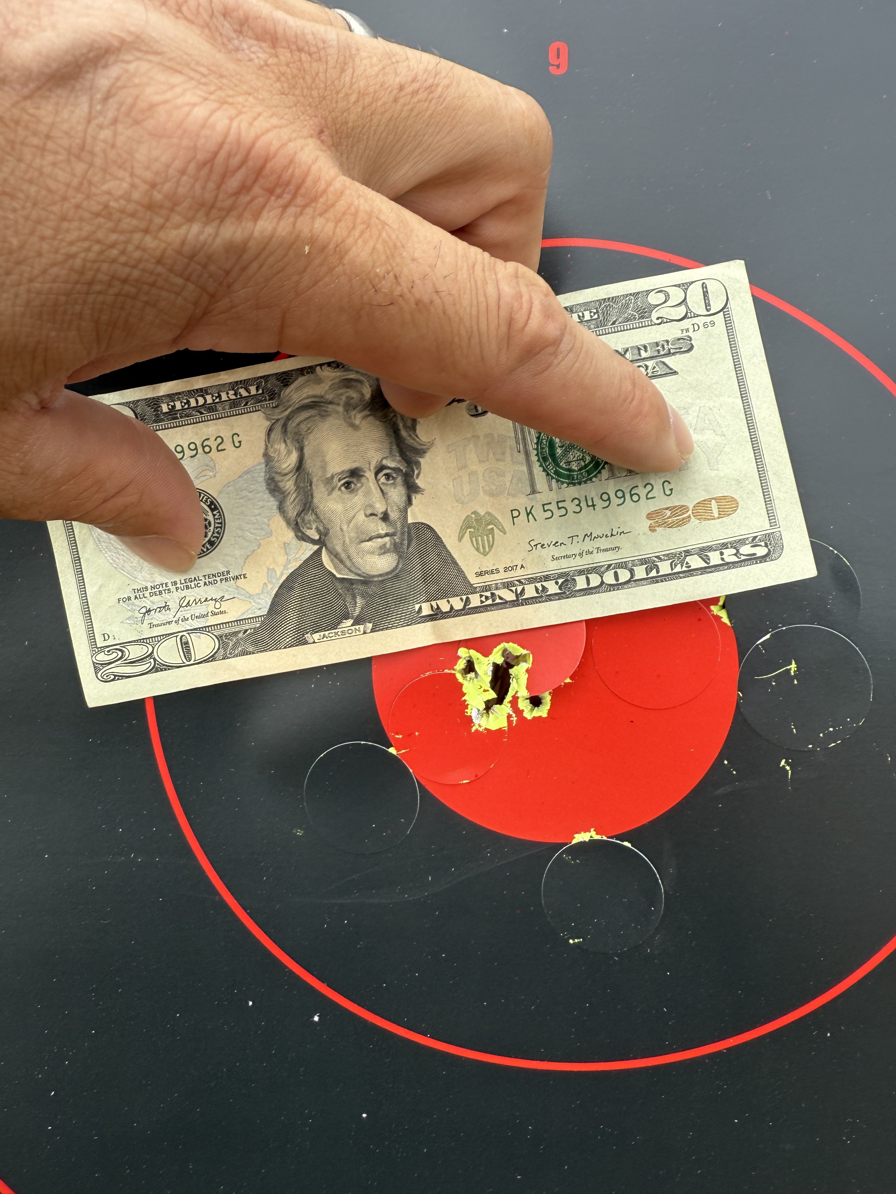

Good lord, a quarter moa group from a chrome lined barrel is superb. Nice shooting!
Sub 3/4” average there which is still a good rifle. I have to switch to a 6mm bolt gun to shoot consistent 1/4” groups.
Im not calling it a 1'/4" moa rifle or anything like that. There's probably not too many gas guns that can hold that kind of precision repeatedly. Just commenting on that bottom left group when the stars all align.

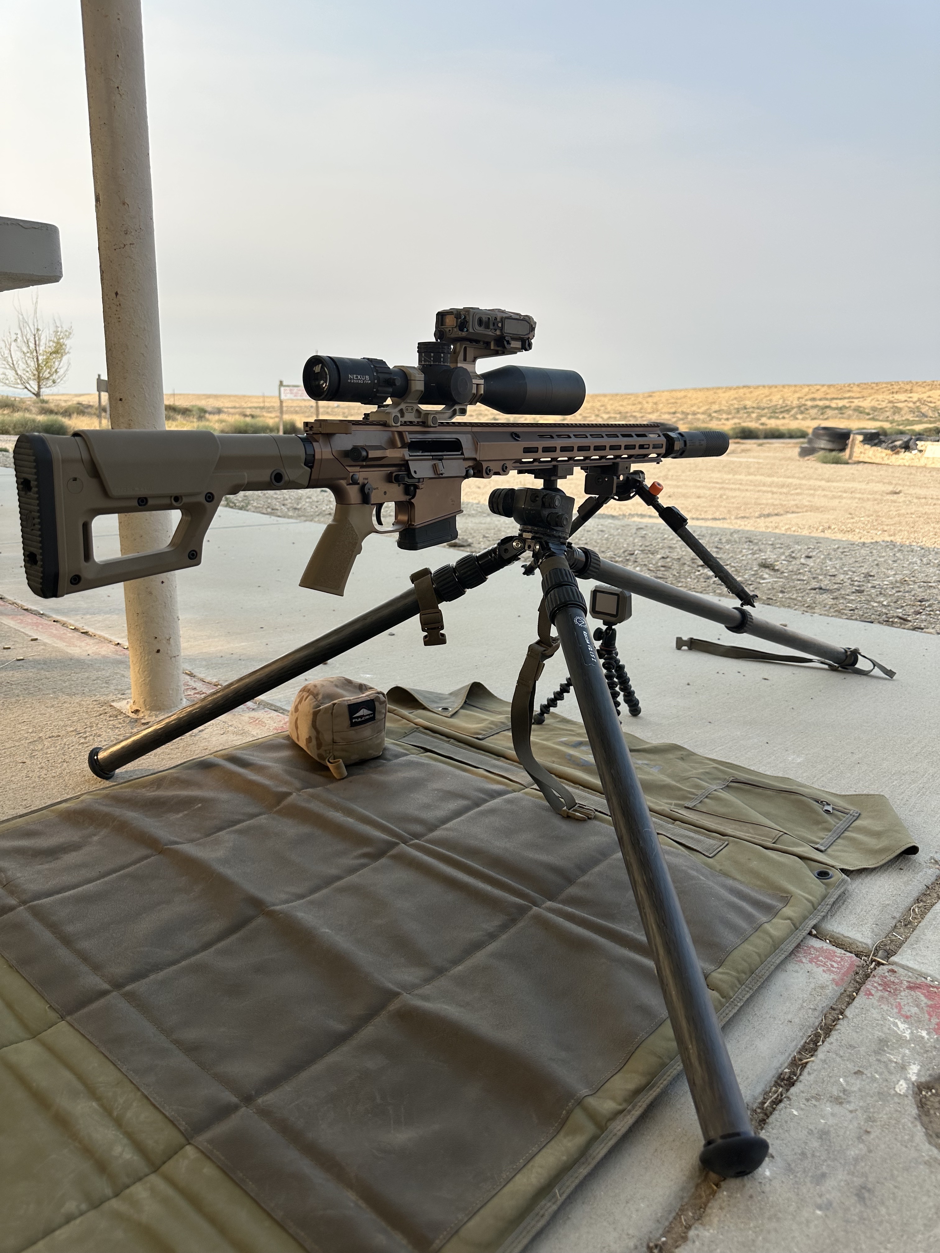

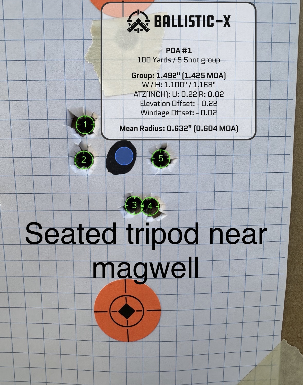

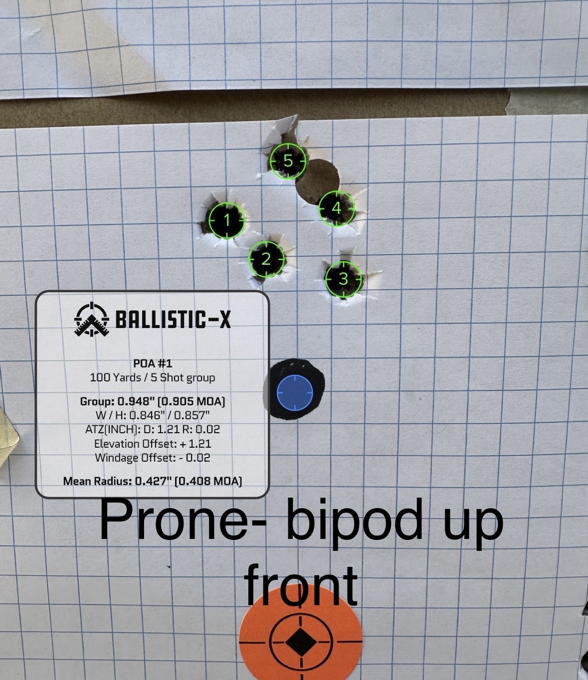

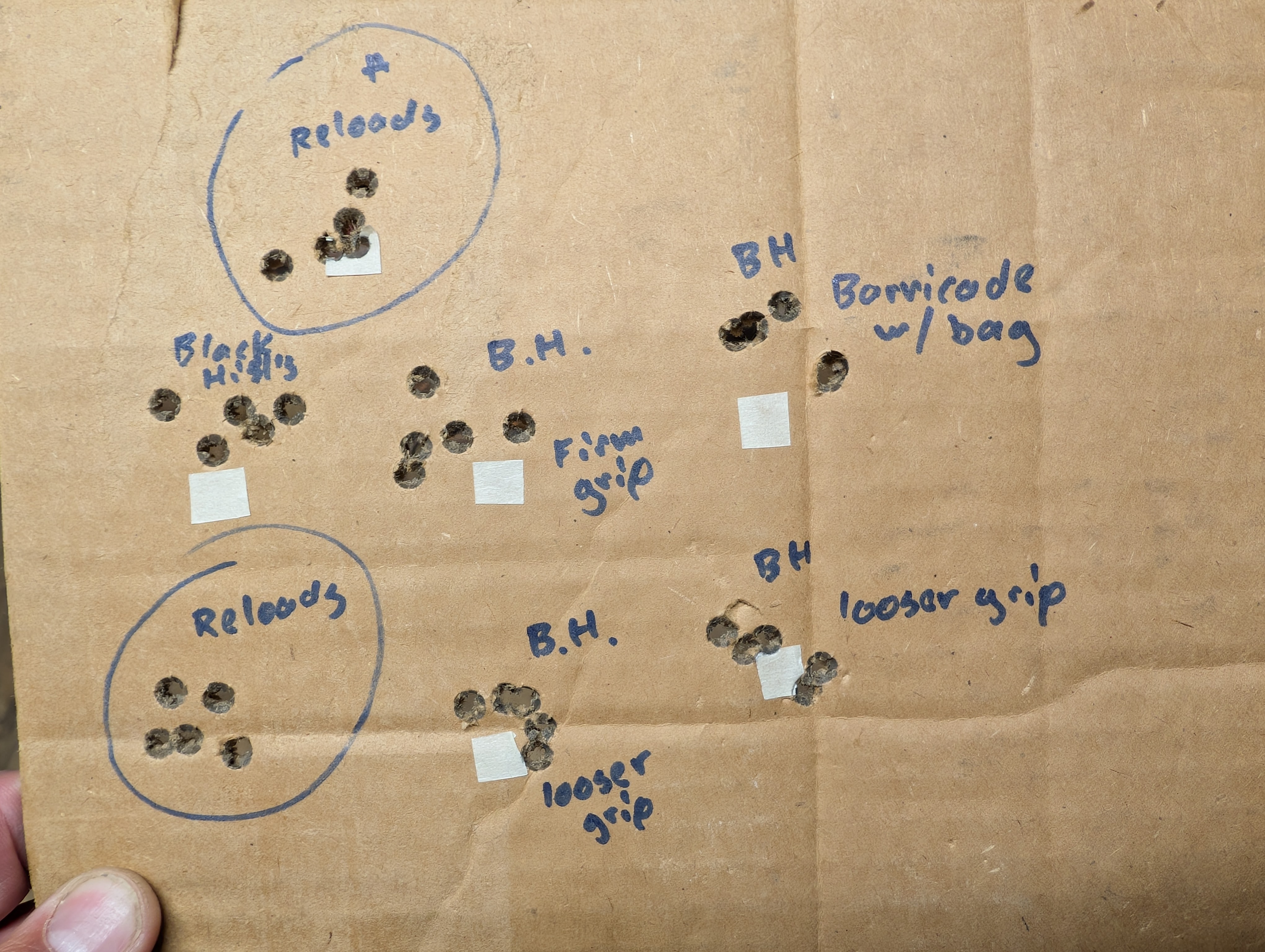

I've been getting a lot of questions about POI shift on the MRGG so I decided to go out and test tonight. Here are my results from the 100 yard line.... as you can see my POI shifts down about .4 mils (1.4" at 100 yds) when moving from prone off the bipod (mounted forward on the rail) to seated off the tripod (mounted rear/ center on the rail).

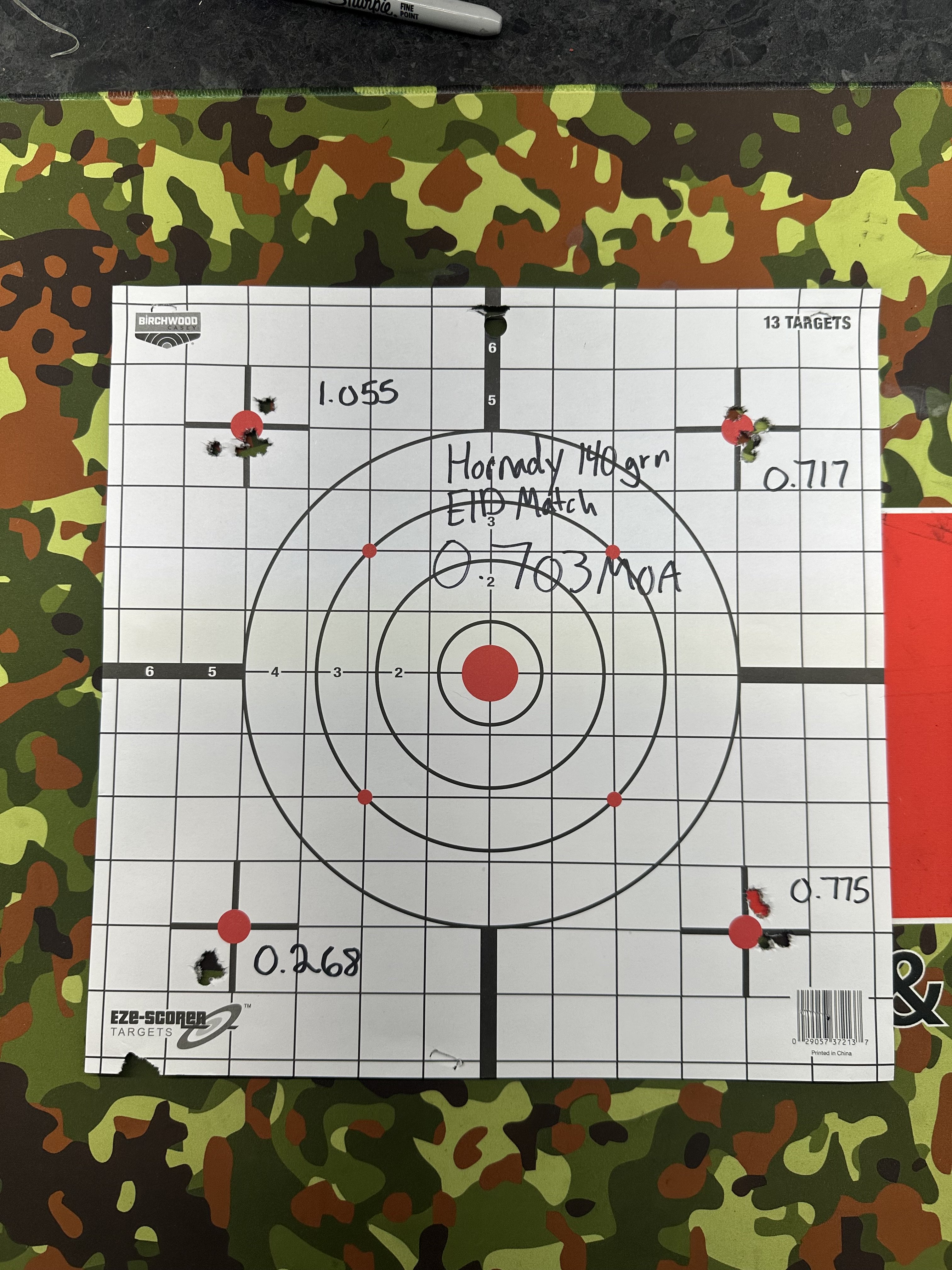

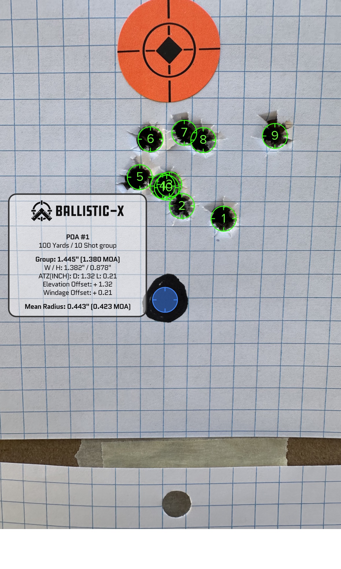

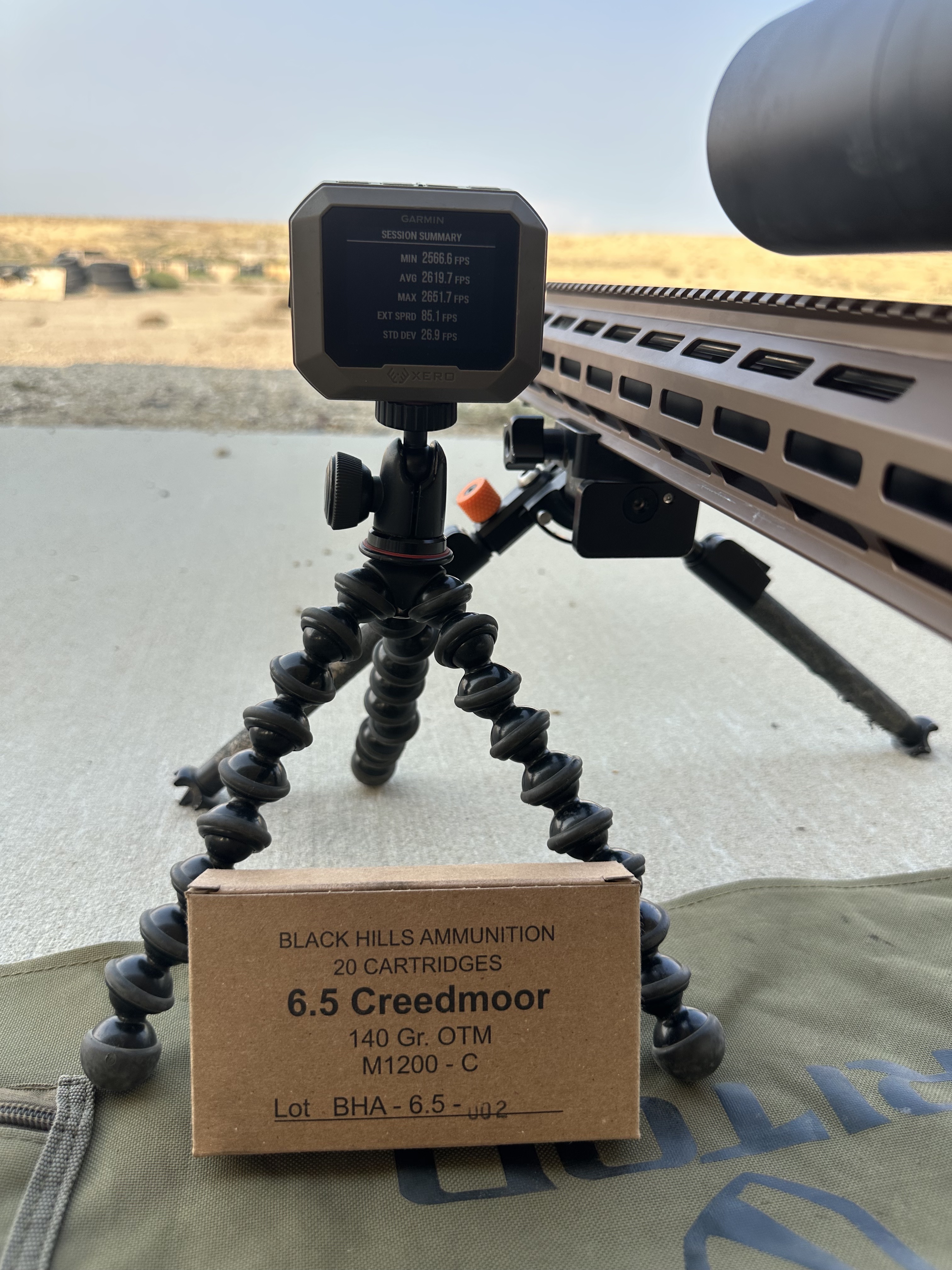

And for those that are curious, here is the performance of the black hills M1200C load out of my rifle. 10 rounds at 100 yards
View attachment 8757008View attachment 8757009
I was genuinely curious how that load would shoot. I read that it is h4350 with a Berger 140 hybrid, COL of 2.815" I believe.
I handload and have tested several loads quite a bit for my LMT 6.5 20" SS barrel. I get similar performance with the same handload. Certainly decent, but not outstanding.
I've had much better luck with the Berger 130 grain Hybrid bullet and H4350. It is consistently between .7 and 1.1 at 100 with 10 round groups, and 2,750 FPS. I know it is a lower bc, but I get significantly higher velocity. I'm surprised the military did not go with that bullet as Bryan Litz explained in an article that Berger developed that bullet specifically for AR10 use loaded shorter than 2.82".

I'm really surprised that the contract didn't specify shift from positional shooting. Seems like a fairly big issue. One more thing to keep track of in the heat of the moment.
It's COL is 2.770'ish IIRC. I've never bothered to pull any but I've shot it out of three guns and it's faster than 40gr of H4350. Here's how it groups from a Seekins SP10 with an aftermarket barrel
How many Mils does the reticle move off-TGT from bipod prone/rear bag supported, vs tripod?
Looked pretty minimal in Mountains/Mullets/Murica’s video.
I'll try to get a number for you next time I take it out, but it's extremely easy to spot misses even at relatively close range. For sure the lightest recoiling large frame I've ever shot. Probably comparable to a standard 6.5 Grendel tbh.
