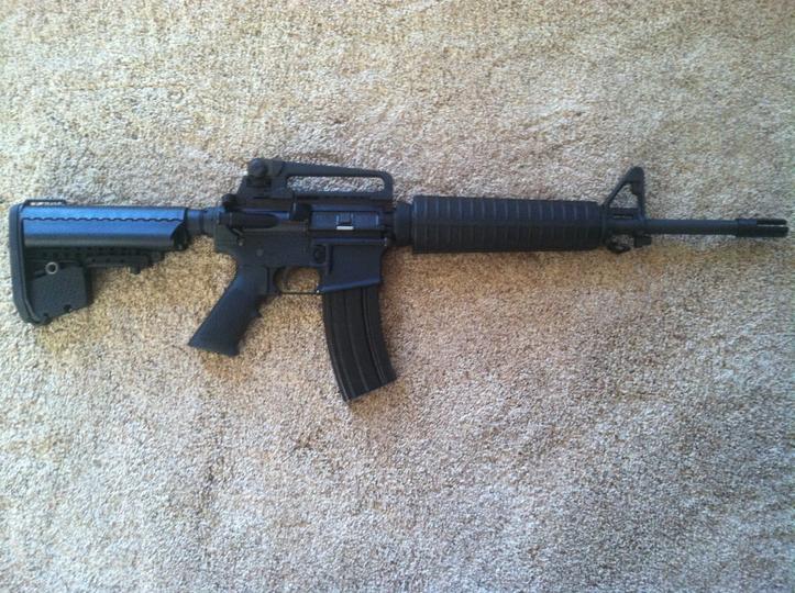

I have decided that I want to buy a suppressor. The question is if my current setup can be suppressed or if I have to build a whole new upper. This is my current rifle with Vltor A5 installed Noveske RifleWorks, LLC.

You won't know until you run it with a can. It might run fine with your current setup but I would do a adjustable gas block and tune it to your load

I am going to order the JP adjustable gas block and AAC M4-2000 and run it as you suggested. Is there anything I should keep in mind? Any type of ammunition in specific 55,62,77 gr?
Lazy21 is right. Who knows what will happen with your rifle until you try it.
If you have the Vltor A5 system on your rifle already, A LOT of folks have had good luck with changing to the heavier buffers. There's a ton of info on m4c about it.

Yes I am familiar with the syrac block, I believe JP makes blocks for them or vice versa. I'm going to order the front sight post and get everything together, will post results. Thanks for the feedback if you guys come up with ideas please let me know I'm always open to suggestions.
