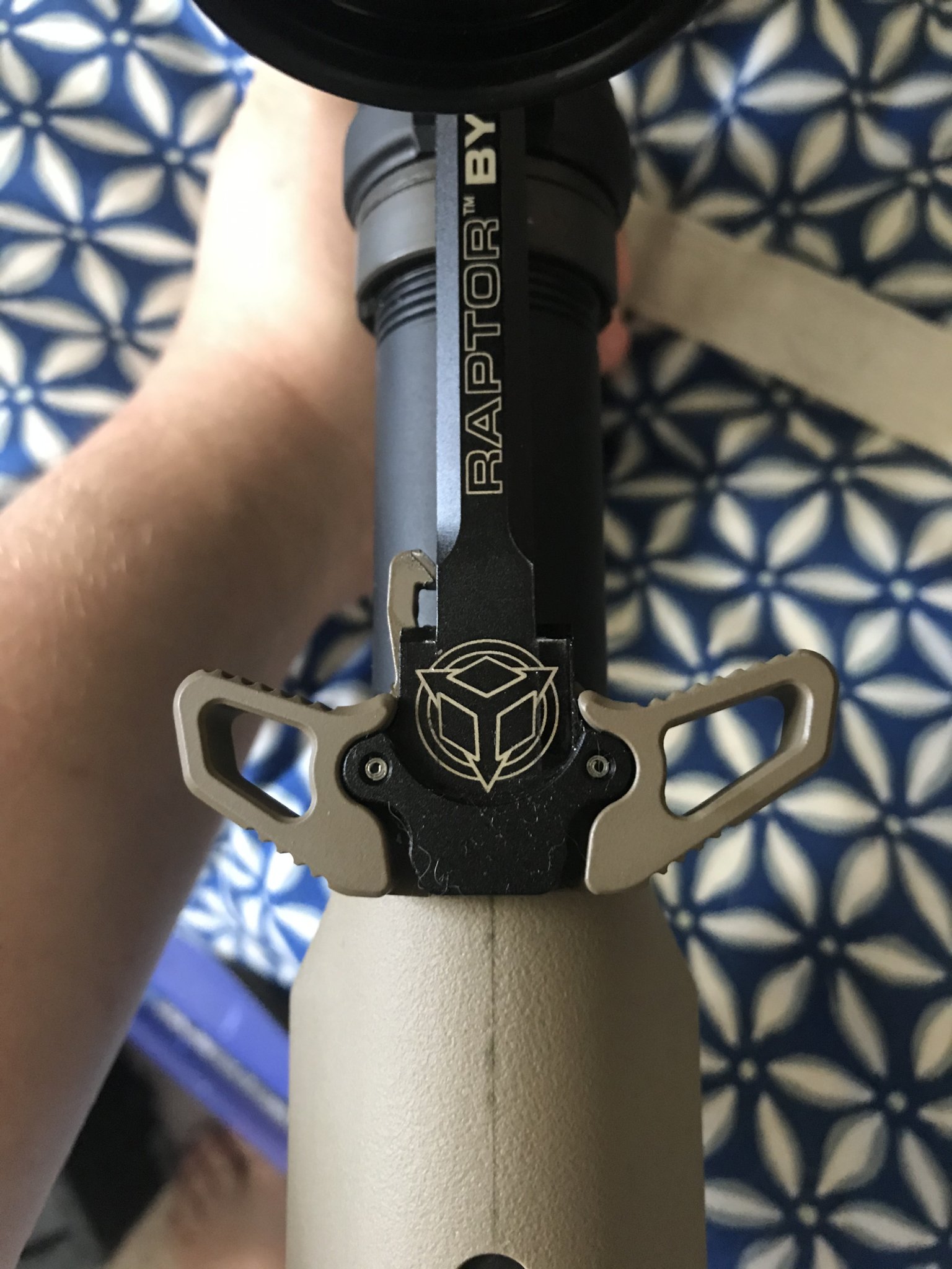

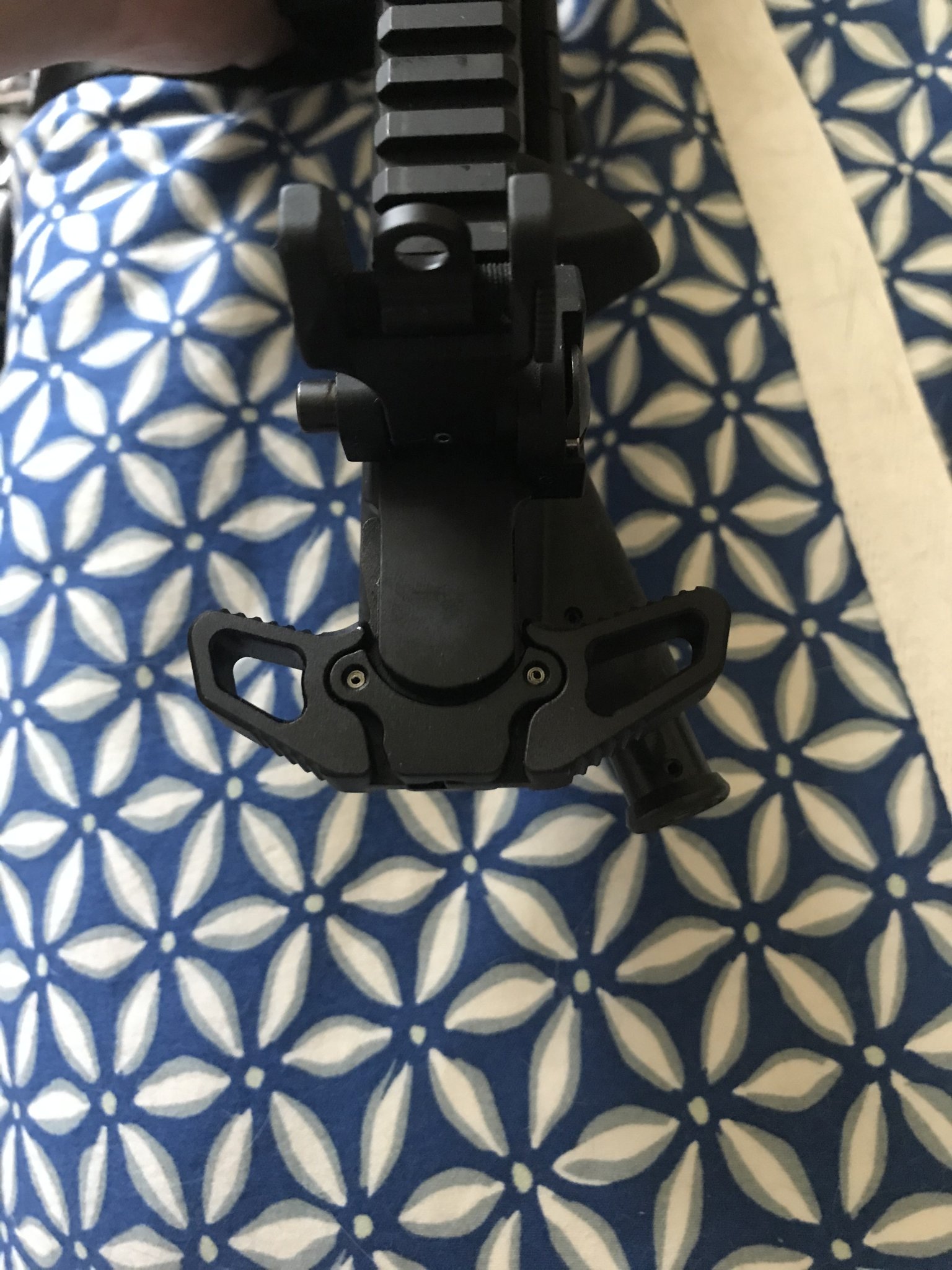

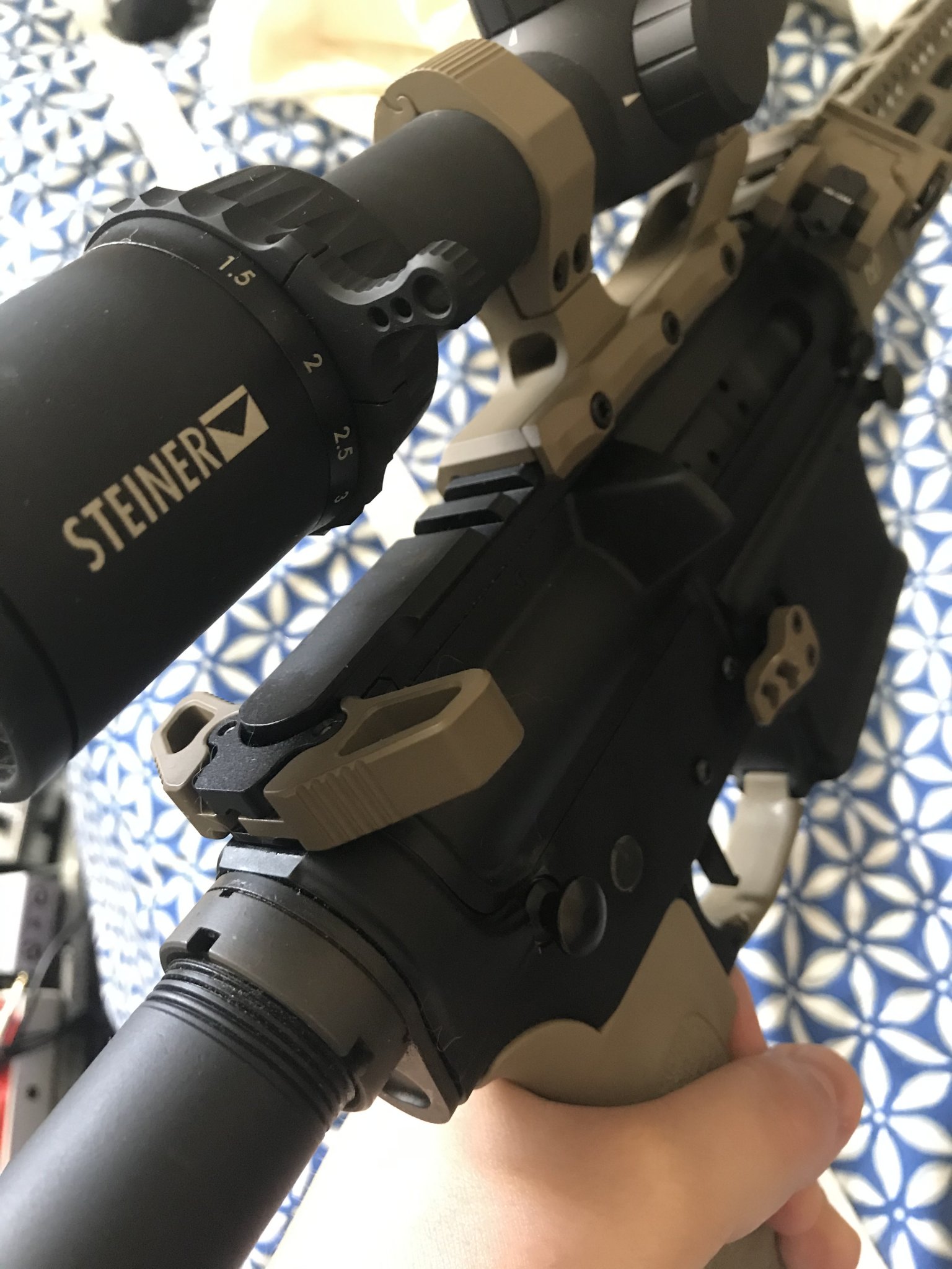

I also often strong side charge and I love the Raptors for that — most of my rifles are slick side uppers without a forward assist and the Raptor is slightly extended on that side to stick out past the FA, which just makes it even easier for me.
Raptor showing the strong side extended a bit compared to the weak side:
How much grasping room that gives you on a slick side upper:
And here’s an overhead of one on a standard upper showing how much it overhangs the FA (it’s not much, but more than most):

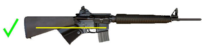

hlee, it's not a requirement of F class per se, but rather a bit of a compromise i've noted when using grips such as these (photo copied from the internet, the yellow line demarcates allowable position for thumb/web placement):
