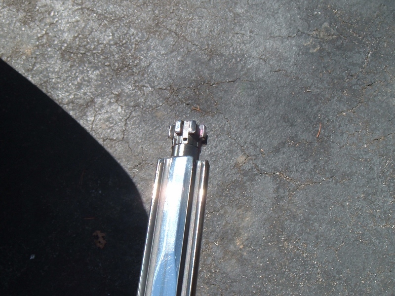

I bought a Joe Bob Outfitters Premium Complete Bolt Carrier Group (AR15/M16 BCG) a while back for my 300 BLK build. When I got the build completed and finally got to shoot it, I was getting stove pipes after every trigger pull. I was told that the coating on the BCG was probably causing bolt drag, and to oil it wet when I shot it, and try to work it out. I did, and it would improve a bit, but the problem came back after just 2-3 shots, so I took it off, and decided to try and polish the bottom of the BCG a bit to see if it would clear it up. After a bit of polishing, this is what I found. Do you think these machine marks could be the problem causing the bolt drag?

It definitely looks bad, but personally I don't think those marks will cause your "bolt drag" as long as you had some oil on that surface. Def not "premium" though.

That said, if I'd have paid "premium" money for a "premium" BCG and the machine marks looked like that, somebody better be stepping up to offer me a suitable replacement or a refund or problems will ensue.
However, I'm not sure that carrier drag, or even that rough looking carrier, is necessarily the culprit in your case. First off, since there's always some "confusion" about what a "stovepipe" (or stove pipe, etc.) is, what specifically do you mean? Got any pics of the jams in question?
What gas system are you running? Adjustable block? Buffer/spring weight, etc.? Does the bolt lock back with a single round chambered/fired? What FCG are you running? Aside from the carrier, is the rest of your rifle being run wet? Just a few questions or so before we go off blaming JUST the carrier for your issues. So many places to go with a repeated jam its always tough to tell you where to start looking/adjusting.
Not so sure either the machine marks is the problem but definitely get it replaced with one of higher quality.
No excuse for that kind of quality control.

No doubts that the carrier looks awful, is unacceptable from a QC-standpoint, and could easily be contributing to the OP's function woes with this particular rifle. HOWEVER, you didn't start by criticizing the part in question, but rather by attacking the business itself who sold it to the OP for what you deem to be a poor choice of names for the business (no need to repeat the exact words which are pretty pathetic and wholly unwarranted). Then you admitted you have zero experience with the company and had never even heard of them before your post. That, sir...IS IGNORANT...insofar as the attack on the company itself is concerned!
I assure you, JoeBobs did NOT make the part, but merely sold it, as is the case with MANY "re-branded" AR parts across the industry. Any number of highly reputable companies, even some with names you may not find so offensive to your delicate sensibilities, can have bad days with sending out sub-standard parts with their name on them that didn't get caught in the QC process (even BCM whom you recommended to the OP as a suitable replacement for a BCG has put out more than a few lemons in their time, including but not limited to their barrels). However, like any reputable business, they step up and take care of their customers, handling mistakes as they damn well should, which is why I, and many others, continue to do business with them to this day.
Nobody would have said anything about an open criticism of the part in question which is clearly not up to par, but instead, you attacked the business who sold it. Having dealt with JoeBobs on countless occasions in the past, receiving nothing but the highest levels of communication and service from them, I would almost guarantee that this issue will be made right for the OP. If they don't make it right, whether by refund, credit or replacement of the part in question, then you may have reason to launch an all out attack, even if it is based on some deep and illogical hatred of their name alone which so offends you! ;) But until then, let's keep focus on the part and how the company in question will deal with this issue and not go full "retard" (your parlance...not mine) on the company who merely sold it.

I'd say you got a dud, mine polished up beautifully.

The portion of the bolt carrier that is effed up only bears against the spring-loaded hammer and the top round in the magazine. Since it appears to have been "smoothed out" a bit and the sharp edges removed from the machine marks, it would actually provide less bearing surface against these parts and should actually work better with a little lube on this surface. A completely flat surface would have more bearing area touching the hammer and provide more resistance. This is the reason I said it probably was not causing the OP's problem. BUT if this surface is in such bad shape, who knows if any of the rest of the carrier is to spec?
JoeBob is GTG, talked with Joseph today, and he thinks it's likely just a bad/weak ejector spring, but agrees also that the BCG should've never made it past QC. My replacement bolt has already been shipped out, and should be here by the end of the week.

While it's unlikely those grooves in the bcg caused significant resistance, they may add more if they grab the rim on a round or the lip on the hammer, but not enough to slow it down that much. Double check your gas block alignment and make sure it's secure. I thought mine was til it shot itself loose. If neither that nor the new bcg/ejector spring fixes it try a heavier buffer as suggested. If it isn't resolved try barfcom. They may troll hard but you'll get the best knowledge for 300 BO.
