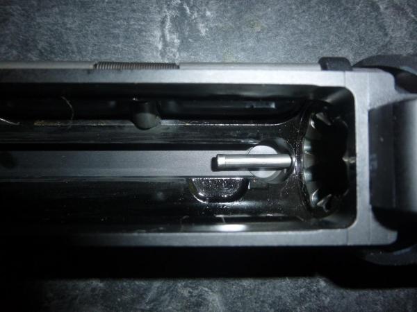

While your waiting for those gauges to arrive you can use your number drill set , by hand, to find the aprox diameter of your gass port hole.
Take a look at the gas tube, only takes a minute. It should end half way of the cam pin cutout in the upper receiver. If it doesn't end halfway of the cutout then it's too short or too long. Too short will cause the gun to be undergassed even with the proper size gas port. see attached pic for clarification.
