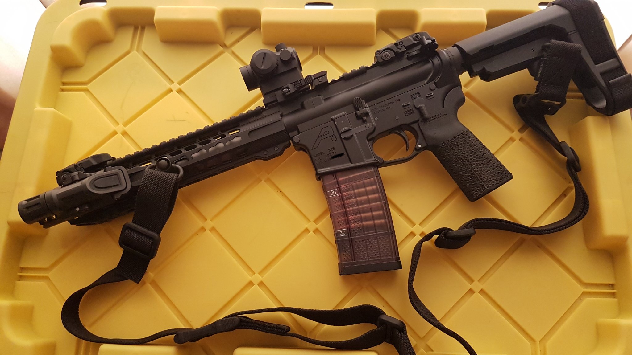

Update! Tomorrow, the 12th marks my 7th week of what I hope is an 8 week back order of my Seekins CQ PDW (black). Looking forward to it.

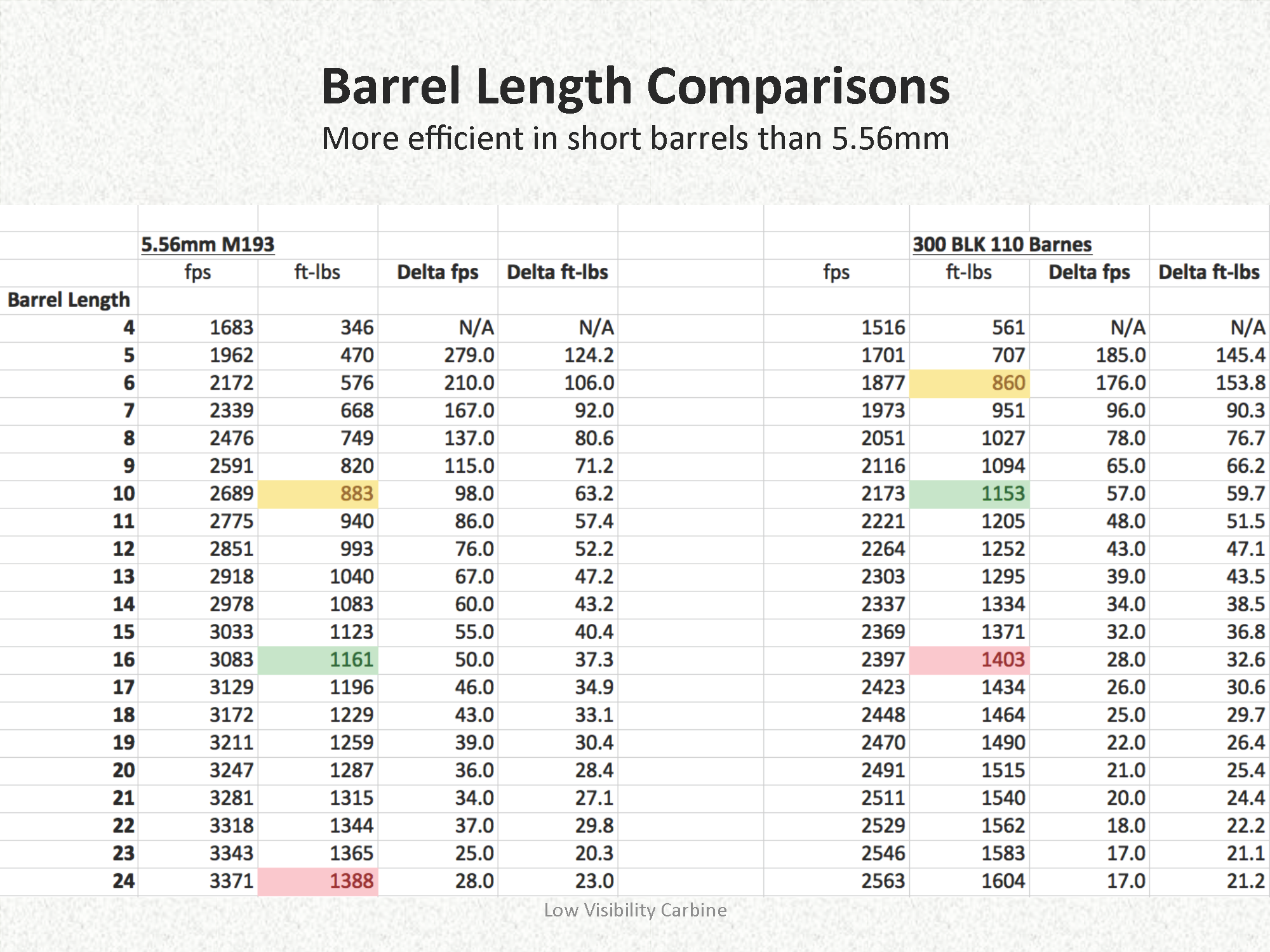

....IMHO, "truck guns" imply something short & portable and quick to deploy. If one was carrying it around in your vehicle and you find yourself in a "SHTF" scenario, the engagement distances are going to be <100yds as one tries to escape the confines of the looming "SHTF". Padom's test results are very convincing for going with .300BLK over 5.56 in a 10" or less barrel configuration, as also shown in AAC's test data for supersonic ammo. The .300BLK will also have better "barrier blind" capability in the type of scenario described above. The cost of factory .300BLK isn't that much more than .223/5.56, especially in the current CV-19/election market situation. If you reload, it's even more cost effective and roughly the same as for reloading 5.56 on a "per round cost". My personal choice for 25-250yds is my .300BLK in 10.1" w/supers.
