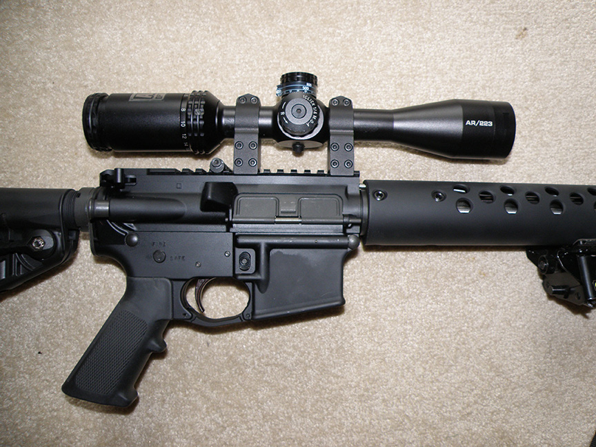

Thanks zlman 1.5" is about perfect for my cheek weld. The Nikon P-SERIES mounts that I have measures 1.375" ( which is to low for me ) but my old set up with low rings on top of a riser is 1.5".
PS: 1" rings.

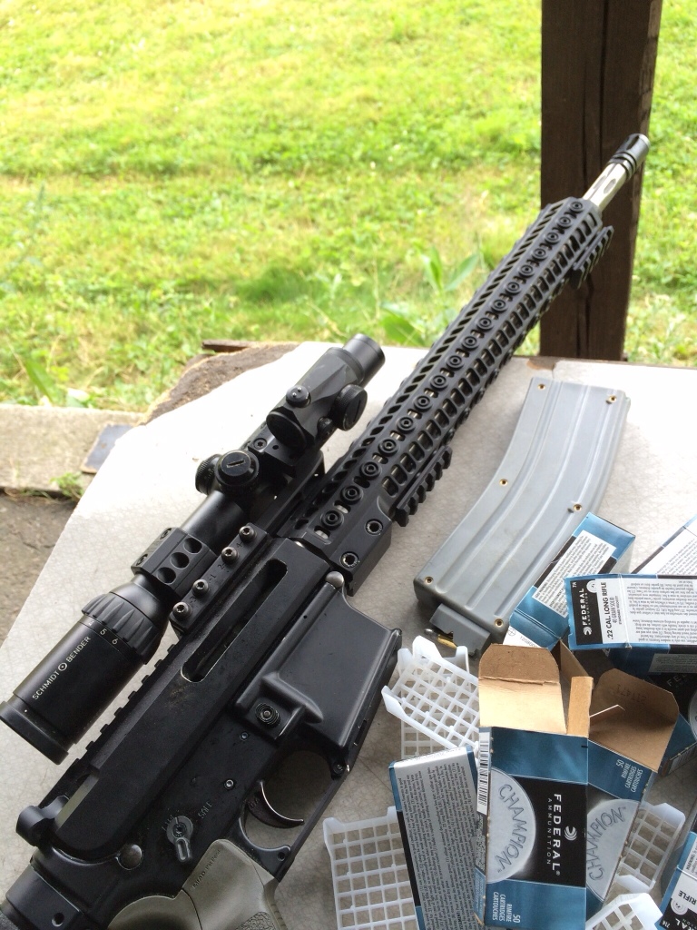

I finally got my cheek weld correct with Warne Ultra High QD aluminum rings. It measures 1.5" from the top of Picatinny rail to center of scope tube. I had a set of P-SERIES mounts that measured 1.375" which was a little to low for my comfort.
PS: Scope looks bent, but it isn't it is the photo being distorted.
