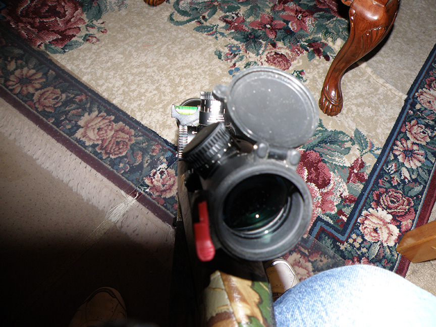

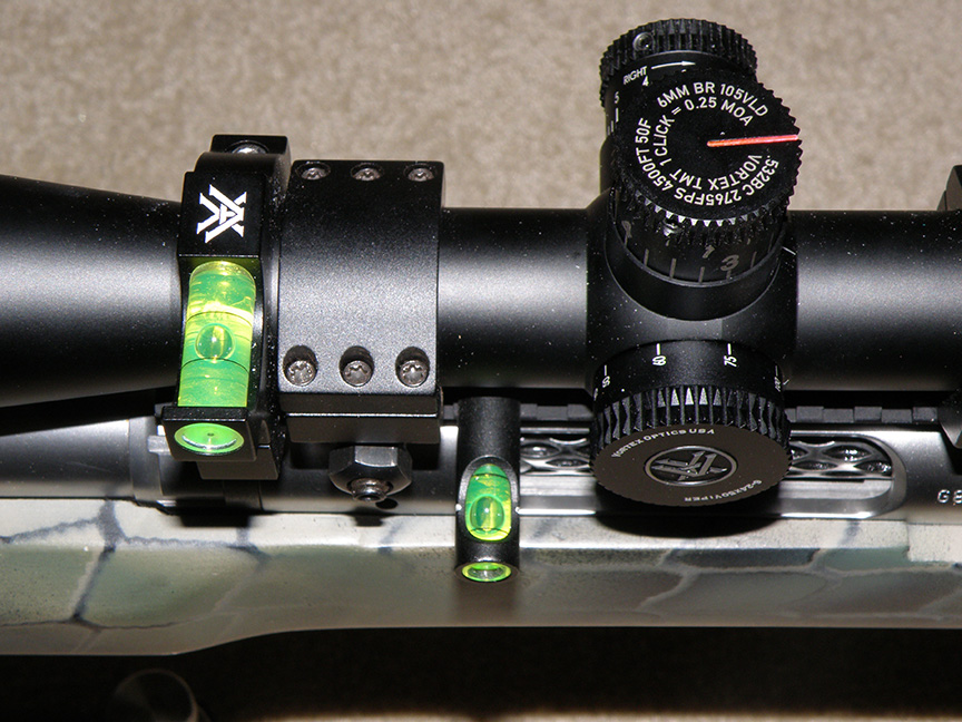

I got out my rifle that has the Vortex 6-24x50mm PST FFP MOA scope with an offset bubble level attached to the scope. I looked through the scope and tried to look at the level at the same time (left eye on level + right eye in scope). Even though I am used to using this level attached to the scope it is not as easy to watch while holding the reticule on target. I then shouldered my M4 and while looking through my Bushnell AR/223 scope with 4.5-18x40mm zoom. It looks to me that the bubble that attaches to the back end of the Picatinny rail is visible with the same eye while you are aiming through the scope. I was very surprised and will be ordering one. I don't need the rear iron sight since I am replacing the upper with an 18" WOA Varmint with a 1 in 7" twist.

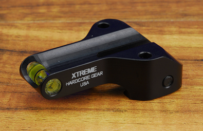

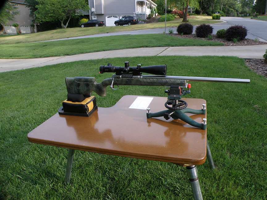

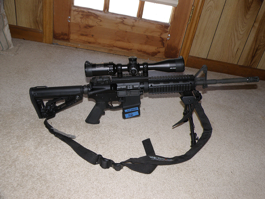

Take a look at the distance between the scopes and the barrels of my two rifles. With the much larger distance between the scope on my AR and its barrel will make more error of the POI with cant than with my hunting bolt action. This is why I am going to order the X-treme bubble for my AR. When I look through my scope the bubble will be out of focus, but I think I will still be able to see if the rifle is canted or not. I won't know for sure until I receive it and put it on.

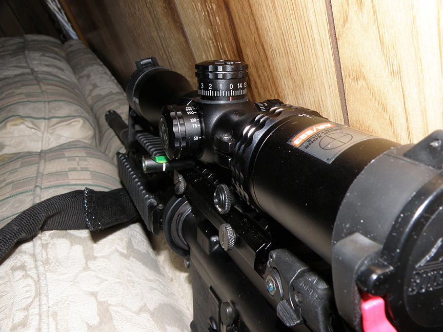

PS: You can see the B-Square bubble level attached to the rail on my M4 in the last picture.
