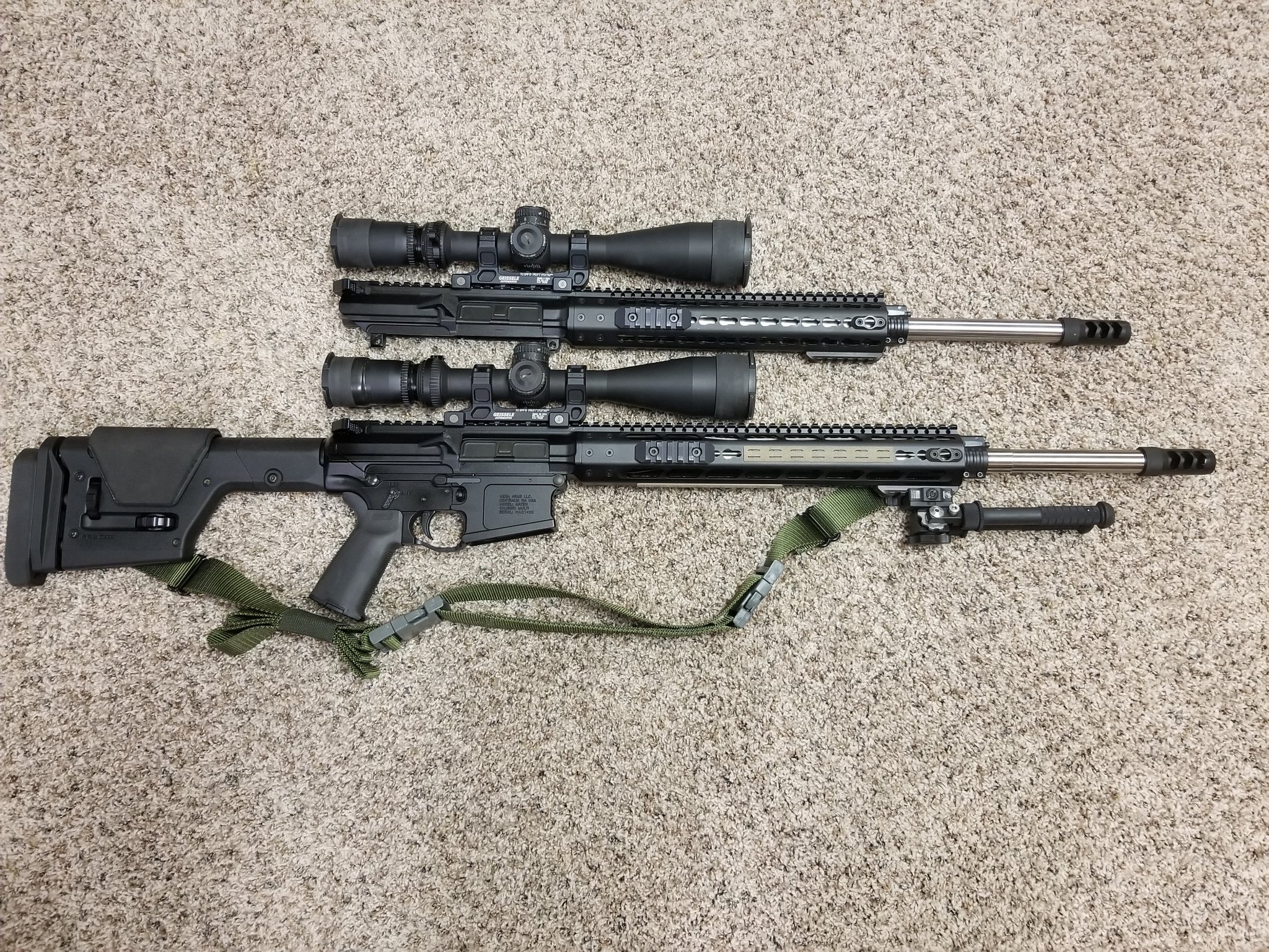

Posted this yesterday concerning scope rings on an LR:
"I'm using a 1-piece NightForce Ultralight 20 MOA 30mm mount on my long range LR243. It is about .800" from the pic rail to the bottom of the scope tube (forward edge). Nightforce Ultralite Unimount Picatinny-Style 20 MOA Elevated Integral (midwayusa.com) I have 2-piece NightForce Ultralight 30mm rings on my LR308. On that rifle the scope tube is about .750" above the pic rail. Nightforce 30mm Ultralite Picatinny-Style Rings Matte High (midwayusa.com)
Both are pricey but lightweight (aluminum alloy and titanium). I've shot at least a thousand rounds through both rifles without a problem from the NF scope rings and mount."

More than enough room for 2-piece scope rings. Picture of my daughter shooting my LR308. LR243 in the foreground. Both with 2-piece rings and lots of room on the large LR to adequately position your scope for proper eye relief. I have since replaced the scope rings on the LR243 with a 20 MOA 1-piece mount.
