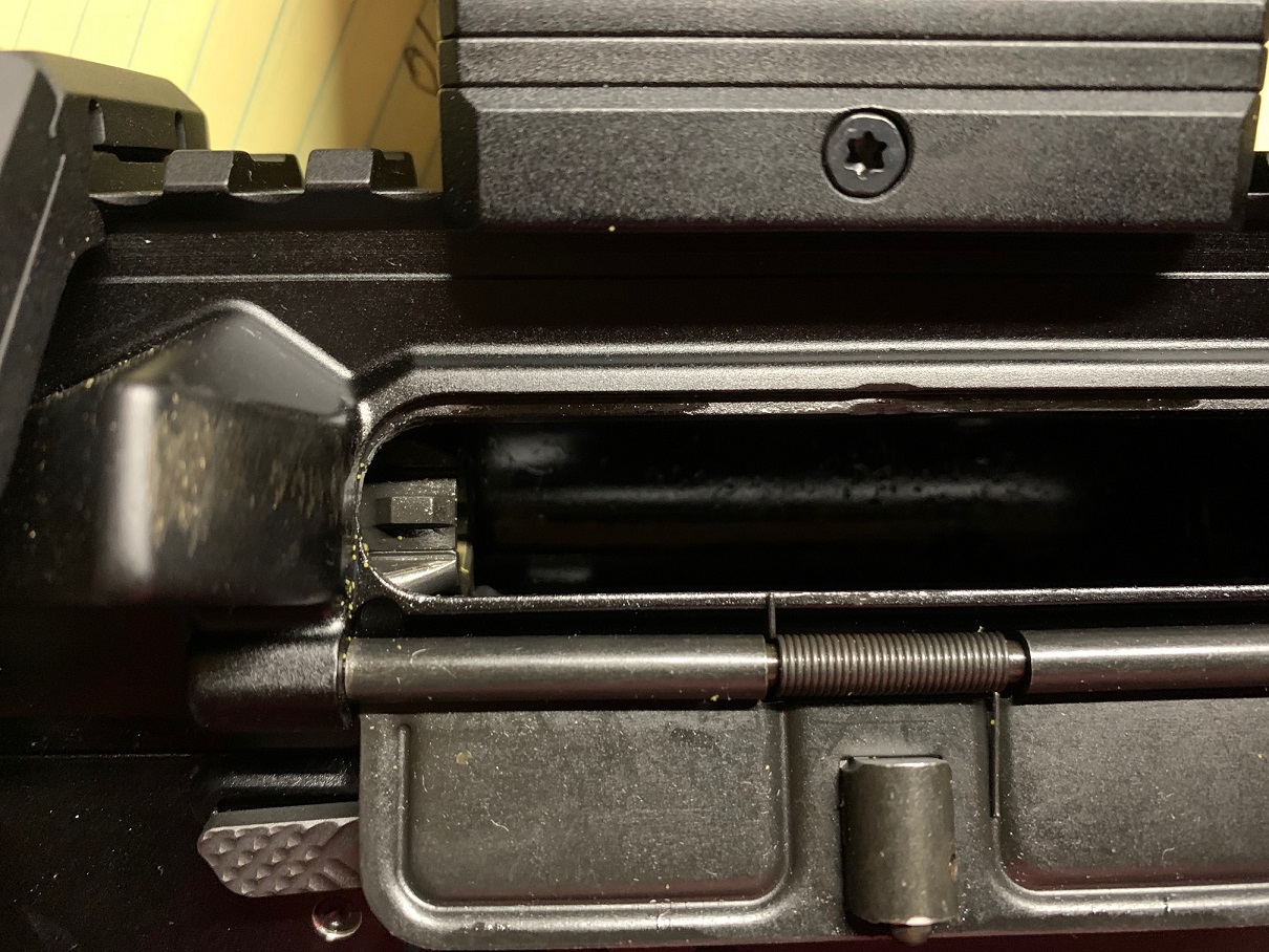

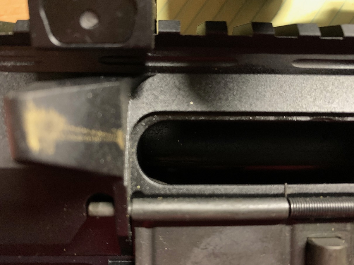

I think a lot of the DPMS pattern upper receivers have the ejection port in the wrong location (see pictures below). Hell I doubt they're even consistent in port location - barrel extension from one manufacturer to another since there is no real spec. Maybe this is why most top tear large frame AR manufacturers use Armalight pattern receivers. Edit: I compared pictures of JP, Wilson, Knights, LMT, & LWRC. All Armalight style & all appear to have the rear of the ejection port further back then my DPMS pictured below.
AR 15 with bolt resting on bolt stop. Notice position of bolt face as it relates to shell deflector.
Now look at My DPMS with bolt sitting on bolt stop. It's recessed about .125 & no wonder these are so prone to stove pipes. Since extraction ejection is the same, you'd think the relationship between bolt face and deflector would be an important spec just scaled appropriately. It does not appear to have been on on my DPMS billet upper. FYI - I'm running the double ejector Toolcraft.

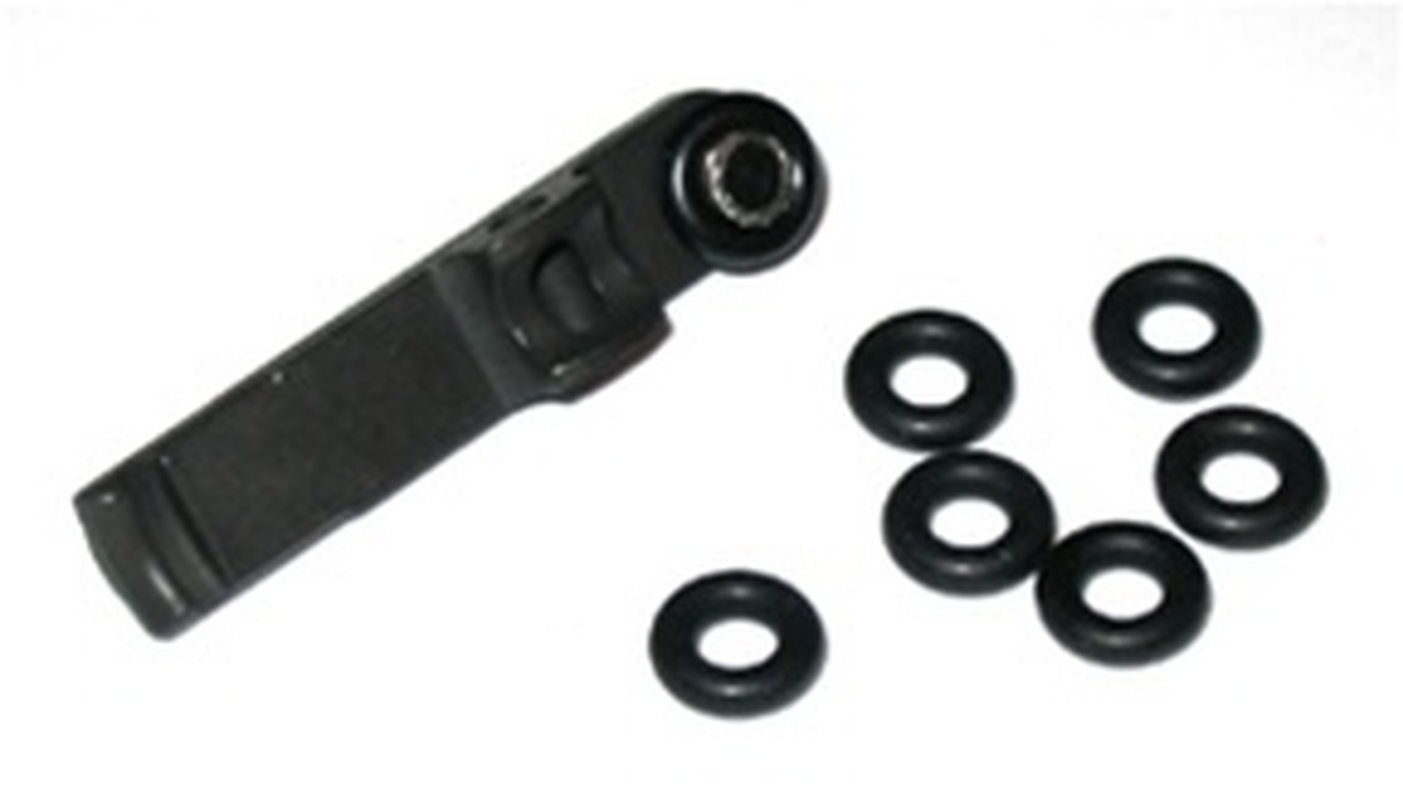

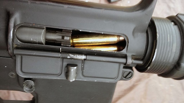

No idea if this is your problem but I had an issue a while back. I posted a pic (from google) of the exact issue I had below. It was suggested to put an Oring on the extractor, which it didn’t have when having the issues. Installed Oring and works great. hundreds of rounds later and zero issues.
May or may not be your issue. A pic of what it does even off google search could help diagnose
