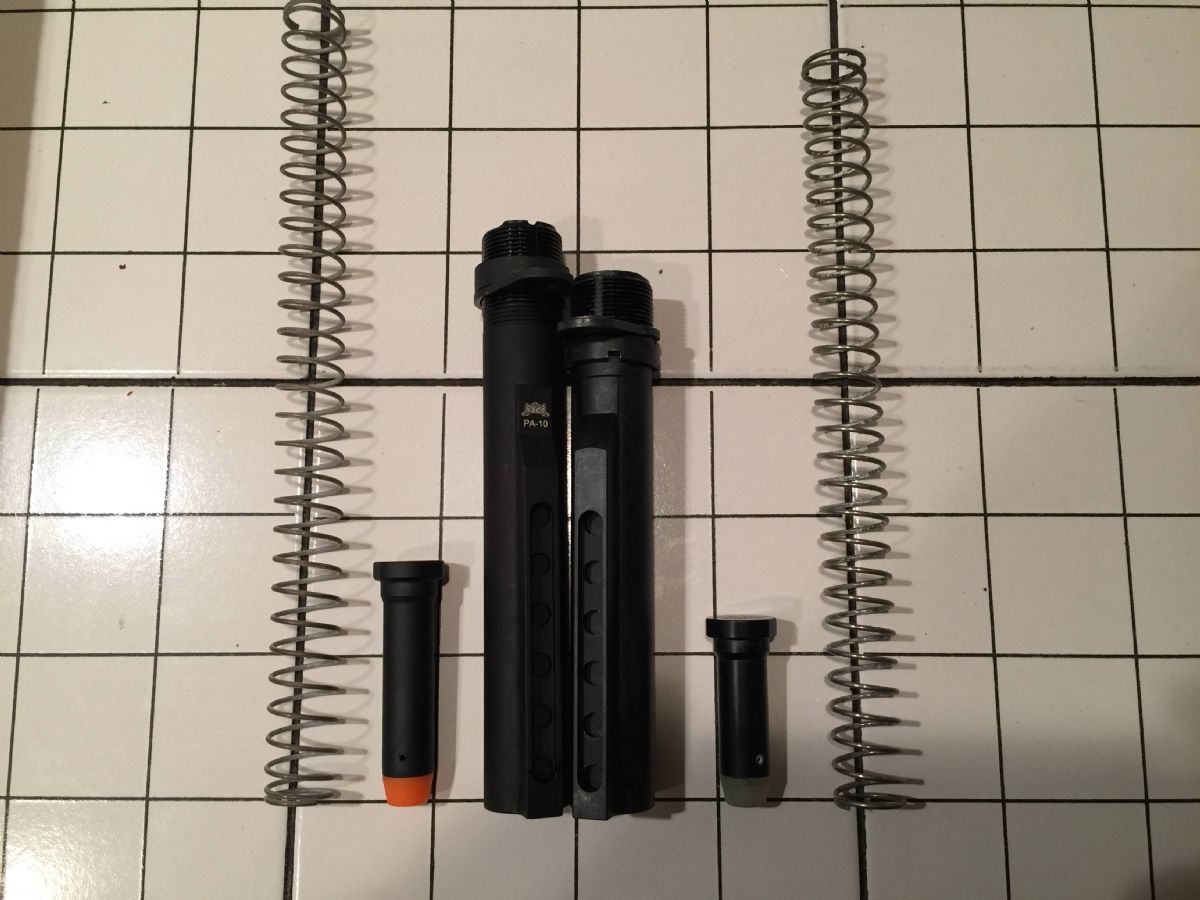

Pics to be a little more clear. ( For those that didn't get it, Lol )
There are 2 dominate 308 carbine recoil setups... Armalite Pattern ( left ), and the 3/4" shorter DPMS pattern ( right ).
I use the "pattern" verbiage , because there is no Mil-Spec guidelines for a LFAR. ( Large Frame AR )
Anyone new to the LFAR world will see the "pattern" differences can apply to the recoil setup, upper barrel nut threads... etc.
Everyone can see how the parts DO NOT interchange.... IE swapping a 2.5" inch buffer into the longer A5 buffer tube will cause lower RE battering, and using the longer 3.25" buffer in the DPMS pattern, will NOT allow enough BCG travel.
Adding a Vltor A5 Buffer ( longer by another 3/4" ) will not work in either Pattern, in a LFAR carbine or rifle length buffer tube recoil setup
Left side is a Vltor A5 tube / Armalite "pattern" 308 carbine buffer tube.
3.25" AR15 carbine length buffer is required.
The recoil spring is from PSA ( came in the kit )
Right hand side is a AR15 carbine length buffer tube / DPMS "pattern" for a LFAR
2.5" buffer length is required. KAK makes one that is 5.3oz and 2.5"
That recoil spring came in the OEM PSA kit as well.
FWIW... both have worked well for me.
Is either one better then the other ?... that is up to you.
There are 2 dominate 308 carbine recoil setups... Armalite Pattern, and the 3/4" shorter DPMS pattern.
Adding a Vltor length A5 buffer ( longer by another 3/4" ) will not work in either Pattern, in a LFAR carbine recoil setup
