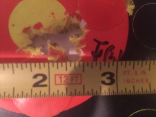

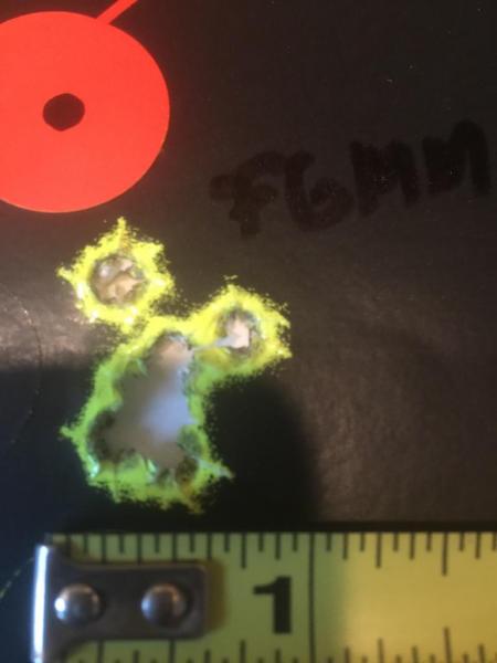

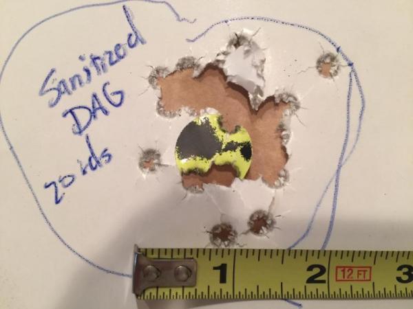

With my Criterion barreled, lapped receiver face and Loctited ( 609 ) 18" Middie and FGMM 168gr benched, scoped, etc...
I can routinely shoot like this with the 168gr FGMM ... I am not bragging... but the rifle is capable of some fine accuracy.
I have done this enough times to have full confidence in the 168gr FGMM.
I doesn't shoot everything like this... but.. it loves the FGMM
Some day when I have the time to develop loads... I hope to do better.
First photo is 5rds
Second photo is 7rds
Third photo is 20rds DAG Ball( Sanitized ) from SGAmmo.com

Good shots, tex.
Mine is lapped as well, and the barrel fit is quite snug. I've had my doubts about bedding the barrel into the receiver.... Did you ever shoot the gun without the loctite?
Good shots, tex.
Yes... and with the factory SS barrel and the Nitrated barrel.
I will IM you some links including the 6.5CM Uppers results.
That's certainly interesting. I was having a lot of trouble with a gun. Ie, testing HUGE amounts of precision handloads in my first AR10 and all of the groups were 2.5 inches. No variation. I have a fresh set of shims... and I have loctite. Can't hurt to try. It's already been lapped.
Loctiting the barrel to the upper receiver has positive results in terms of accuracy on the large frame guns. Bfoosh and I both bought PSA Gen2 rifles when they were on sale last year, he’s gone farther down the rabbit hole than I have so far. I’ll spend some money with SLR to get an adjustable gas block and a free float hand guard to give the OEM PSA .308 barrel a chance before I put another tube on it.
