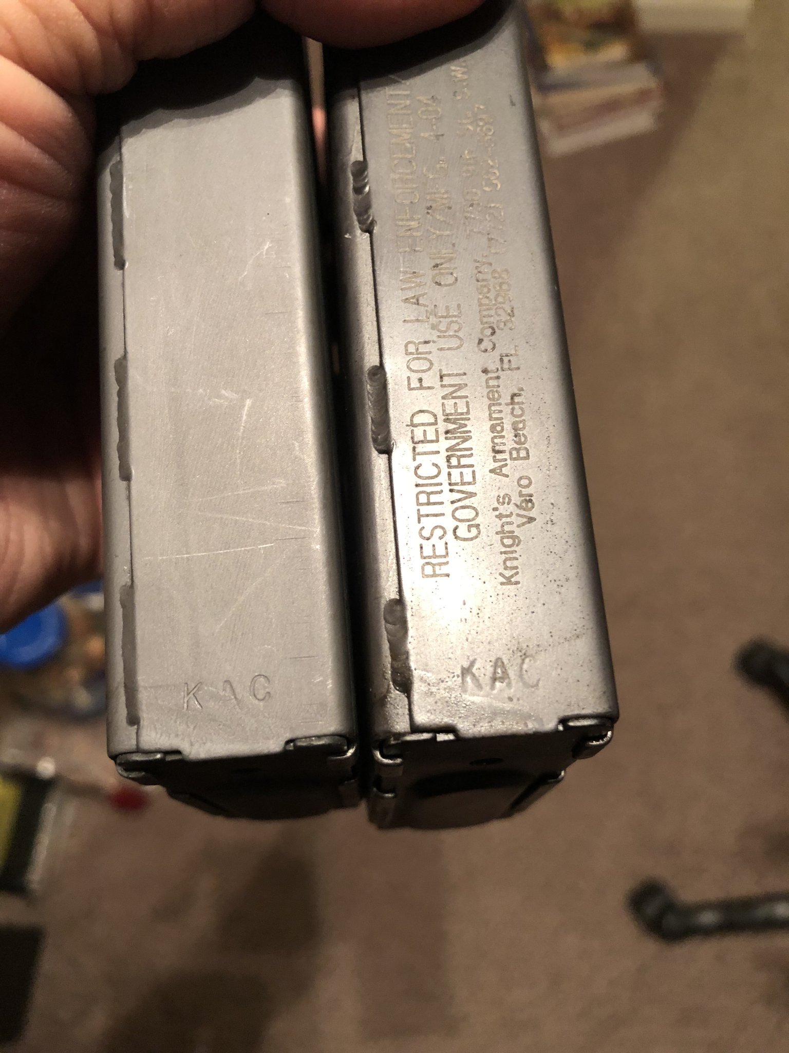

Should I get the KNC SR25 steel mags for better COAL in my JP LRP. Or is the idea of the 'longer allows better...' relative to loads recipes and use?
Thanks in advance.
175 TMK COAL 2.900 touches the lands.
Pmags don't do that but the KA SRs internaly can do 2.88 if one can afford the kidney needed to buy one. C products and ACS do close we will see.
And these didn’t cost any where near a kidney.
I reference that as well. I mostly use a 10 round KAC in a bolt action for 6XC. I’ve used it for 6.5 Creedmoor and found my 139 Scenar load shoots just as good or better at 2.80. I’ve loaded them out to 2.85 but really didn’t gain anything by doing so.
