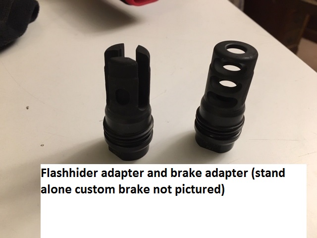

Rugged surge 7.62 with flash hider adapter and muzzlebrake adapter (and for testing a stand alone custom brake)
I am seeing an accuracy difference when running the flash hider vs muzzlebrake adpater from surge, is this anything others have seen with flash hider type adapters? Also i did check the flash hider in the lathe today for any obvious concentricity issues to rule out that and any other obvious manufacturing issues.
