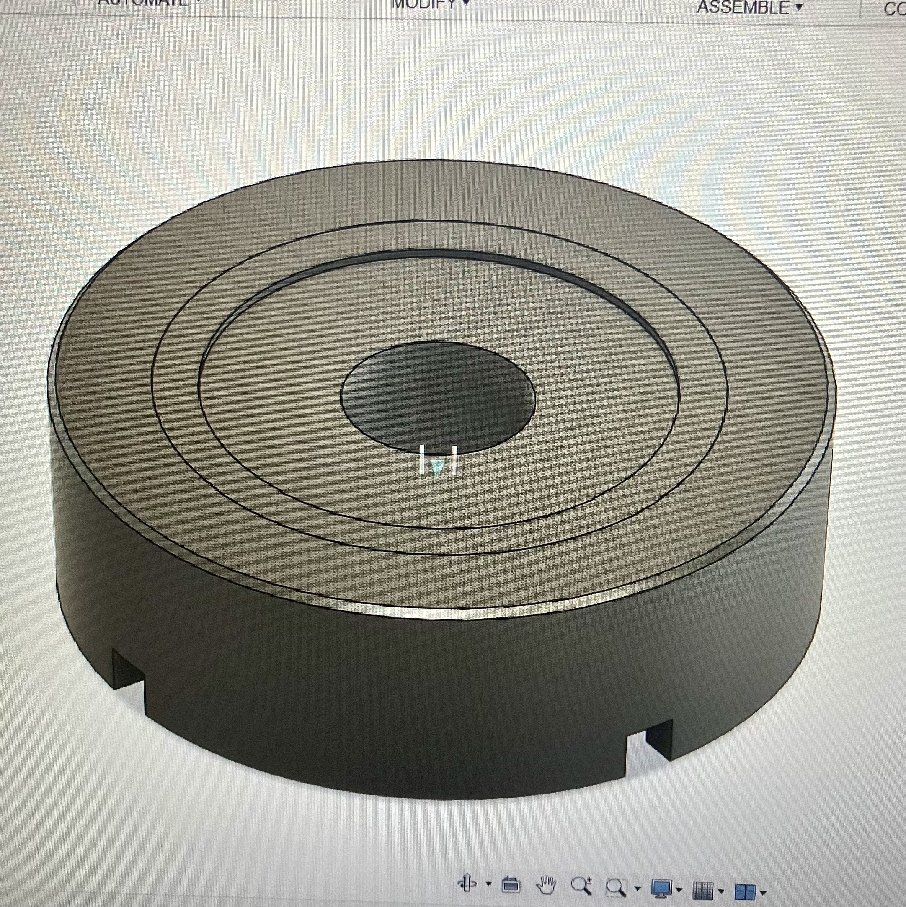

Ok I now have an RR in my books for cleaning, I have a few thoughts to consider.
My first is to make a flat end cap the same design as the RR break.
The second option is to make a solid end cap that seats somewhere other than the taper that the stock RR break uses. There is a lot of surface in there to use to seat a solid cap that will not effect the stock configuration. Of course making the stock design will require 2 parts and the snap ring and be more time and money (more details to machine). I will start with the solid and see how the comments go, I will also work towards making the 2 piece stock design but I'm thinking the solid will look and work just fine. Then you can swap back and forth and clean while your in there.
With that being said I cant see why a few of you would want an adapter locked in there and not just switch back and forth from the RR to a flat cap??? These things getting dirty so you would want to clean that thing out anyway.

Personally I like the solid end cap idea. One piece that screws down nice and tight and takes the length of the brake off. That's just me though.

the dead air end caps use a socket to screw and unscrew, the cap can be recessed inside the adapter and it would not interfere with the RR brake at all. It’s a small diameter end cap and the rr brake is very large in diameter. This would allow maximum configuration and if you have an end cap strike you can just switch it out.
For the two piece one, I don’t think that would be required. On the adapter itself, can you not simply replicate the taper surface and the threads in a solid formulation without that snap spring? The adapter should be on there more or less permanently. Those areas don’t need to be cleaned. The female threads on the adapter where the rr brake go will need to be cleaned. This way it can be one solid piece

No need to overcomplicate this. One piece that screws on the end to turn a RR can back into a regular can. One op in a lathe with a cutoff or 2 if you have a sub you can transfer to. Zero need to have adapters on adapters for an endcap.

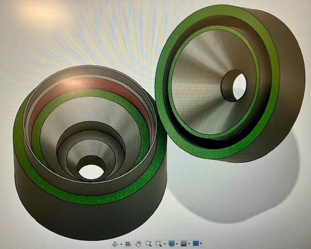

Have you ever machined?
On the left is the top of the can, the red surface is the interface taper for the stock cap, due to this being a screw on I avoided that to avoid galling. Also if you notice the slot needed to clear the this wall that would get smaller and would not be machinable.
There are two options for mating surfaces in green, if the inside green surface is used the cap would be as you see it, if the outside surface in green is used the center cone section can be shortened up a bit giving more of a chamber. The outside green surface would interface with the shoulder on the outside of the can which is covered up by either the RR cap or this Flat one.
The simplest way is the outside shoulder but I believe I could machine either one. Of course there will be slots for the stock wrench.

Yeah that looks pretty good, I would say if you could make one where it interfaces with the taper even partially, that would be preferable but if not possible and there’s adequate friction with the flat surface on the outside to keep the adapter locked in place then that’s ok too.
For the dead air end cap, it’s pretty small diameter wise and not that thick when it comes to the cross section and there’s a good amount of meat left to have a recessed cap so you can switch between calibers and then on the outside you can have the RR thread section for the brake portion.

honestly, I feel like the shoulder on the outside provided adequate friction if you use a wrench to get it on and with some rocksett it won’t be going anywhere. The taper interface isn’t needed and I’m just over thinking it.
For the second thing, the rr brake you can just remove the end cap and then attach the rr brake. That way there’s no second chamber.

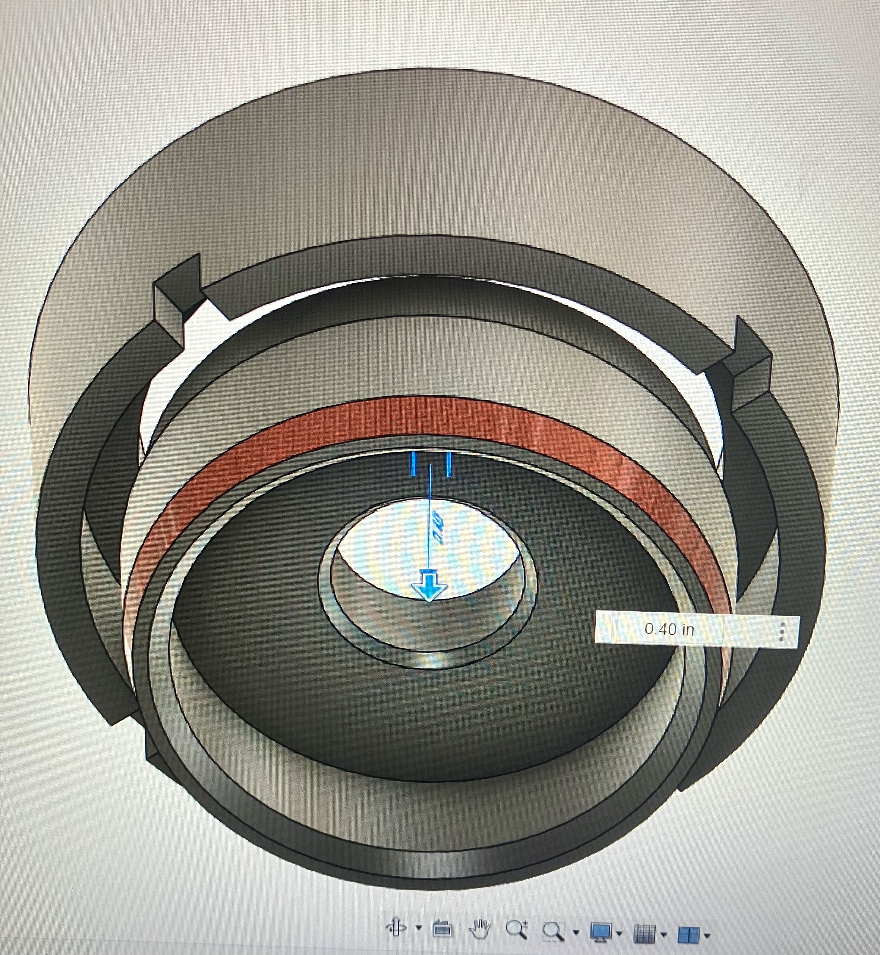

Here is an option for two part design using the taper. I think this will be the best option. Again the red is the taper mating surface. The ring will push into the taper just as the RR brake does and will lock up tight. I'll face the front of the two parts while assembled so the witness between them should be minimal.

That’s actually a really nice design.
Reactions: outlawsix
What happens if the inner piece gets stuck?

This is indeed nice. Rough idea on cost and weight for this?

Prototype this week with weight and photo. Waiting in the lathe to open up for production.

I will need one slight but crucial modification in bore diameter. Mine will be going on the 375 version with the purpose of hunting dangerous game in Africa. Hopefully this won’t be an issue?
Weight should be about the same as the RR brake. Cost is looking like 160.00 for Ti
