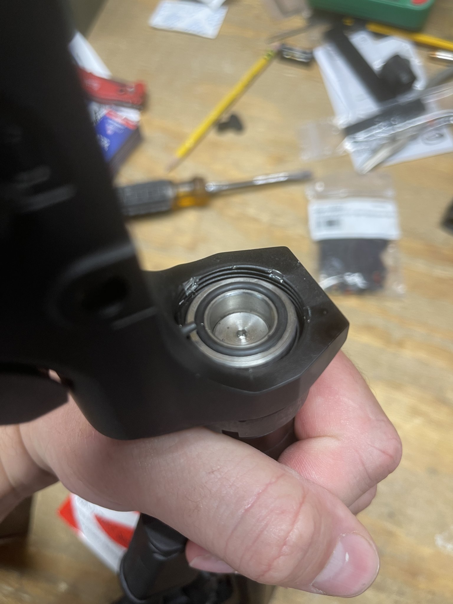

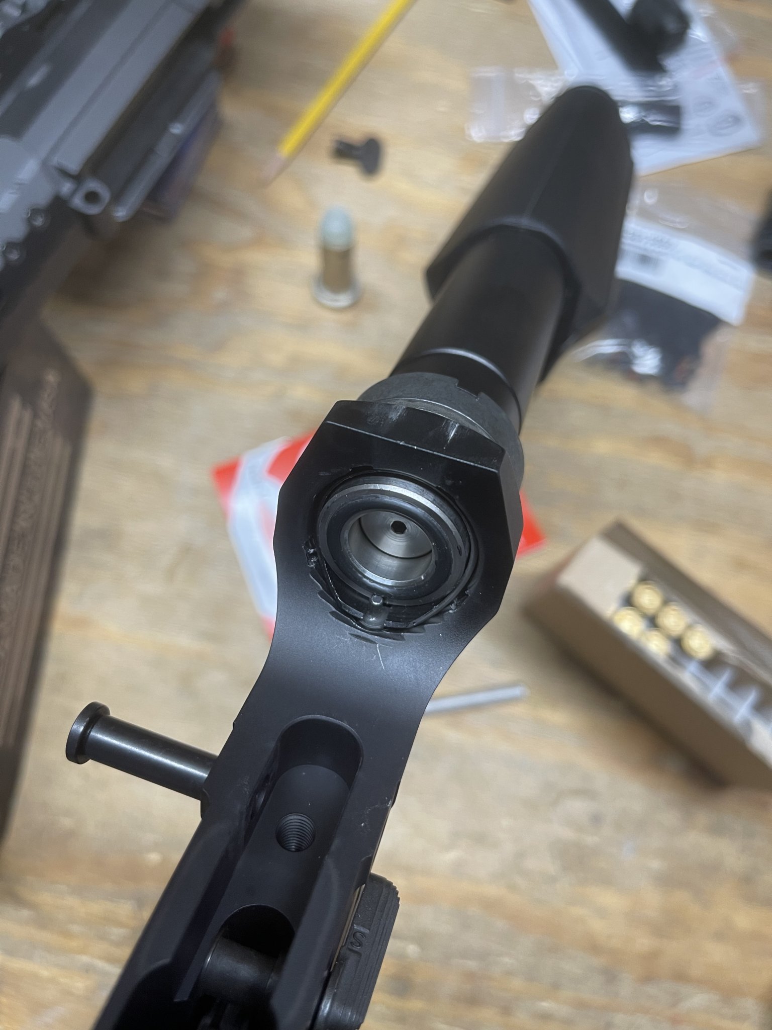

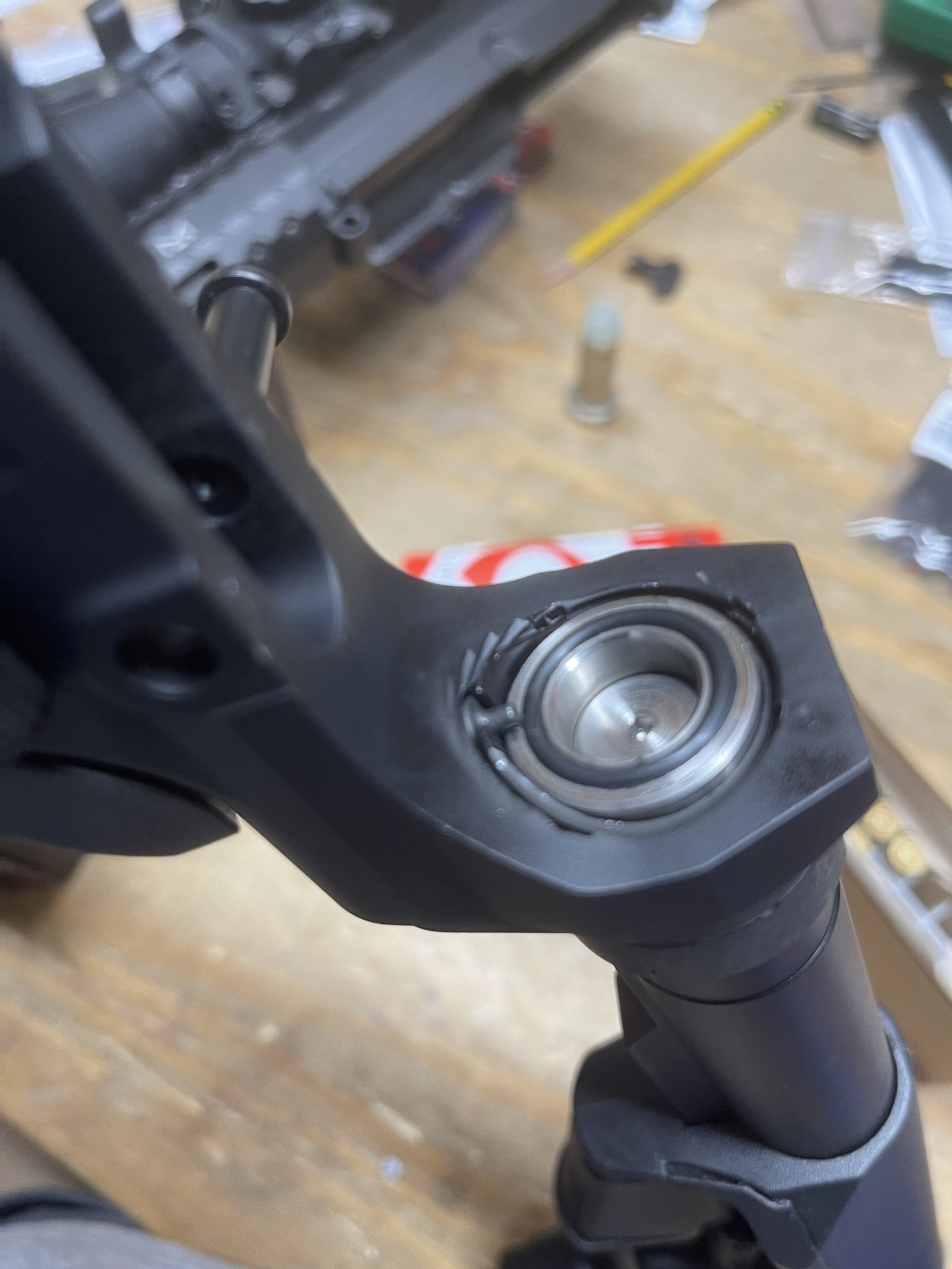

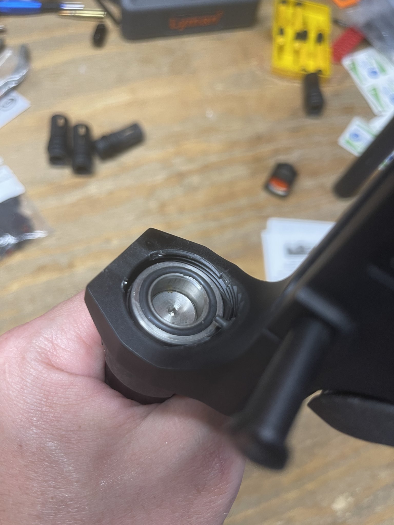

    I just noticed wear marks in the buffer tube, in the threads where the bolt has made contact with them.

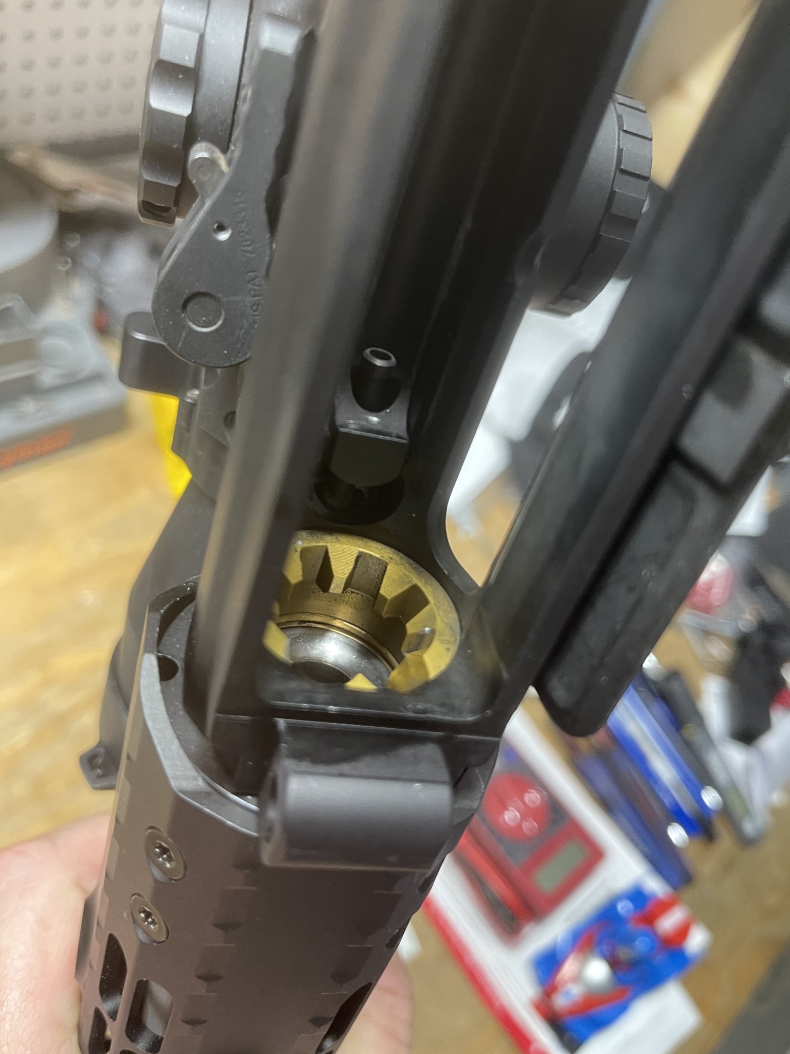

    I had issues like that with a 308 build. The cause was the index pin on barrel extension was off center just enough to cause alignment issues with bolt. No idea if that's your problem but it's something to check.

    I assume the gouges on your lower match up with features on the bolt carrier. If the bolt carrier is slamming into the receiver tower and gouging it, the BCG is traveling too far to the rear. You may be looking at two different issues.
    I think the armaspec recoil spring is allowing the bolt to come back further than it should, even when I pull it back manually, it seems to go back into the tube all the way. I just went out and turned my gas down 2 clicks, and it wouldnt lock back, so its not overgassing.
    Seems to me the only way it can hit your lower on the way back is if the tolerance fit is too large on the upper. I would take out the buffer/spring, remove the bolt, assemble BCG into upper, attach to lower and see if I can manually jam the BCG into the lower by tilting with my fingers.
    I dont think I have a dedicated ar10 buffer/spring here, but I have a spring that measures 10.75" with a carbine buffer, its tough to get it back enough to lock back, by hand, but i can do it.. I fired 3 rounds with it, adjusted the gas once to get it to lock back and it did and no more marks, (I colored the marks with a sharpie)
    Might have to ditch the armaspec and get a regular buffer/spring

    I bought that lower complete too, the tube was screwed in just far enough to catch the buffer pin, now that it's 2 more turns in, when I take the bcg out and push it down into the spring/tube, it doesnt come close to contacting the receiver.
    You bought it complete and I’m assuming the castle nut wasn’t staked if you just screwed the buffer in more? Easy fix. Well anyways, that’s the fix for the overtravel of the BCG then. For the lockup issues I’d confirm any rifling engagement and headspace as I noted above.

    If these other checks don't solve it, the extension may be improperly aligned. causing the lugs of the bolt to hang, I've seen it many times and while it may function, it will wear at an accelerated rate.

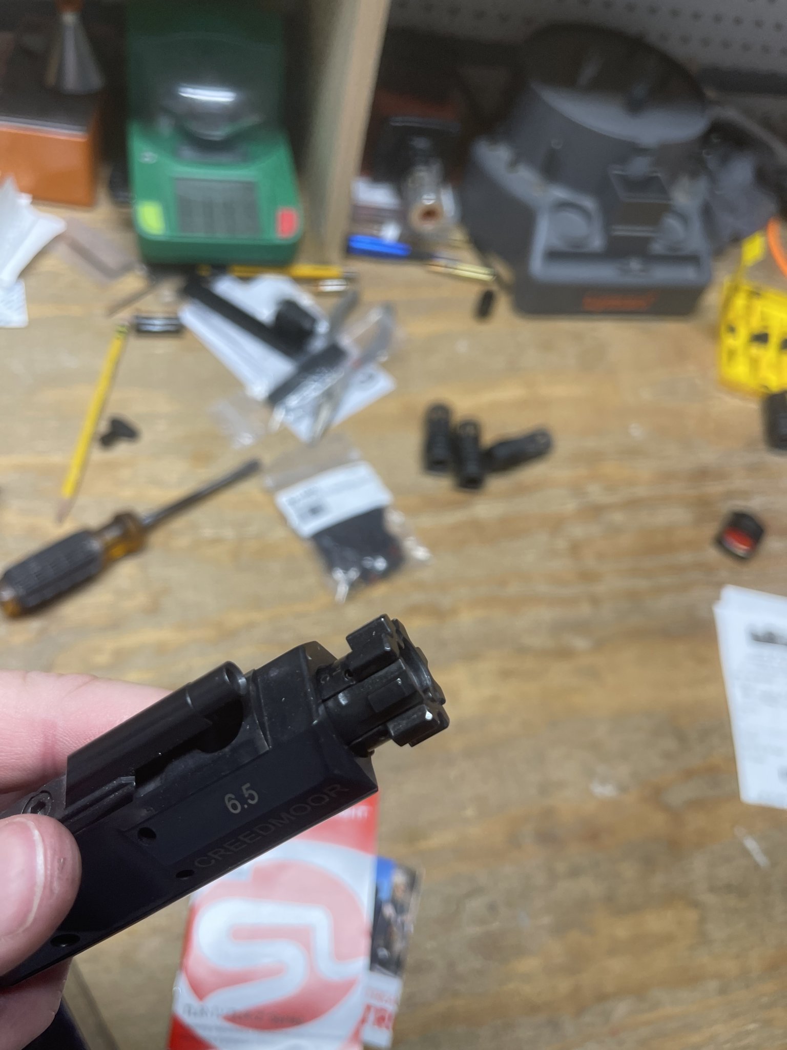

    If it's doing it with no round then I would borrow another BCG and test it. That is abnormal. First thing though, remove the bolt from your BCG, separate your upper receiver, make sure the lugs and area the bolt goes into the barrel is all clean, and try to insert the bolt by hand. If you can put the bolt into the bolt extension and rotate it into its locked position, then it's a bolt carrier problem. If the bolt will not easily go into the locked position with a little fore/aft wiggle room, then you have either a bolt or barrel extension issue.
    yours:
    ef8a8383-3a7d-4379-8119-3dbc288d97cb-jpeg.7905733
    mine:
    had a similar situation, Rainier 6.5CM Ultramatch. Bolt lugs seriously impacting, dragging on barrel extension lugs. tried 2 other bolts, same behavior. Tried barrel in 2 other Aero M5 uppers (M5E1 enhanced and regular), same bad. The barrel extension feed ramps lined up good enough with the upper feed ramps, as good as my other M5 uppers, visual optics were good, used a small shim on one side of the index pin to bias the barrel extension over a little so the alignment of the feed ramps looked really good. but still some drag on the lugs.
    when I hand tightened the barrel nut to the upper/barrel, the BCG seemed to go into battery ok, some drag on the lugs, but as soon as I torqued it to 65 ft lbs, the BCG, regardless of which BCG or upper receiver, always clanked into the barrel extension lugs. I could force it in, but then when I went to pull the charging handle back, I couldn't get the bolt to come out-of-battery.
    I replaced the Rainier barrel extension with a Lilja barrel extension. I did have to address headspace, and gas port clocking, though.
