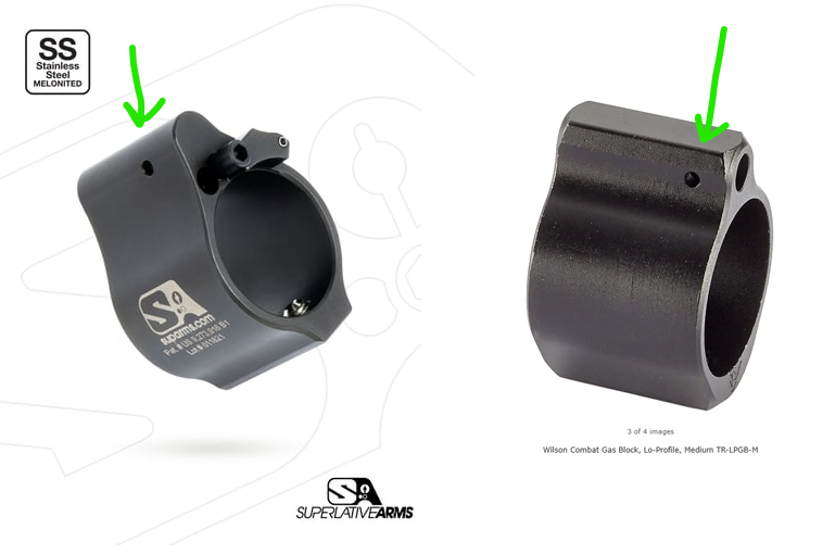

I found a pic of that gas block and you can see that the set screw location is shifted.
I assume you mean roll pin?
The roll pin location is noticeably farther forward on the WC gas block compared to the SA block. This looks to be the exact difference in distance I'm trying to correct.
I'm going to call them first thing tomorrow morning to see if their AGB will mate correctly as well.

Both actually, the roll pin is, and the set screw location looked like it was biased to one end. I do think this will correct your gas tube location.
Might just be the wrong pic but here:

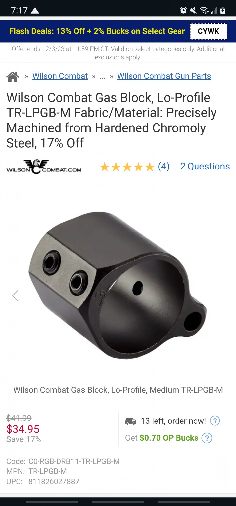

The Wilson gas block shown and listed previously (TR-LPGB-M) is their standard low profile gas block suitable for any AR-15 or AR-10/308 with a 0.875" journal. The roll pin location, measured from the front, is different because the length of the gas block body is shorter than most (0.920"). The bore for the gas tube is drilled through, so you will see the end of the gas tube at the front. Most gas blocks are longer (~1") and the bore for the gas tube is not drilled completely through. Set screw spacing is 0.400", which is closer than most other blocks, but not unheard of.
I believe that Wilson, and one or two others, intentionally placed their gas port location as they do from early on. The intent was to use standard AR-15 gas tubes and to disengage from the gas key shortly after the bolt unlocked, as you mentioned before. People had issues with this causing short stroking, and would source the ArmaLite length gas tubes from elsewhere, as Wilson did not always spec or even sell the ArmaLite length tubes. There is a risk with using the longer gas tube, as it can bottom out in the gas key. This issue is even referenced in the reviews for the 15.5" gas tube on Wilson's site:

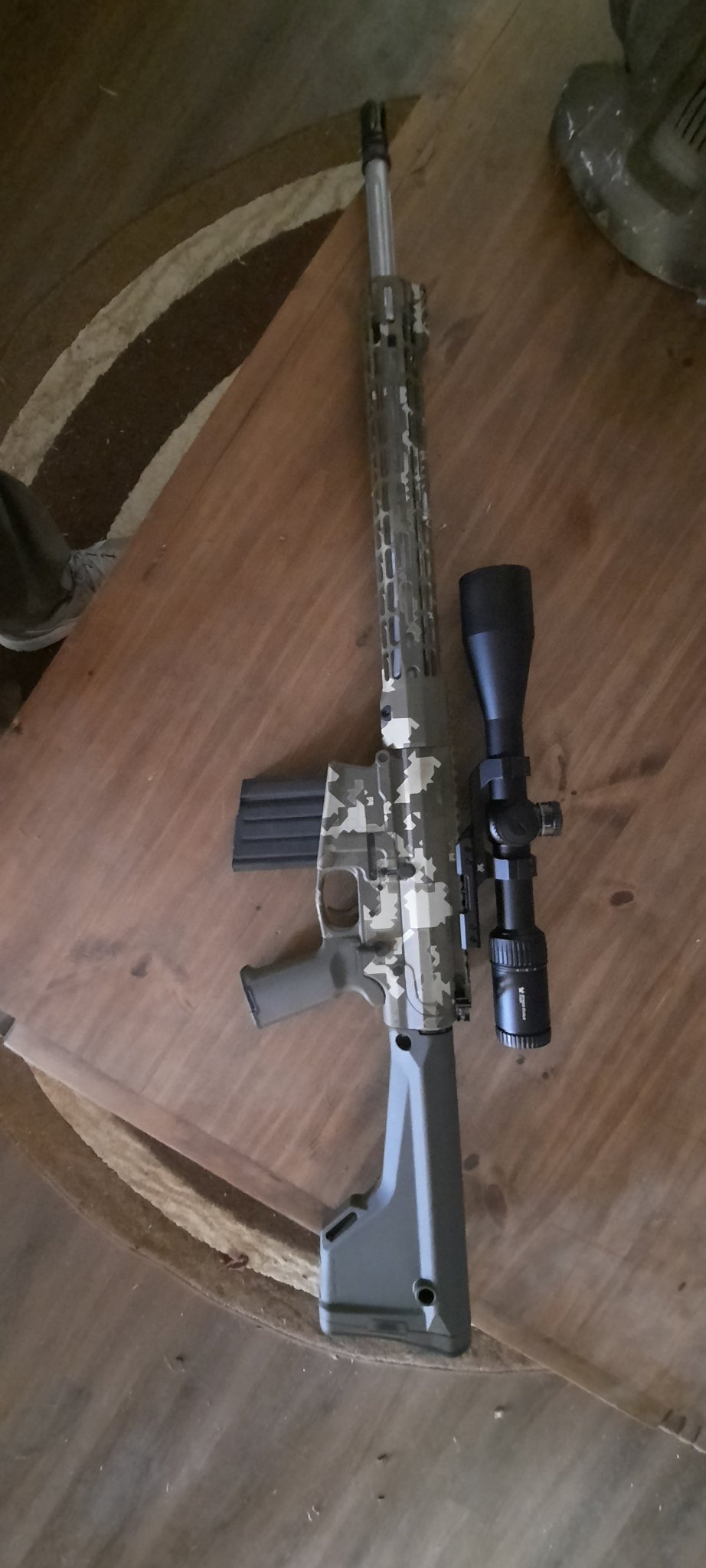

I just built a AR10 using almost the same components, mine functions fine although the recoil does seem a little extreme, but I don't have another 308 semi to compare it to . When I was researching my build I remember reading that the Wilson supersniper used a longer gas tube than a normal rifle length tube , but they were out of stock , but read somewhere that Fulton armory AR10 tube were the same , so that's what I got and it works , I used a A2 style magpul moe stock and Areo receiver tube and spring and buffer assembly. So that might make a difference, took mine to the range for the 2nd time today , not all that impressed so far ,maybe it needs more break in. Using 168 FGMM.only 1-1/4 @ 100 yds, but did ring steel at 500 so not terrible.
What gas block?
I used the standard WC gasblock that was recommended on the website with the barrel, non adjustable.

Using “standard” gas blocks requires a custom gas tube of the appropriate length (which I think is 15 and 3/8”). Conversely, using standard gas tubes requires a WC gas block. Because they have the roll pin shifted to accommodate their dumb design.
Guess I missed that , now I wonder if I've got the wrong gas tube , WC was out of stock when I bought my barrel and I got mine from Fulton, my gun runs fine , but the recoil seems a little harsh, I'll order one of WC's tube when they're in stock just in case , cheap enough. I retorqued my barrel nut today to 58 ft# and cleaned the barrel real good , hopefully that will get my groups down to sub moa.
It’s been discussed in this thread…
WC drills their gas port at a proprietary distance… splitting the difference between AR10 length and LR308 length. It’s borderline retarded and makes it impossible to use anything other than WC products.
Is that gas length or overall length? 14.625" is roughly overall length on dpms rifle gas tube and 12.7" from front of receiver to port.
OP, if you think that your issues will be solved with a custom length gas tube, they are available for around $35 in any length you want.
I found those guys. Just haven’t disassembled my rig yet to do exact measurements. May do that tomorrow just for my own edification and to add to the information in this thread for future readers.
It’s also probably the simplest and most permanent fix.
