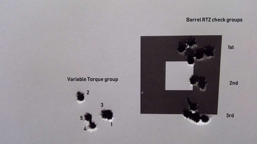

Here's my 20 rounds worth.
M5 Mausingfield
Brux 1:8 twist 6.5 Creedmoor (Saami chamber), 21" long #4 contour
Shouldered Barloc
SRT Arms magnum Ti suppressor
147gr Hornady factory match ammo
100yd indoor tunnel off bags
First I fired a 6 round group (lost count and fired an extra round). Then I removed the barrel and replaced it via sharpie index lines on either side of the stock show-line. Torqued the barloc hand tight with an allen wrench (sorry, no torque wrench here). Fired a 4 shot group. Removed and replaced the barrel, and fired the final 5-shot group on the right side of the target. POA for all three was the center of the square.
Then I put 1 mil left on the scope, and fired the remaining 5 rounds with variable torque on the barloc screw (same POA). The first round was with just enough torque to prevent the barrel from spinning freely. From there I gave each successive shot what I presumed to be about 1/5th increase to a "normal" final torque value (5th shot).
So it would seem that variable torque may slightly change POI, but it doesn't seem drastic in my case. I attribute the POI shift from the removing of the barrel more to indexing of threads/parts than torque value. Changing torque doesn't appear to help accuracy any-- not sure if #2 is a flier or not. About 0.5 mil spread, center to center of the 3 groups.

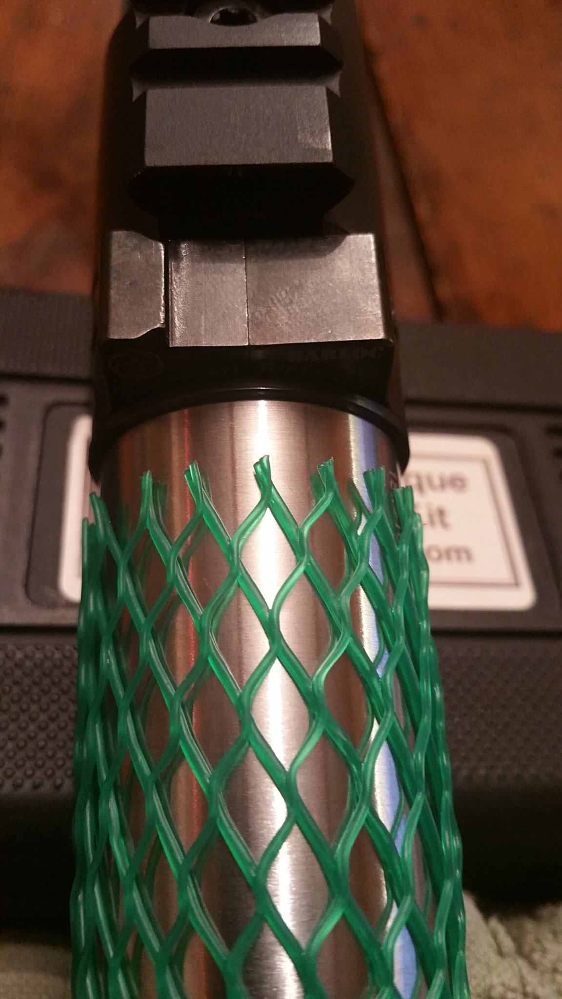

I installed this barloc on a PVA shouldered prefit. There is zero gap in the collar unlike the barrel nut version. Does this look correct to all that have experience with it? It is torqued to 90in/lb
Curious as I’ve got one coming at some point. Did you have to headspace or simply twist till it’s tight and do the Barloc torque?
Same here (all the way shut). I screwed it down on a resized case and there was a small gap between the barrel shoulder and barloc. Tightening the barloc removed the gap and made the barrel tight.
I used a go gauge. With the barrel screwed down onto the go guage, the Barloc was loose. I tightened the barloc screw to 90in/lb and the barrel seems tight, but it's odd the the process would vary so much vs the barrel nut version. (On the barrel nut version, you set headspace, then tightened the barrel until the barloc collar spread to certain distance, then torqued the screw).
Thanks @Winny94. Can we also get a photo with a side view?
Were there two rings (Shoulder barreled side and Action/recoil lug side)?
I can see the ring between the barrel shoulder and barloc from your photo. But how about on the action/recoil lug side?
thanks!
thanks!
its the barloc specific recoil lug
