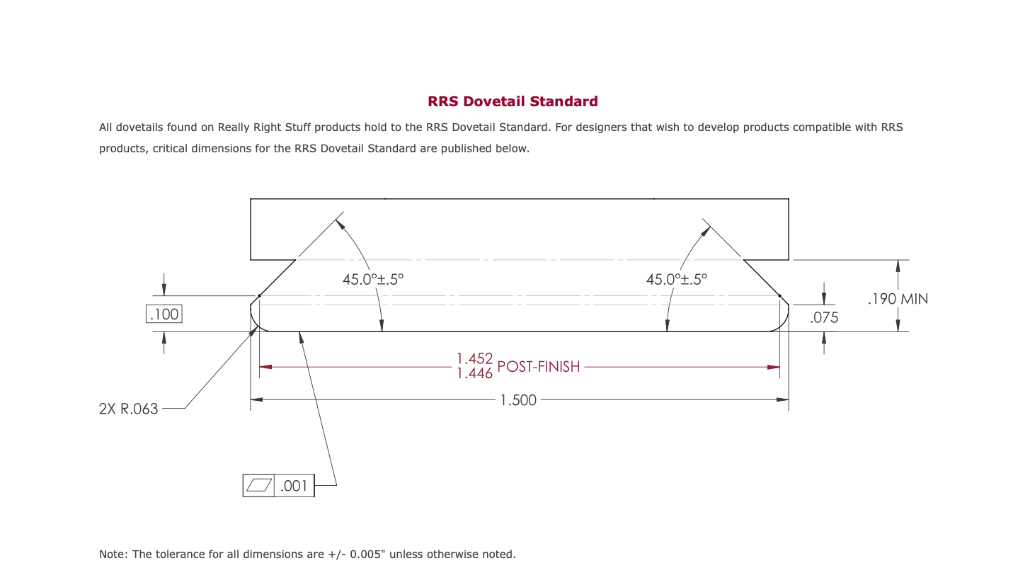

Looking into getting into my first tripod setup. Arca really interest me as they are pretty simple to machine. I run a CNC as a part time hobbiest so any part I see I would rather make myself then spend cash on. Is there any glaring drawbacks to running arca other than having to get a mount for each rifle?
No drawbacks other than some companies don't always make compatible products, even though they say it's Acra Swiss.
Go with RRS, and machine to that standard, and you won't have any issues.
Acra Swiss is becoming very common in the world of Precision Rifle now.
Frank was discussing that on a recent podcast, the ARCA is not a specification and the RRS is.
Correct
There is no Arca swiss standard, there is a Really Right Stuff Dovetail which as a standard supports both. Even the camera people complain about this fact.
So, Stop using term Arca when talking about it, it's wrong.

The way they pull dimensions on that drawing is really odd in some parts. I have a Chinese head to play with in the meantime. Their plate is slightly off so I will use the drawing to base my part around. Ill update when I get a prototype out of the mill, still currently trying to figure how much mlok I want to use to mate it up. Ive seen some plates run a good ~12" while others are just the lenght of the mount.
