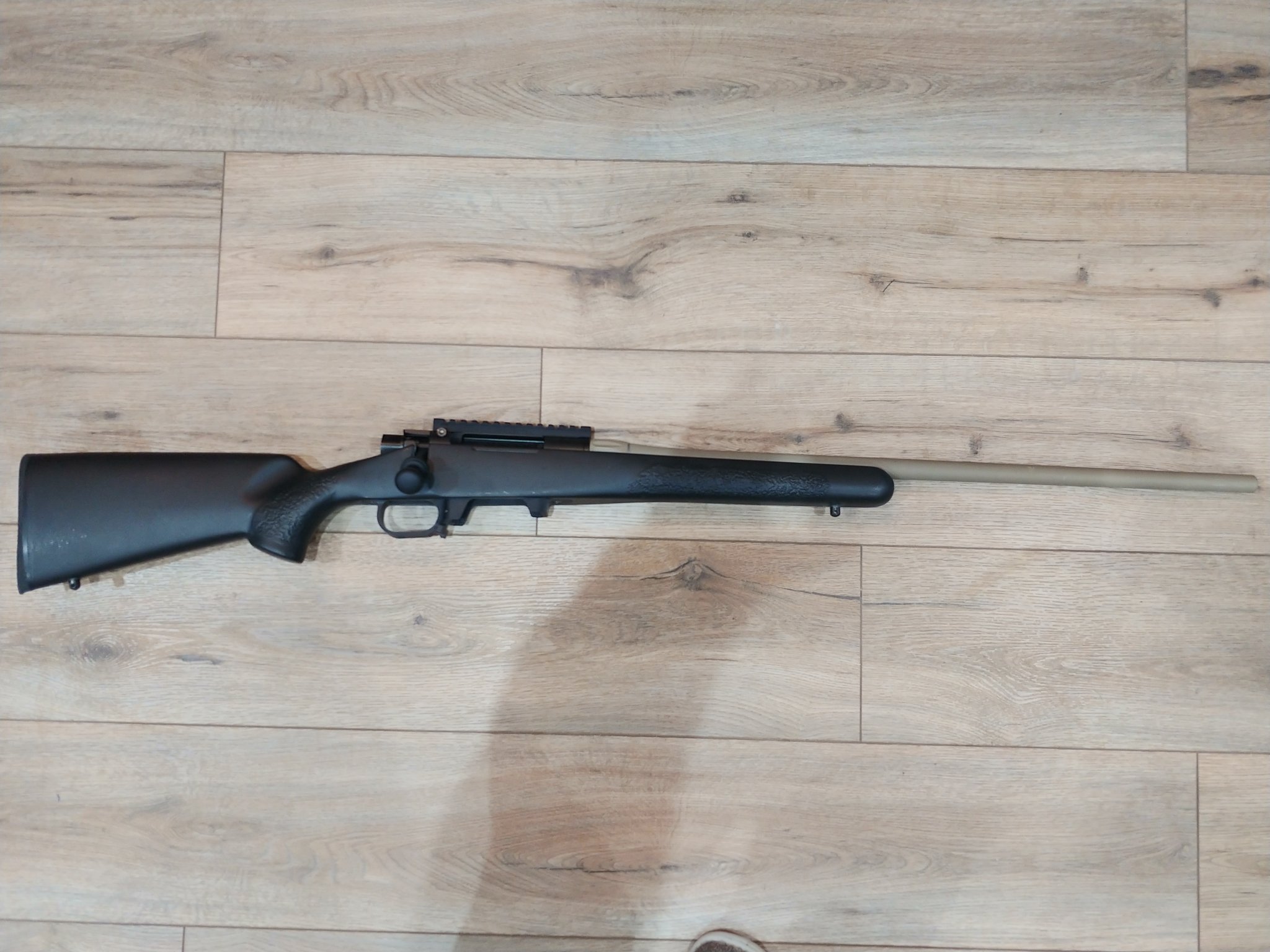

Well I just mocked this up today for giggles.
Manners super light stock
Archimedes action
Random 6.5 saum barrel I had laying around. Ive got a bartlein carbon fiber barrel ready to go to the Smith.
Picked up a trigger tech on black Friday sale. Waiting in it to ship.
6.8lbs as it sits.
Archimedes action
6.8lbs as it sits.
Archimedes action
6.8lbs as it sits.

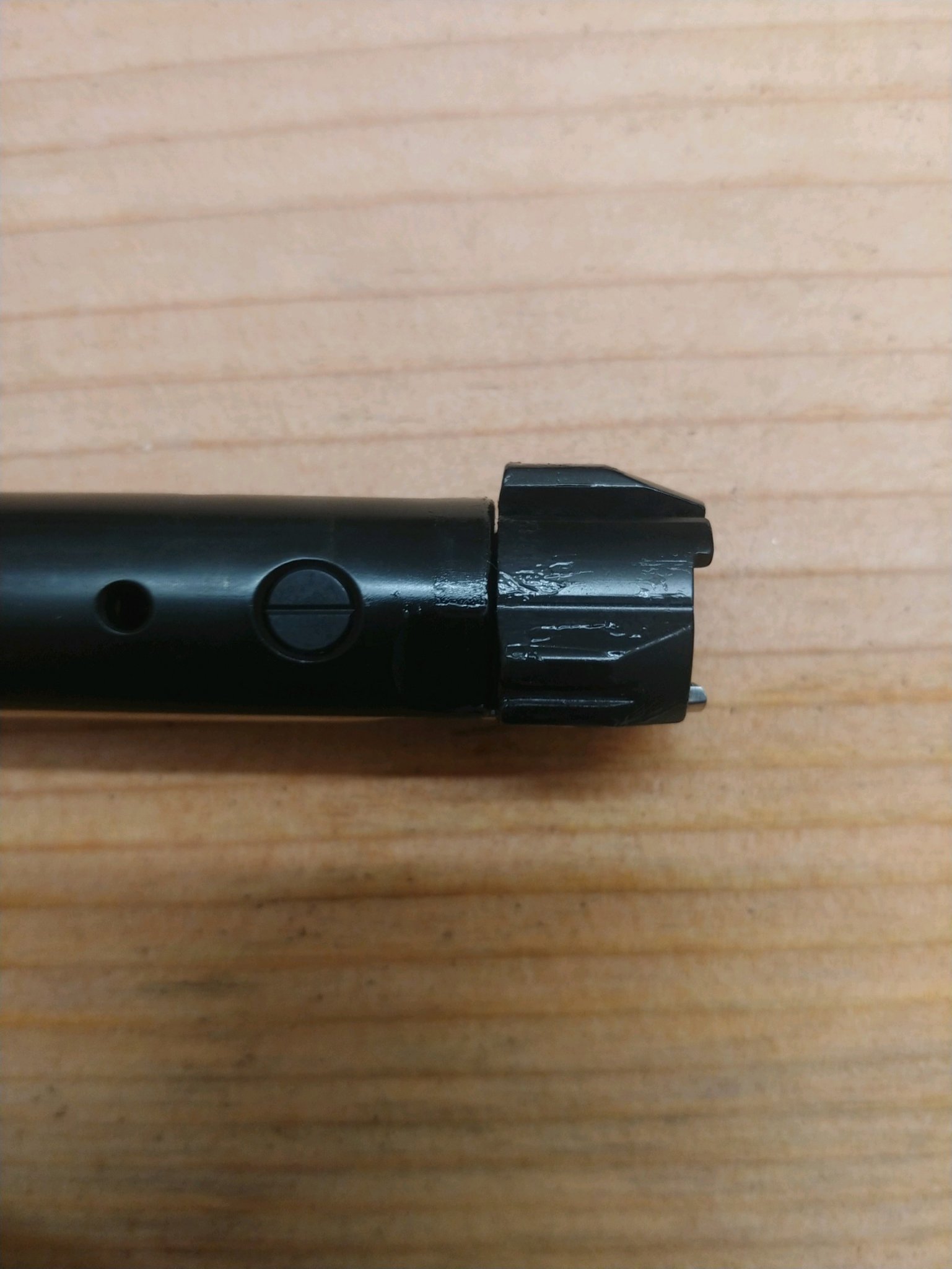

Here is a picture of the bolt showing the toroidal lugs. I thought that this feature was a pretty slick idea. The inside of the actions mating surface is also slopped in the same way, producing contact.
This is just one cool feature in this action. Ted has really put some time into this action.
