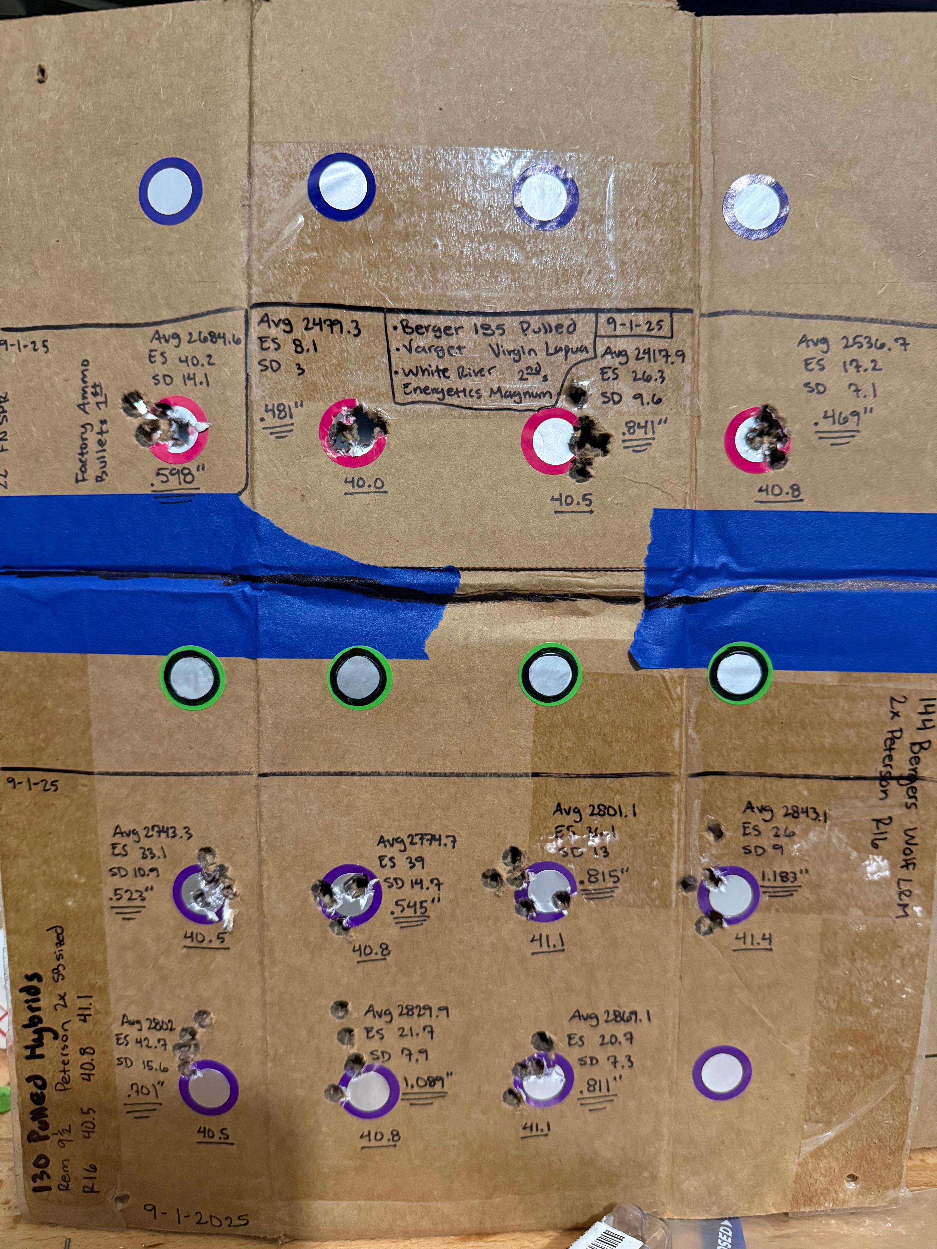

Well, I couldn't figure out the issue or find my distance to lands. I did however, through some random charge weights last night with some pulled 185 bergers I bought. Boy did she shoot great. This was the first time I loaded for this rifle and it did not disappoint.
I first shot a group of cheap factory ammo just to know i was on paper. To my surprise, the very first round hit dead center on the half inch silver circle lol.
Never mind the groups down below. Those are from my 6.5 that I can't seem to get shooting good.
