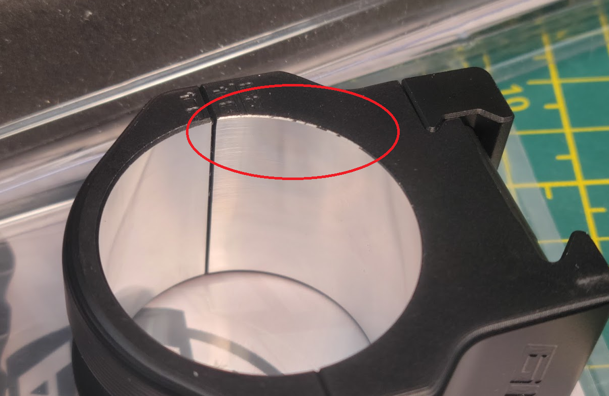

Yup, just like that along the chamfer or counterbore whatever. Can’t say “barely” but whatever.
Maybe this? I don't know.
I noticed this. It looks like a nano-dick width (technical measurement) of where the anodizing / boring / chamfer come together?
You can barely feel it with your fingernail. These things are so beautiful otherwise, I'm hard pressed to think this is an issue.
I'll buy you a steak dinner if you can see it once an optic is mounted, and or if it effects functionality.

If the broken edge of the anodizing is on the chamfer, I doubt that it will come into contact with the scope body. As you stated, it may be cosmetic...
I mentioned as much when I brought it up.

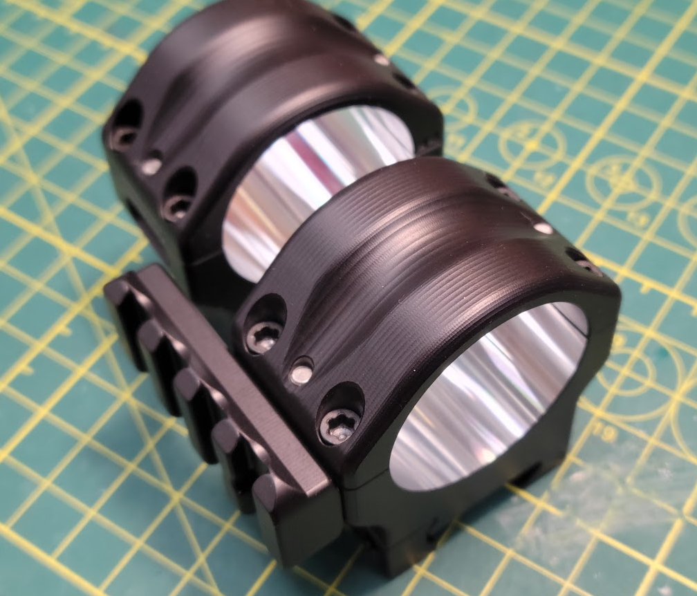

I don't but I also bought an MDT "blem/second" where apparently it has tool marks that were unacceptable in QC. I have yet to find them.
Like I said earlier, I think the rings are a work of art. I got the pic rail for them as well, for a Send It level. The caps are serialized, the tolerances are thinner than a sheen of oil, the finish is fit and stunning.
I'm not fanboi'ing Craig or Area 419 specifically, but the product speaks for itself. Area 419, as usual, knocks it out of the park.

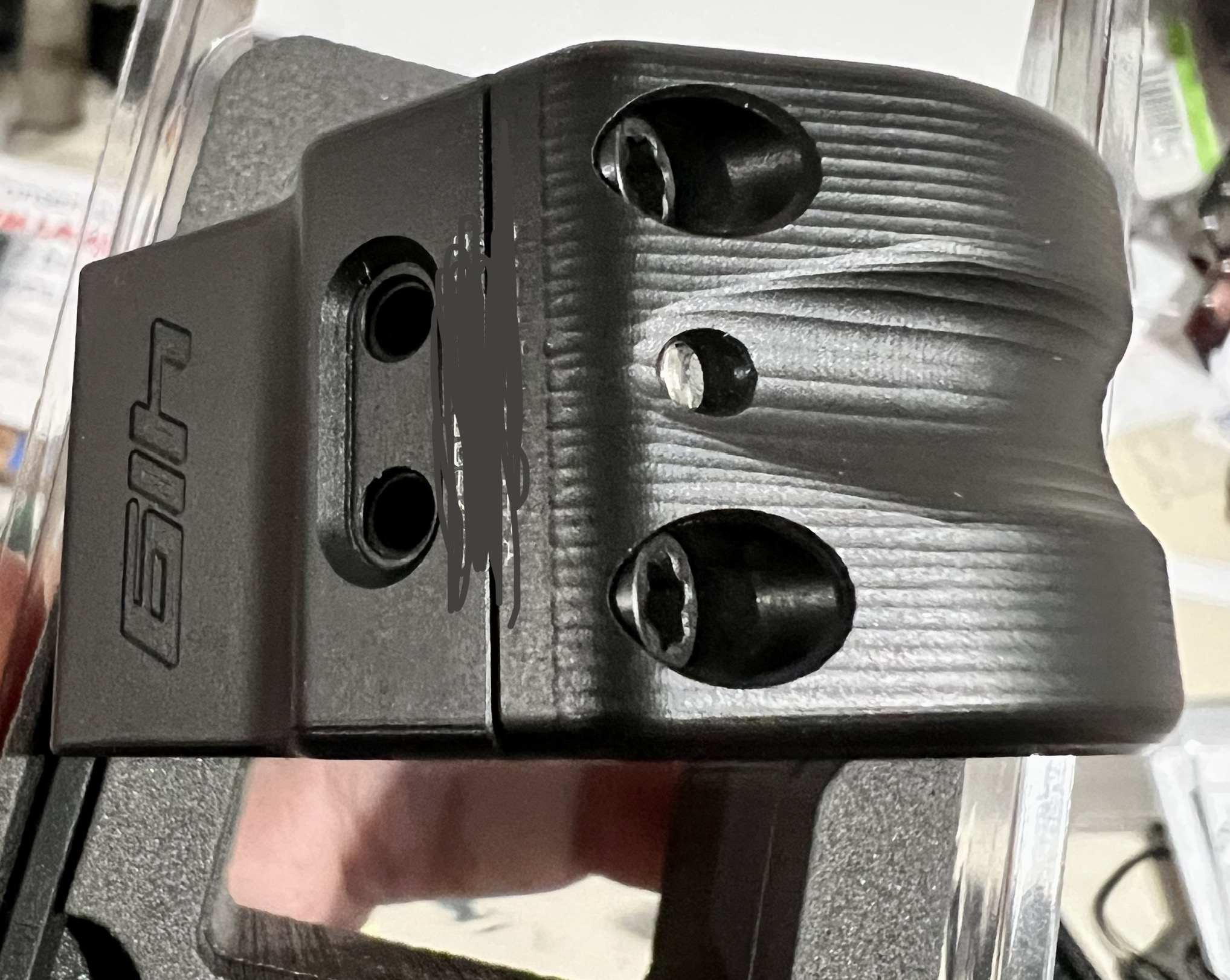

I’m not a huge fan of toolpathing.
Reactions: toader
One thing I can say I absolutely don’t like is the steel screw threads into the aluminum. Yeah for scope rings that’s fairly normal but for clamping jaws it’s not and probably the only ring/mount in my possession that threads directly into aluminum there.

The tool-pathing on top was an intentional design choice. Pure aesthetic of liking those lines to give the part some texture/character.
Also, the places the ano has marginally chipped or flaked on that chamfer, that's why the chamfer is there. Anodize is basically a hard candy shell, so to go back in and bore post-ano will cause that to happen in every situation we could muster, so to isolate and minimize it, we have that little chamfer to keep any chipping or flaking from being any larger than what you're seeing. You'll also see it happen where the insude wall of the bored ring meets the "flats" where the two halves of the ring connect.
