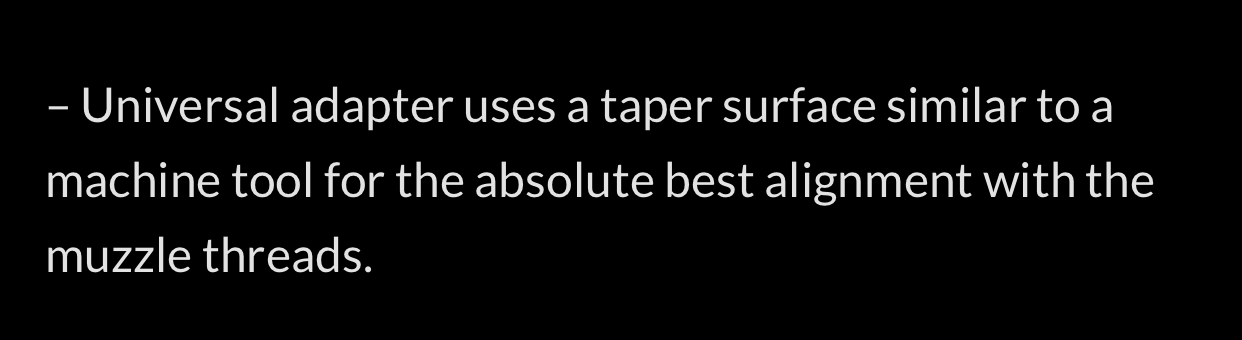

- The taper is no longer functional between the Universal Adapter and the A419 Suppressor Mounts.
- It is functional between the Universal Adapter and the Brakes.
That said, as I have said previously in this thread:
With good threads and shoulder repeatability is high. Most will never have or perceive a change.
That said, the goal of tapers to squeeze more consistency and repeatability out of a system - raising the bar if you will. What really didn't sit well with me is going from a taper system like TBAC and stepping BACK to a square shoulder defeating the purpose. Especially when investing in TBAC suppressors for precision rigs - these are signs one is going above and beyond to achieve a specific goal at tremendous expense. Those folks should understand the dynamics of the solutions they are employing and how they can impact the overall system and result.
I like my Hellfire systems, just surprised the tapers are not functional for suppressor mounts.

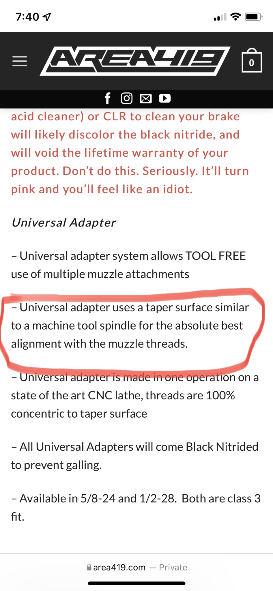

The issue is the whole point of the hellfire mounting system is that the brake and suppressor adapters attach to the hellfire mount via a taper. Ensuring best possible alignment and making installation and removal easier/threads won’t get carbon locked.
What’s been reported is the suppressor adapters taper’s are apparently just cosmetic now. But until it’s confirmed or denied it’s just here say. There is one report and pictures of one suppressor adapter being cosmetic.

So, the suppressor mounts don't interface the taper. Don't think I've ever said they do. They use our Universal Adapter, which ABSOLUTELY uses the taper for the brakes, but are interfacing with the large rear shoulder. They get real close to the taper (more on that later), and it prevents gross misalignment, and helps keep things clean, but the interface for the suppressor adapters is the rear face of the Hellfire Universal Adapter.
The core of the confusion comes from most people thinking that all tapers are the same. This is a point of ignorance that seems to be seeding problems. Basic lesson - there are "steep" tapers and "shallow" tapers both being used in the shooting world. These are separated in the 15*-20* included angle area. Larger angle, and tapers don't really lock. Smaller and they start to lock really hard. Nearly all you see in the consumer/shooting world are "steep" (Sig/Q is a good example at 25*. They are great for creating concentric seals. There are then "shallow" like ours, at 10*, which you'll also find in most of the machining world, and they are meant to create concentric grip. They also create a seal, but grip is the core function.
Remember seal/grip, it's important.
On our adapters the grip is needed to time the brakes we produce. The way those are allowed to work is the collar (this is also important later) pulls directly back on the brake, creating the seating force on the tapers. It's a patented method that works exceptionally well and many of you are customers because of it - thank you for that. The downside to this is that it requires that direct pull-back to get tight. If you tried to thread something onto that in one piece, like it were the Sig/Q or the TBAC or another that uses a taper seal, it would never achieve thread torque as the shallow taper would bite/grip and it would keep you from turning the device enough to create the requisite thread torque.
Our very first can mounts (maybe someone on this thread has one, but probably not, there were only a couple dozen made) actually looked like a Hellfire, with the collar on the rear. These interfaced the taper. The major downfall was the added length of this approach, along with weight and complication. So, like we tend to do, we started working on alternatives and seeing what performed to our liking.
What we landed on is what we have on the market today, with thousands of can mounts in use. It is a system that shoulders on the large square face of the rear threads on the Hellfire adapter, with a small amount (about .005" radial) of clearance at the taper interface. This had shown to us over and over and over to be very repeatable (as long as the can itself and the muzzle threads were true, but nothing in our mount system could possibly solve those issues) as well as shorter, lighter, and realistically more attractive.
We have not changed this design or its manufacturing tolerance since we released it in 2016. This isn't something we randomly did 6 months ago.

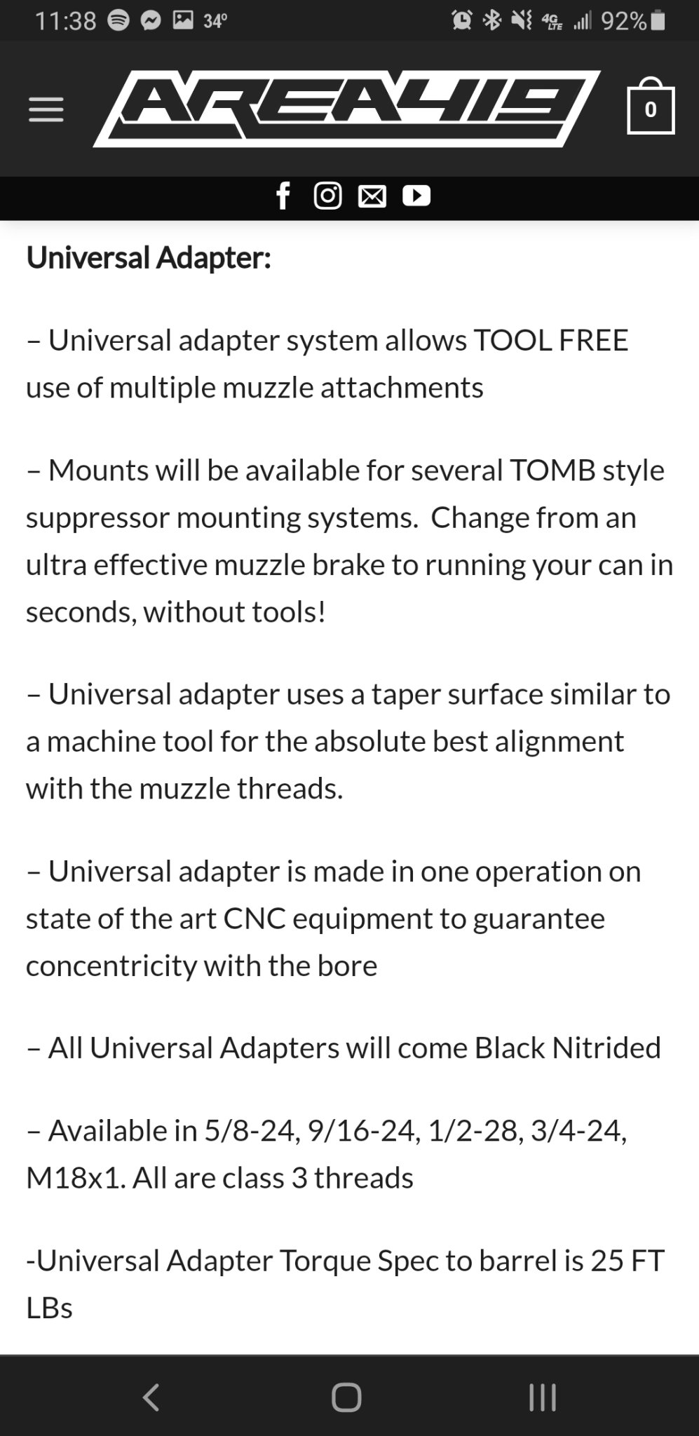

Sure, valid point. This is a direct copy/paste from the Hellfire Universal Adapter page, and has been exactly as shown here for years. I removed that bullet from all suppressor mount listings. Those descriptions had been unchanged for about 5 years, but always happy to accommodate. I'm mostly amazed that someone read deep into a description. Most don't read the first line.

What these adapters allow you to do is attach myriad products to the end, and it's all based around the idea that the inside geometry of whatever you're mounting matches the external geometry of this universal adapter and it's being secured to those tapers with these rear threads.
Area419

Account was made today, just to post this? Seems someone has a vendetta. Who knows. This is largely why a lot of manufacturers stay away from the forums.
Intentionally ambiguous and misleading language.
Then feign surprise... oh wow we never knew anyone thought these interfaced on the tapers. Calling bullcrap.
Your own words state that the system uses the taper to secure whatever may be attached to it.
I think my work computer was preventing this link from being posted, who knows.
This is the video:
"What these adapters allow you to do is attach myriad products to the end, and it's all based around the idea that the inside geometry of whatever you're mounting matches the external geometry of this universal adapter and it's being secured to those tapers with these rear threads. So, to mount a hellfire brake you're simply putting it on the end and tightening with this collar timing it as you'd like to pull it onto the rifle. It's very concentric and very repeatable. We then have other devices, like this is our linear flash suppressor. Which maybe doesn't make as much sense for my match rifle, but makes a lot of sense for a carbine. Or you can attach our maverick, which is built on the hellfire attachment system, or it's available with the big brother sidewinder. We have other suppressor mounts, so this is a silencerco omega that's set up with our hellfire adapter in the back, and we have hellfire adapters for crow suppressors, for thunderbeast suppressors, both their cb and their ba, for dead air keymo models, for sas suppressed armament system tomb mounts. We've got a lot of different models we're always adding models to that lineup that allow you to centralize your mounting systems around something that really does a good job of keeping things straight and true."
