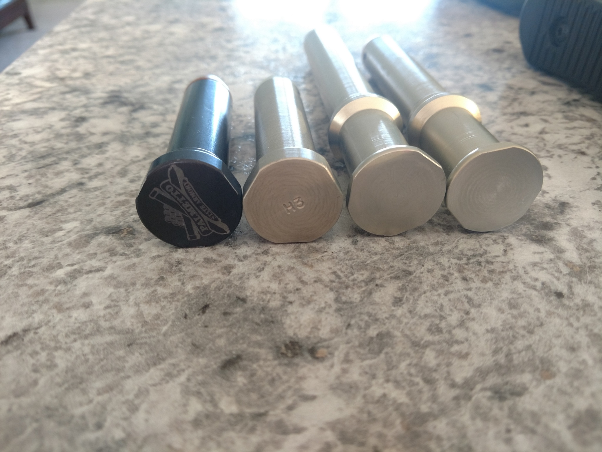

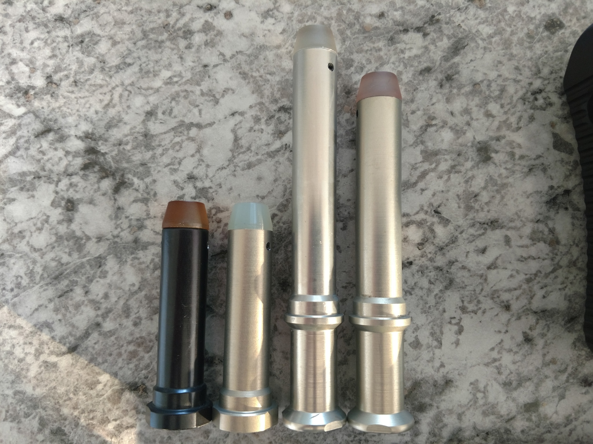

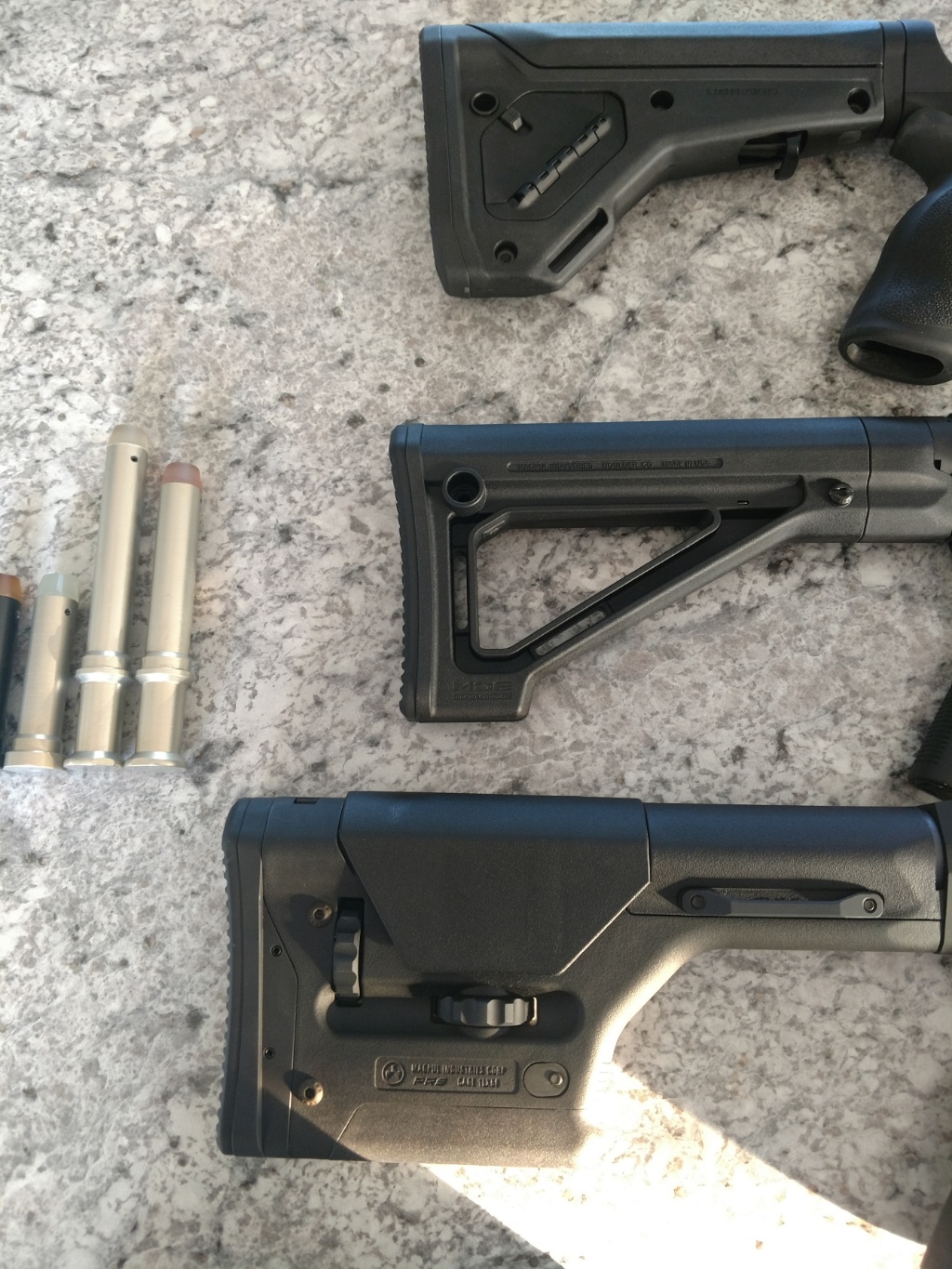

Measurements I promised
Understand when I reference AR10 I am speaking of ARMALITE
Here are some rough dimensions on the buffer tubes
AR15 carbine buffer tube 7.05"
AR10 carbine buffer tube 7.72"
UBR buffer tube 7.75"
UBR spacer 0.7"
RIFLE buffer tube 9.7"
The AR15 &AR10 carbine buffers are identical size but you will notice the AR10 carbine buffer from the armalite is a H3
The rifle length AR15 buffer is nearly 3/4" longer than the AR10 buffer
Left to Right
AR15 carbine buffer
AR10 carbine buffer
AR15 rifle buffer
AR10 rifle buffer
So to recap
Changing an AR10 rifle length system to a AR10 carbine system should include an AR10 carbine buffer tube (or A5 length system will be less than a 1/32" longer)
Then you will add a HEAVY carbine buffer to match original Armalite set up
Use the same spring that was used with the AR10 rifle buffer, as Armalite uses the same spring for both
