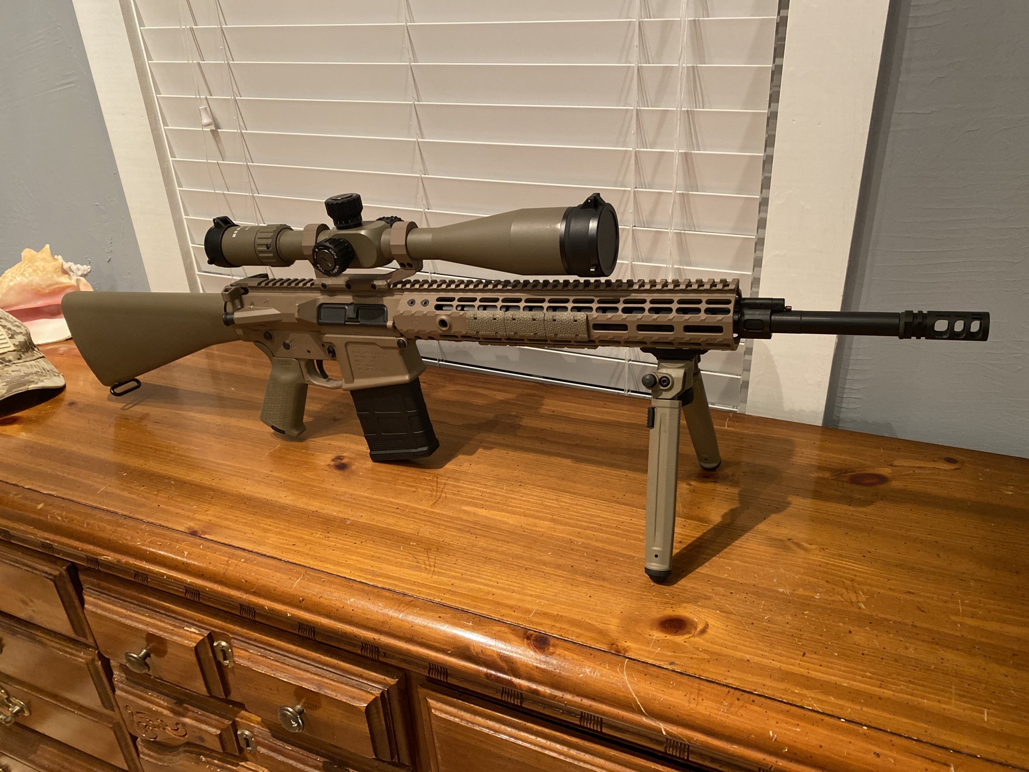

I built up an Aero M5 a couple months ago. Couldn’t be happier with it, but I used all Aero parts to finish it. Threw a cheapo scope on it for now, but it’s been flawless once I dialed in the gas block. Aero has a good bit of M5 stuff in stock. AR15, not so much.
Sweet that's the M5E1 upper how do you like it compared to the M5? I was thinking going that route as well.
Reactions: darkfader
Yea it’s the enhanced upper. It made barrel installation a complete breeze. Just torque the nut and the gas tube slides through slots built into the upper. Then the handguard bolts right up to the upper. No need to line anything up at all. I haven’t sent too many rounds through it but once I got the gas adjusted for locking back on an empty mag, it’s been flawless. I’ve got a few other Aeros. 300blk and a 5.56. I’ve been pleased with their stuff.

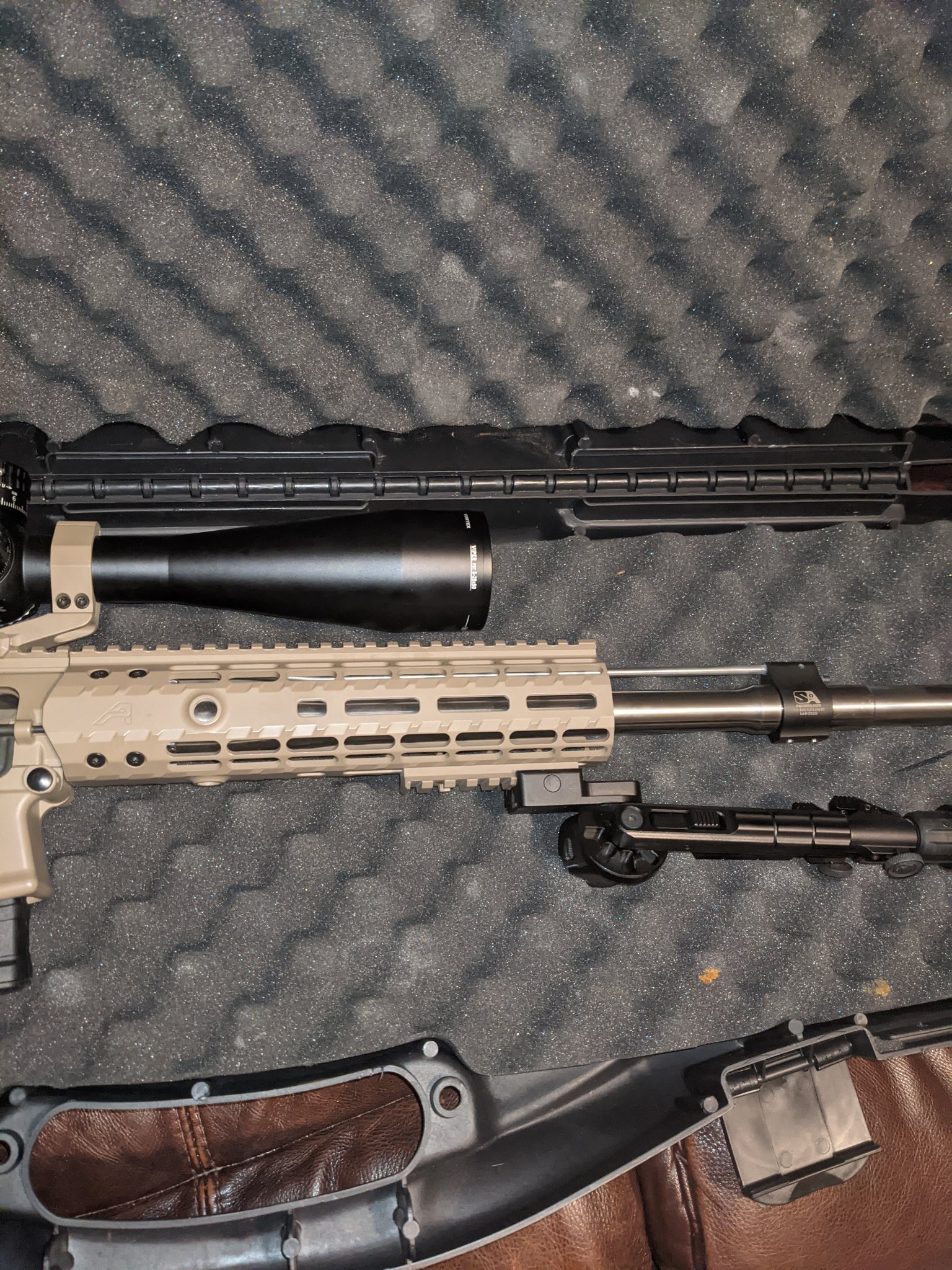

I personally like the non enhanced upper so I can install the super thin Atlas S-One handguard. But I do have one of each and they both work just as good as the other.

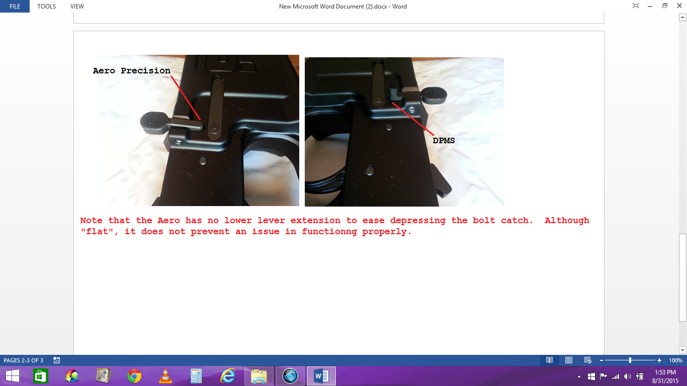

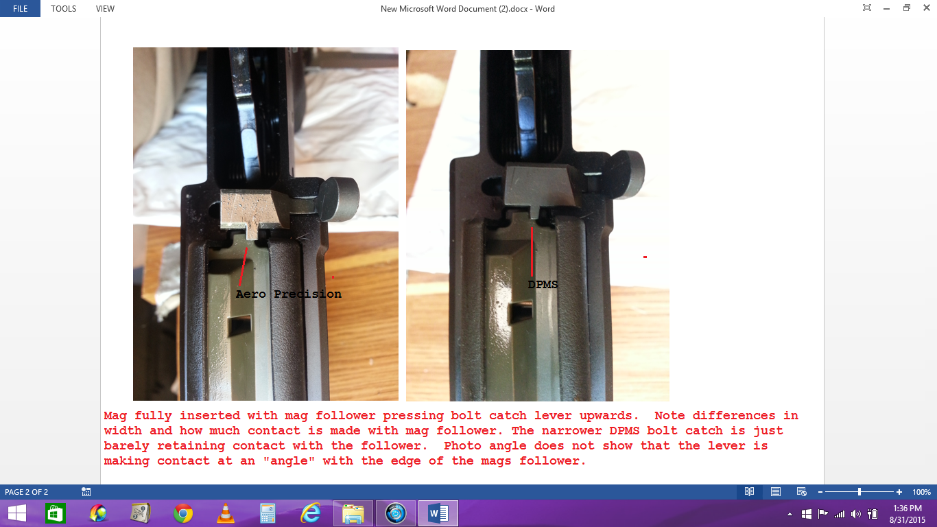

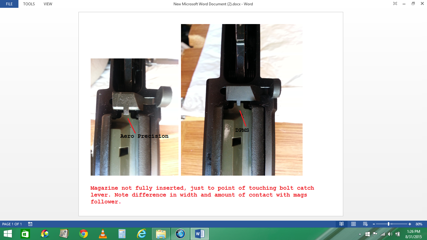

...something to be mindful of regarding "DPMS" compatibility...the 'compatibilty' claims can still have variations... these pics are from when I did my AR10 build a few years back. Since that time I always recommend folks doing builds on AP receivers to just use AP LPK's ...the bolt catch shown on right was a spare I picked up from Brownell's, which was listed as a DPMS "compatible" part..
agree 100% and ran into this very issue with a build using the same Brownells bolt catch
