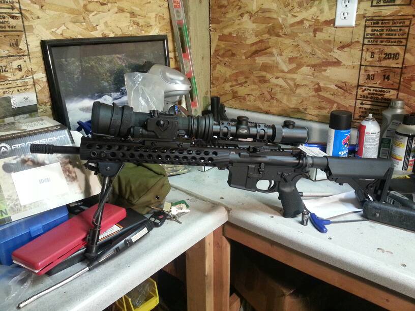

I have a Armasight LR CO Gen 3. I finally shot it last Saturday night on a Mega 308. It was shooting 1.5 inches right of zero at 100 yards. I removed it 3 times same point of impact to the right 1.5 ". I adjusted the Leupold mk 6 and shot a 2" 5shot group at 200 yards.
ETA pic its on one my AR15's. 8 power seemed about the best on the MK6. I havent shot on my .300 WM yet I'm
waiting on a Bobro mount so my scope can align to the clip on a McCree Chassis
