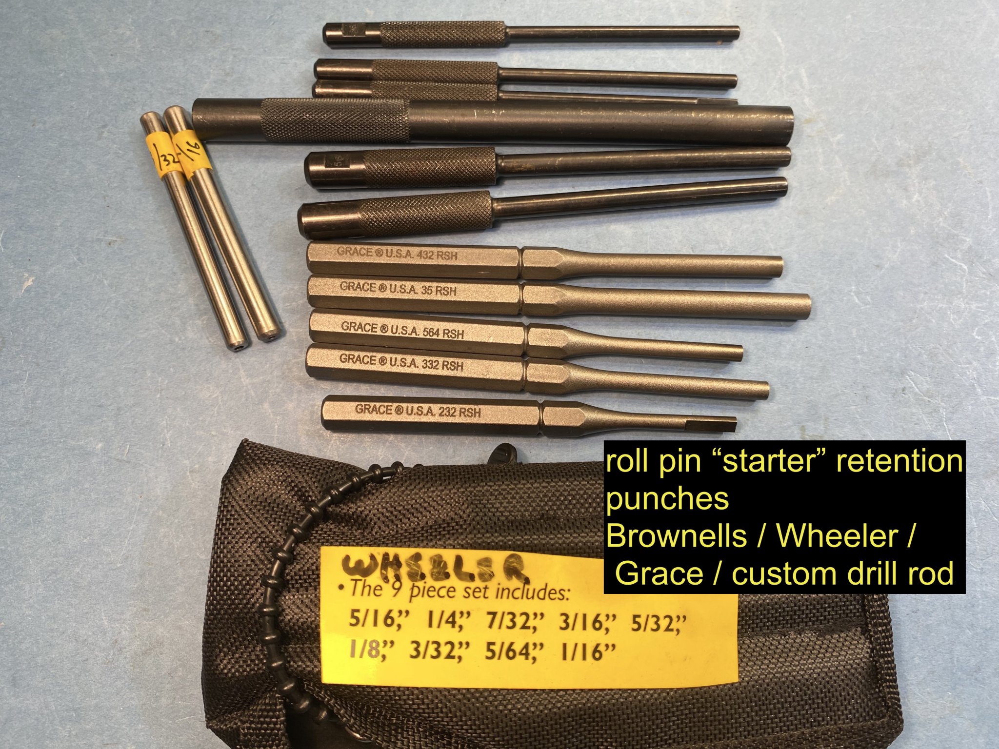

I have a Wheeler or Brownell's Punch set. The punches are deforming and the head on the hammer comes loose all the time. Just seeing if there are better sets out there that I can look at to replace this one. Thanks!
I just replace the wheelers. And loctite the heads in place.

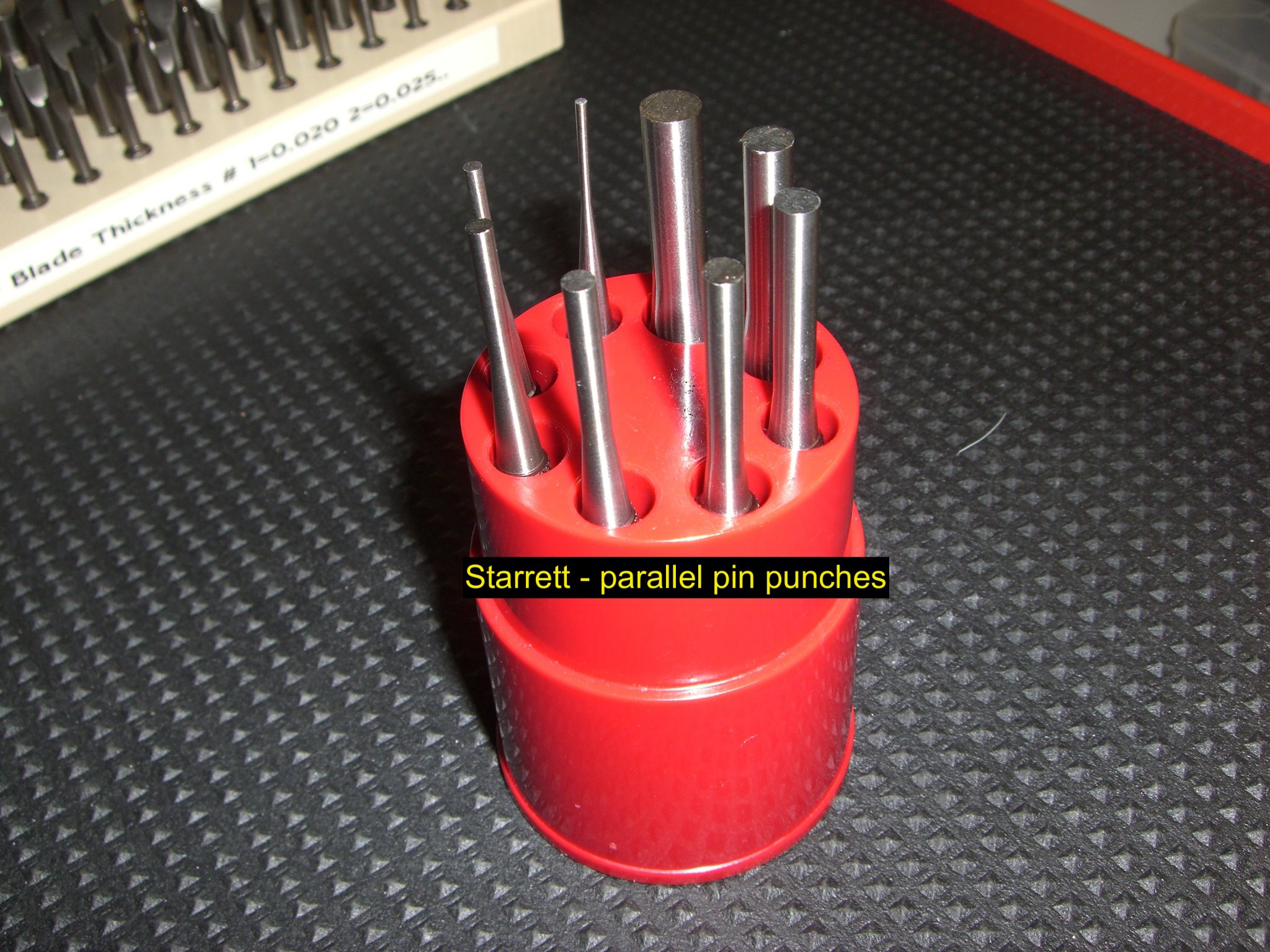

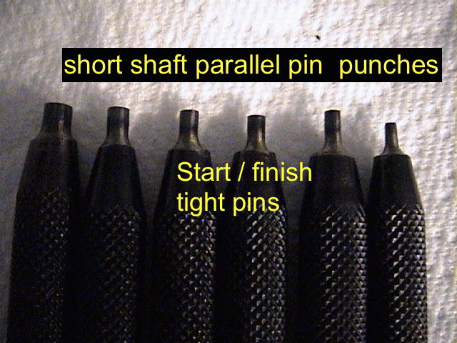

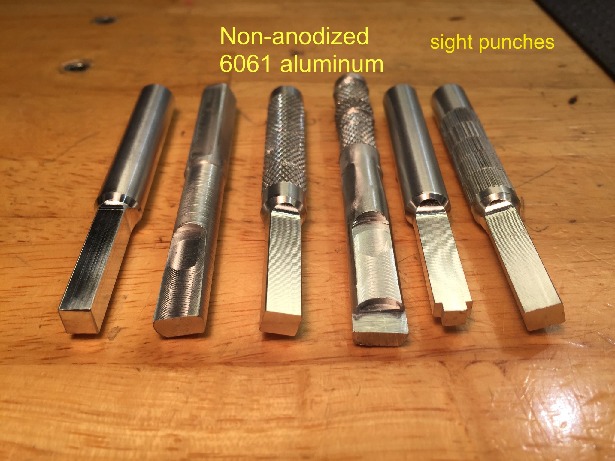

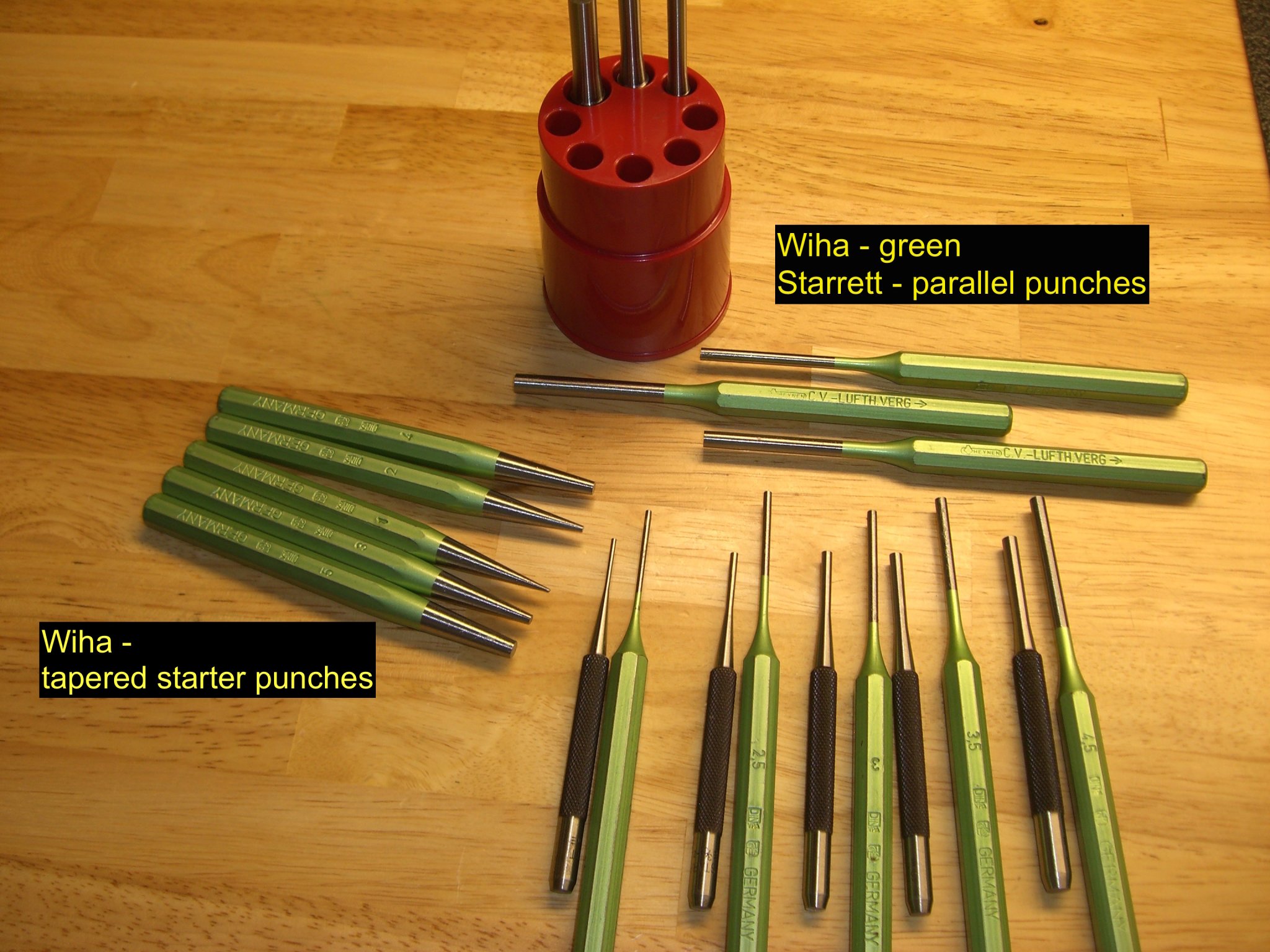

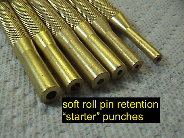

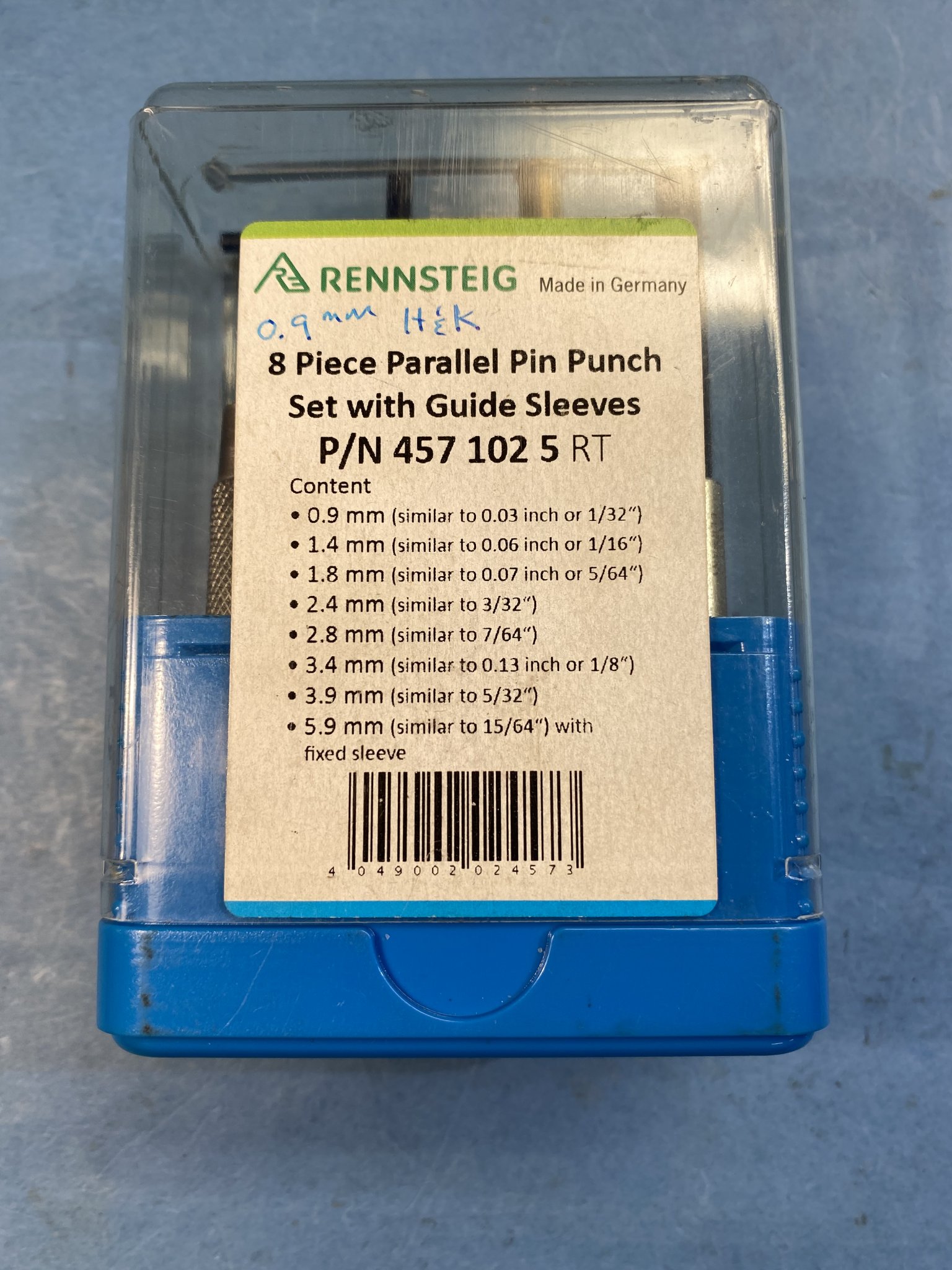

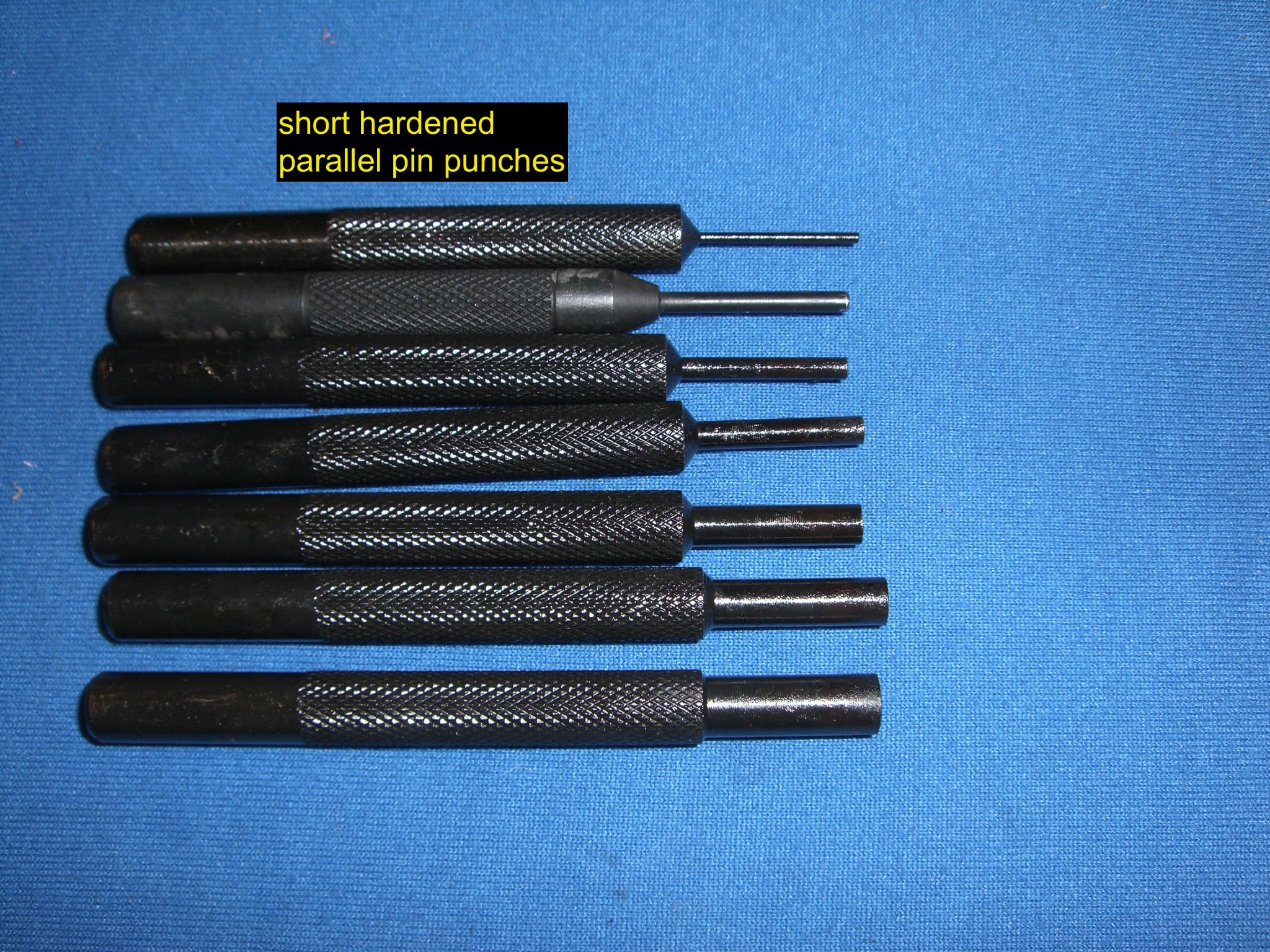

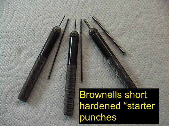

There are a number of different "punches"...parallel pin, roll pin, roll pin holder "starter", dome head , short parallel / roll pin punches "starters", tapered punches, etc.....Wiha, Starret, Grace, Lyman, metric v. imperial sizes, etc. can never have enough styles. Hardened steel, aluminum, brass, delrin, it's a pretty wide market. A few examples of the variety. What exactly are you trying to do with the punches ?
