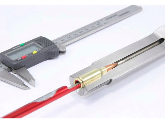

I've tried several times to measure my chamber, even purchased a Hornady OAL length gauge but i don't seem to get reproducible readings....and i've tried several times, gingerly. My best estimate after multiple attempts is an OAL of 2.8 inches using Sierra 168 grain Match King bullets.

Measuring OAL will just make you batty. Measure Ogive to Head (OH). Look at the the tips of your bullets, then measure their length. Inconsistent, right ? That inconsistency carries directly over to loaded round OAL. Your seating die presses the bullet into the case via the Ogive, not the Head.
are there easy and reproducible ways to measure both of these dimensions (distance to lands...and distance from freeborn to breach face) at home?

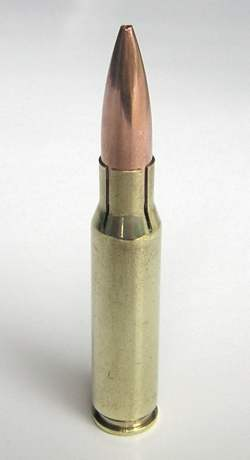

Yes. Simple and easy.
Full length size a case but adjust the shoulder length for zero clearance. Cut a slit in the case neck all the way into the shoulder using a dremel or needle file or similar. Stick a bullet into the neck and push the case into the chamber until you feel the case bottom out. Then push out the round with a cleaning rod and measure the oal.
For distance to the lands you can use the slit case 918v discussed, see how far the bullet slides into the case when chambered.
The cleaning rod method
the hornady OAL tool
Your chamber itself
Your chamber itself is really only with a sinclair gauge or similar
