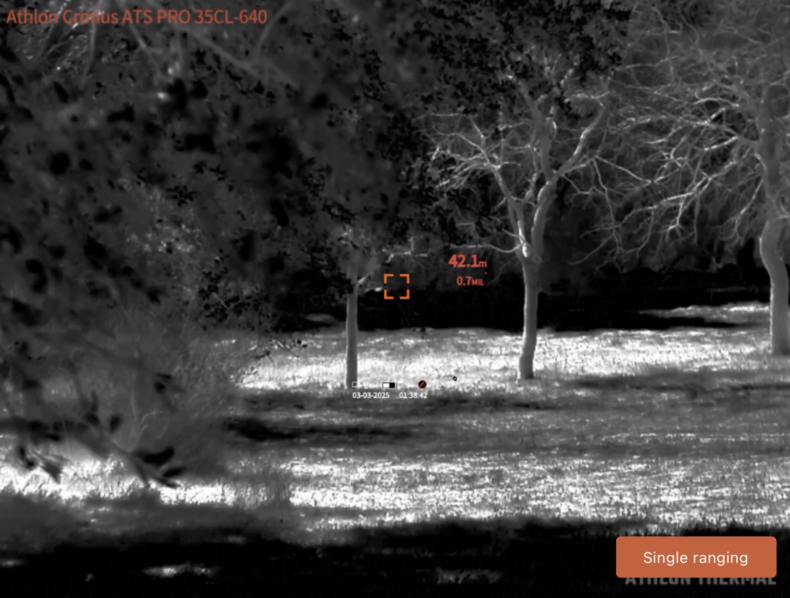

Question for those that have the 640 clip on. I received mine on Saturday, finally got a chance to mount it yesterday. Is there something specific I need to do to turn on the range finder? I short press the down button, I get the orange square box but only get 3 dashed lines and “yd”. No range numbers.
I’ve tried adjusting all the settings in the range menu, even factory reset, but cannot get any range numbers.
I have a call into Athlon support, they’re looking into it on their end, waiting to see if it has to go back.
Just checking to see if I missed anything obvious.
Thanks for any help you all can provide.

I believe you short press the down button to enable the rangefinder then another short press to actually range an object?
Edit: not home to verify mine just going from memory lol
Reactions: Sjh2429
It might be, but I’ve tried all combinations of short/short short/long long/short and long/long. I can’t get anything to work.
Still waiting on Athlon to have their thermal specialist guy call me back.
Weird is the word for it. Changed batteries. Reset it to factory again a second time. Turned on the ballistic app. Short/short press and lookie there, distance numbers, and ballistic dope. Shrug.
Or I could be just goofy and didn’t do it right the first time.
Have to keep an eye on it, see if it reoccurs.
Thanks for the help all.

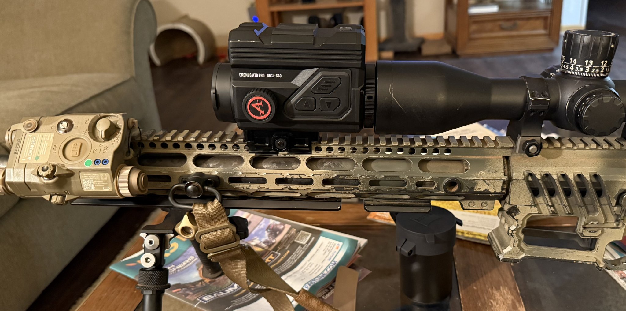

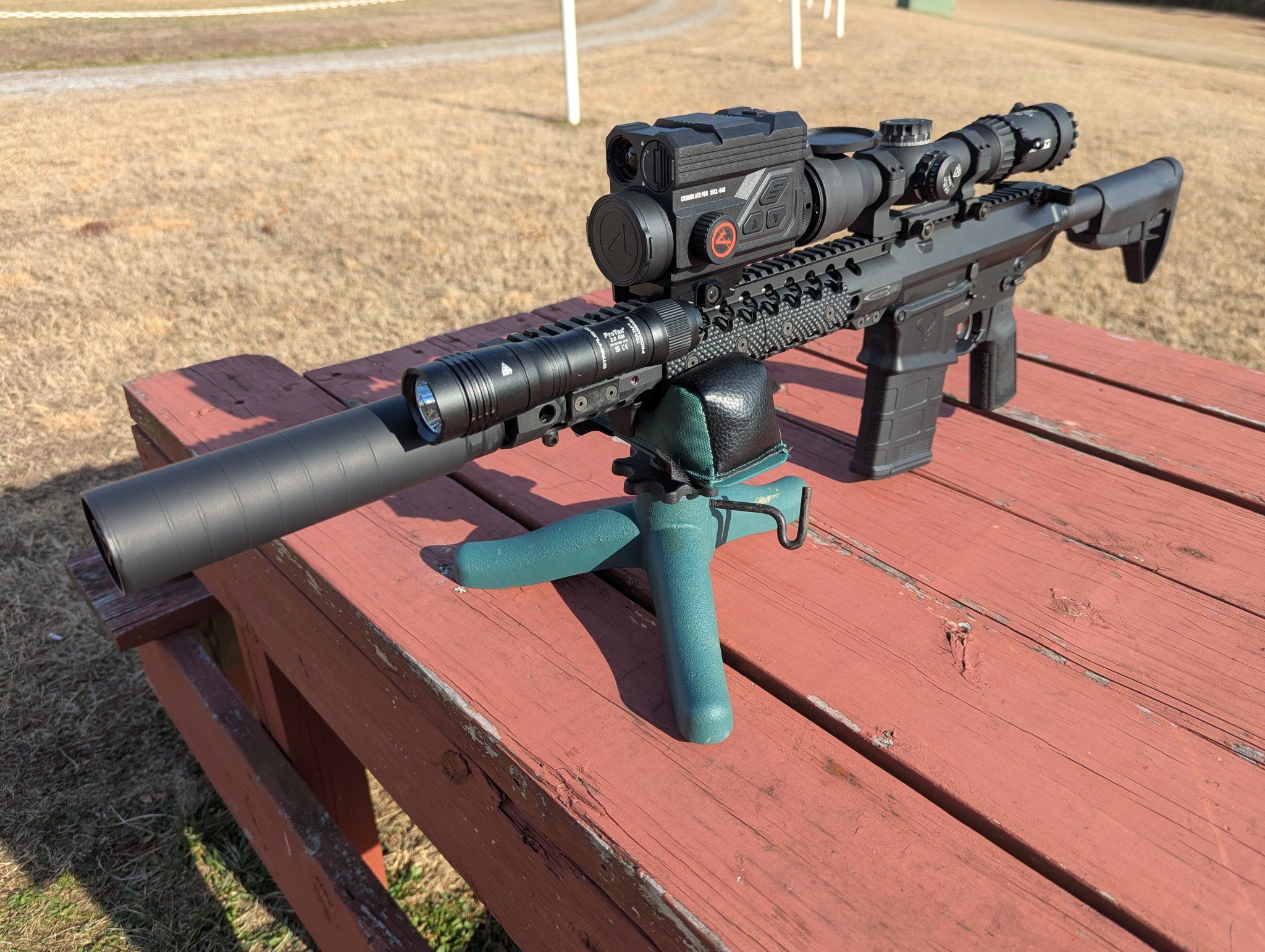

Finally made it out to Ranch for the weekend but 30+mph winds not the best for trying to zero and shoot coyotes/pigs tonight. May get some pics at least to show performance in wind/dusty conditions.

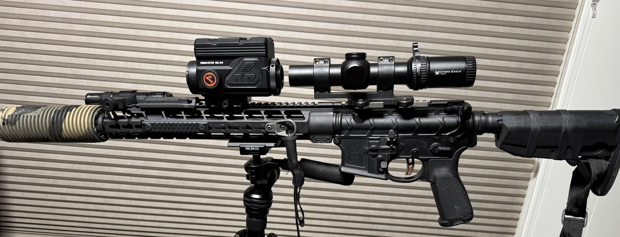

Trying to work through issue with a non spec AR rail. MI handguard on my 6.5cm AR10 not wanting to cooperate. Screwed down clamp as much as I can to the point it’s difficult to close, but thermal still wiggles. Would probably benefit from an ADM mount or other. Not sure I trust the Chinese mount. Can shim with electrical tape but wouldn’t trust it, and not a permanent solution.
Mounts fine to my MCX, so worst case can just use that tomorrow night when weather is better.

Ok. Got it zeroed on both rifles today. The instructions in the manual are dogshit. Also didn’t help that I started with the AR10, which has a Zeiss S3 4-25 on it. Really hard to see the menu items when unit is on 1x base, and scope is at 4x base mag. Fumbled through it and got zeroed after some choice words and a few breaks to walk away and breathe before I lost my temper.
On the MCX with the Helios 2-12, much better experience. Really helps being able to put unit on 3x base, and rifle at 2x to be able to read the damn icons, and see the small hand warmer at 100m. That scope and reticle is just about perfect for this clip on.
Remounted to the AR10 to confirm zero/repeatability, especially since I had to shim the rail with electrical tape, and it was still good.
Emailed Athlon and ADM last night about any potential upgraded mounts, and will post here any updates I receive.

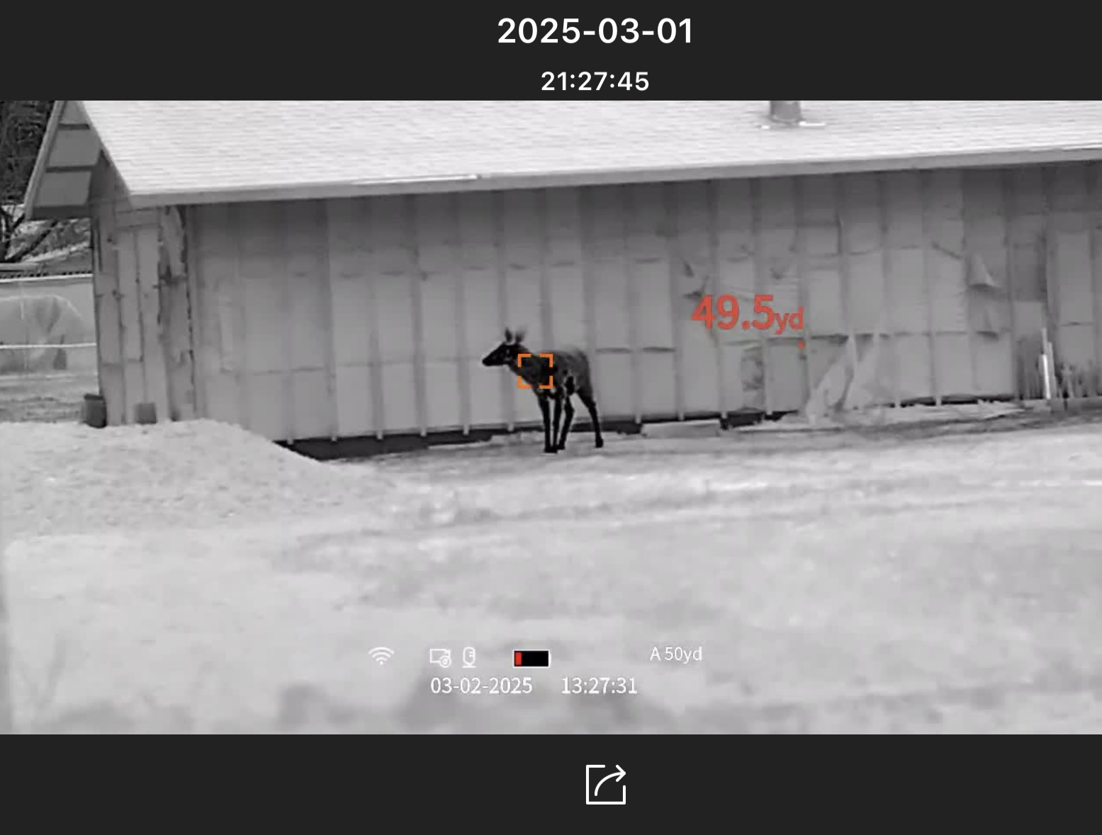

Not bad. At what range are you able to distinguish between types of animals, i.e. canine vs cattle vs deer?
That’s a tough one. I’ve been using thermals for over 25 years, whether in the military or for hunting. With experience you can ID stuff much better based on temperature, movement patterns, and shape. My almost ten year old pulsar 384 scanner is still what I primarily use to find animals, and can usually figure out what type of animal it is within 30 seconds out to 800m or so. Where I hunt is mostly open country (West Texas) which also makes it much easier vs hunting in dense foliage/forest. Ambient conditions will also be a factor on range.
For me with this Athlon I would argue realistically out to 1200m to distinguish type of animal using 4-6x of scope magnification. Probably even out to a mile.
If I handed it to one of my kids they’d probably be able to reliably figure out type of animal out to 500m.
But, that is for type of animal, such as it is a canine. If I needed PID to the extent of coyote vs neighbors dog (which I luckily don’t have to worry about), I wouldn’t be shooting with thermal. Scanning yes, but I’d opt for good clip on IR device with a great illuminator.
Sorry for the novel but hope it helps.

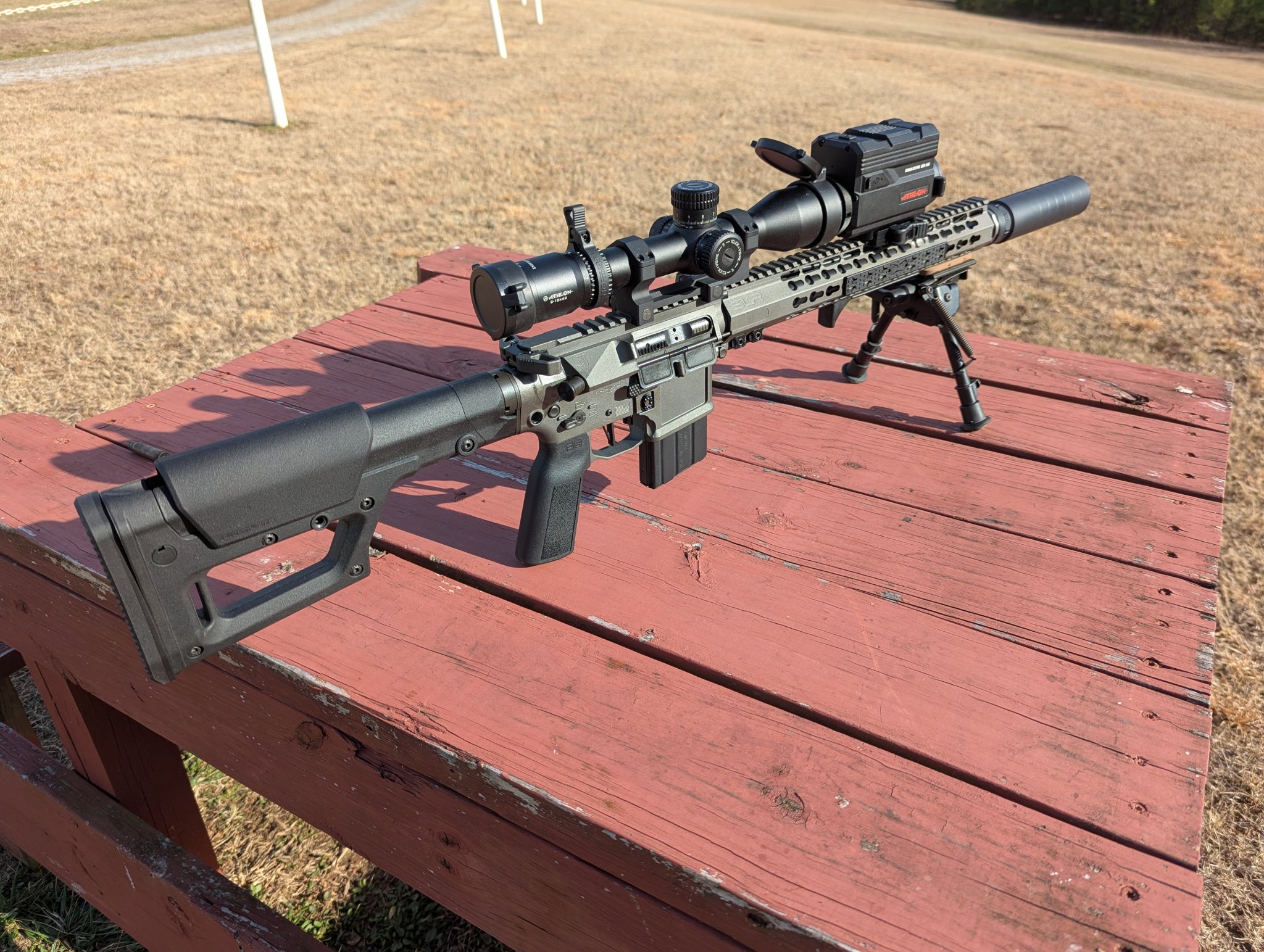

Just a heads up on fitment of this clip on if anyone else is running a Solus action in a KRG Bravo chassis... The KRG backbone NV mount is a quite a bit taller than the actions integral picatinny rail. I took some measurements and instead of buying a set of super high 34mm rings I found a .490" riser from Precision Reflex. It's meant for AR10 upper receivers but it's almost the perfect length for the Solus' integral rail. Combined with my APA 1.125" rings the alignment is almost perfect now. Thinking about adding a cheek pad of some type so the cheek piece isn't almost maxed out in height lol
What bipod is on that rifle?

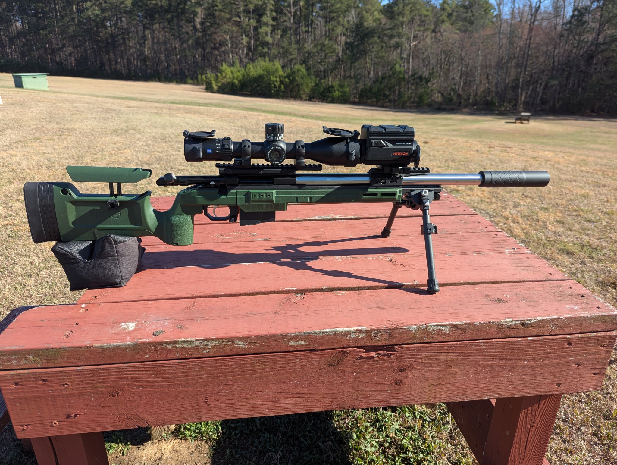

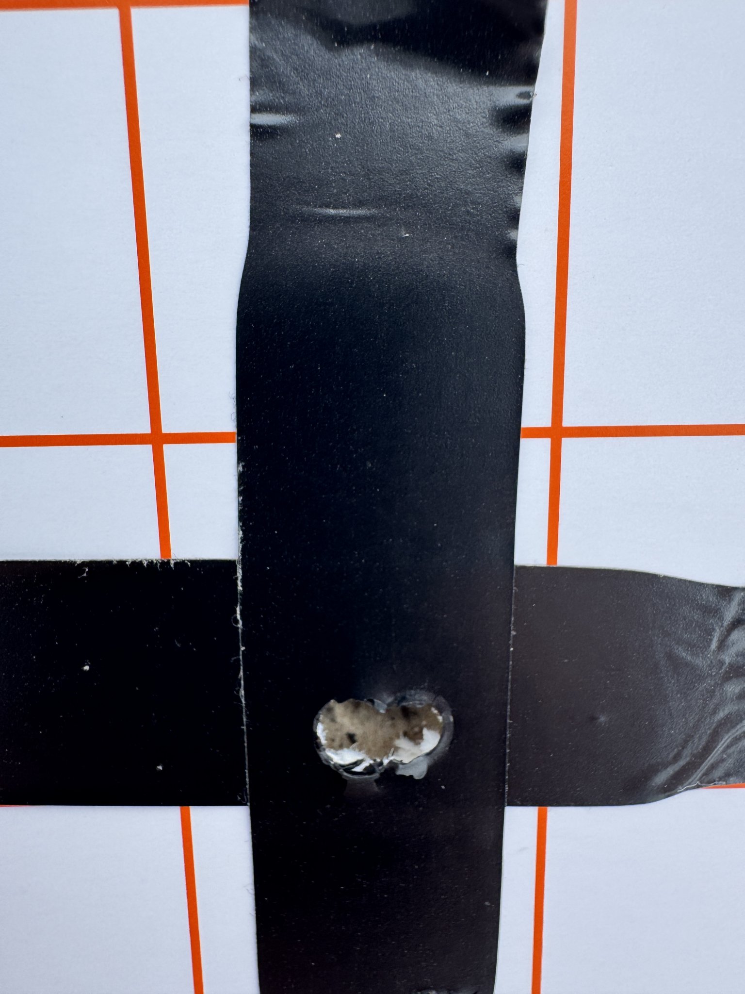

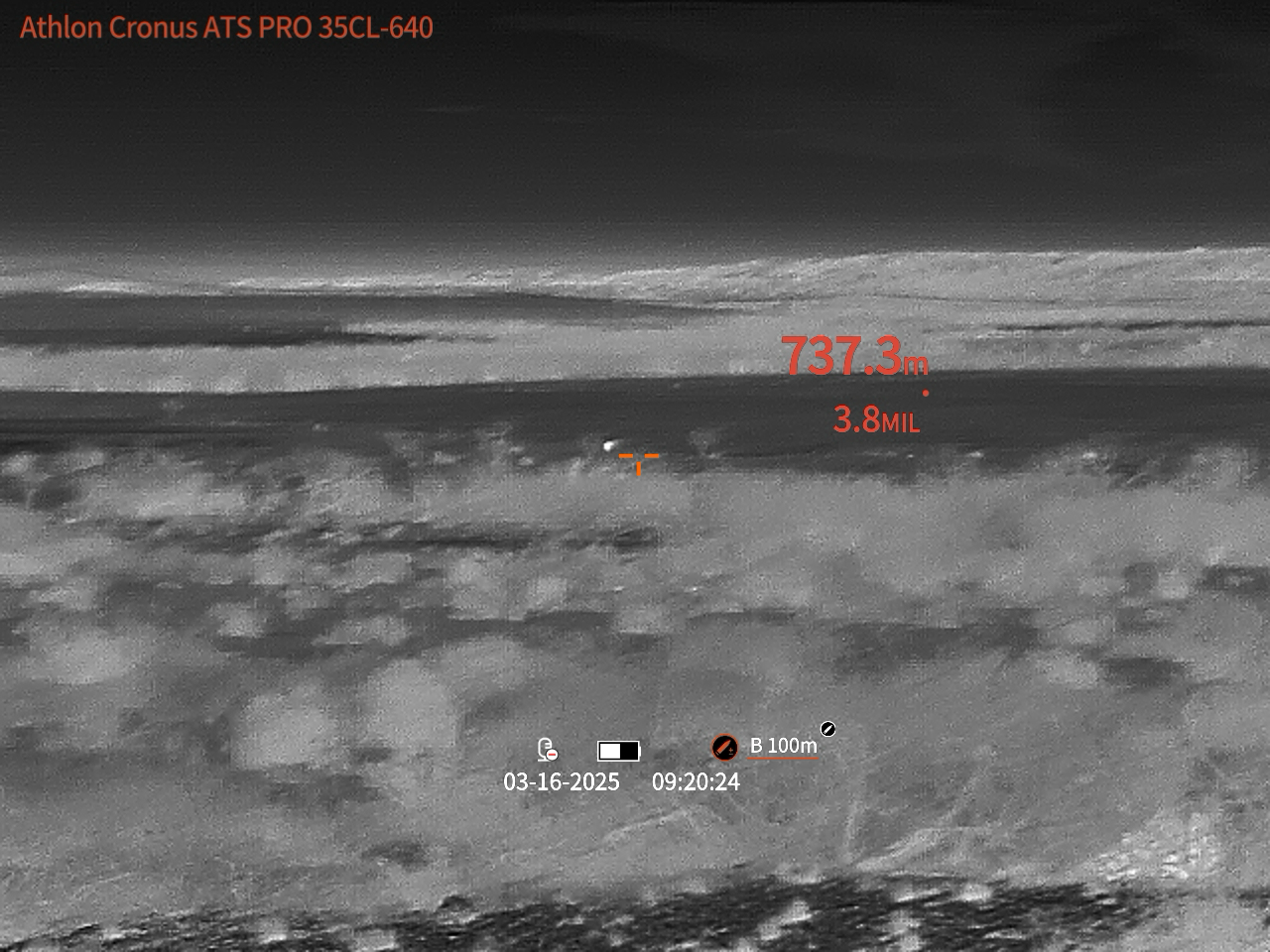

Only had time to reconfirm zeroes on my 308 & 6mm MAX since switching suppressors & do a quick and dirty collimation with the clip on so far... I'm pretty impressed with this little unit for sure! I'll echo @smcfarland on the useful magnification range as well, I think 6X is a good spot & 9-10X starts getting pretty pixelated. Collimation took one round of each 308 (1 "click" up & no windage) & 6mm MAX (1 up & 2 right). Super simple & the rangefinder is spot on, ranged 119.3 yards on a verified 119 yd plate. Will download the app now & try to get some images later tonight both from the app & through the scope if I have time.
Plate pic was the collimation shots immediately after clipping the unit on the rifles, 308 center & 6mm MAX a touch right.
Could you or someone walk me through the buttons to press to get to the collimation screen in the menu? I read the manual and it doesn't even mention collimation.
Thanks.
Collimating means zeroing. There are steps for the zero procedure in the manual. They aren’t the best but should be good enough to get you through. If you are using a scope with any kind of magnification greater than 2x on the bottom end, make sure the menu buttons are on 1x zoom, otherwise you won’t be able to see the menu items. Also make sure you have your appropriate rifle and zero distance selected or the ballistic calculator won’t be accurate after you set it up.

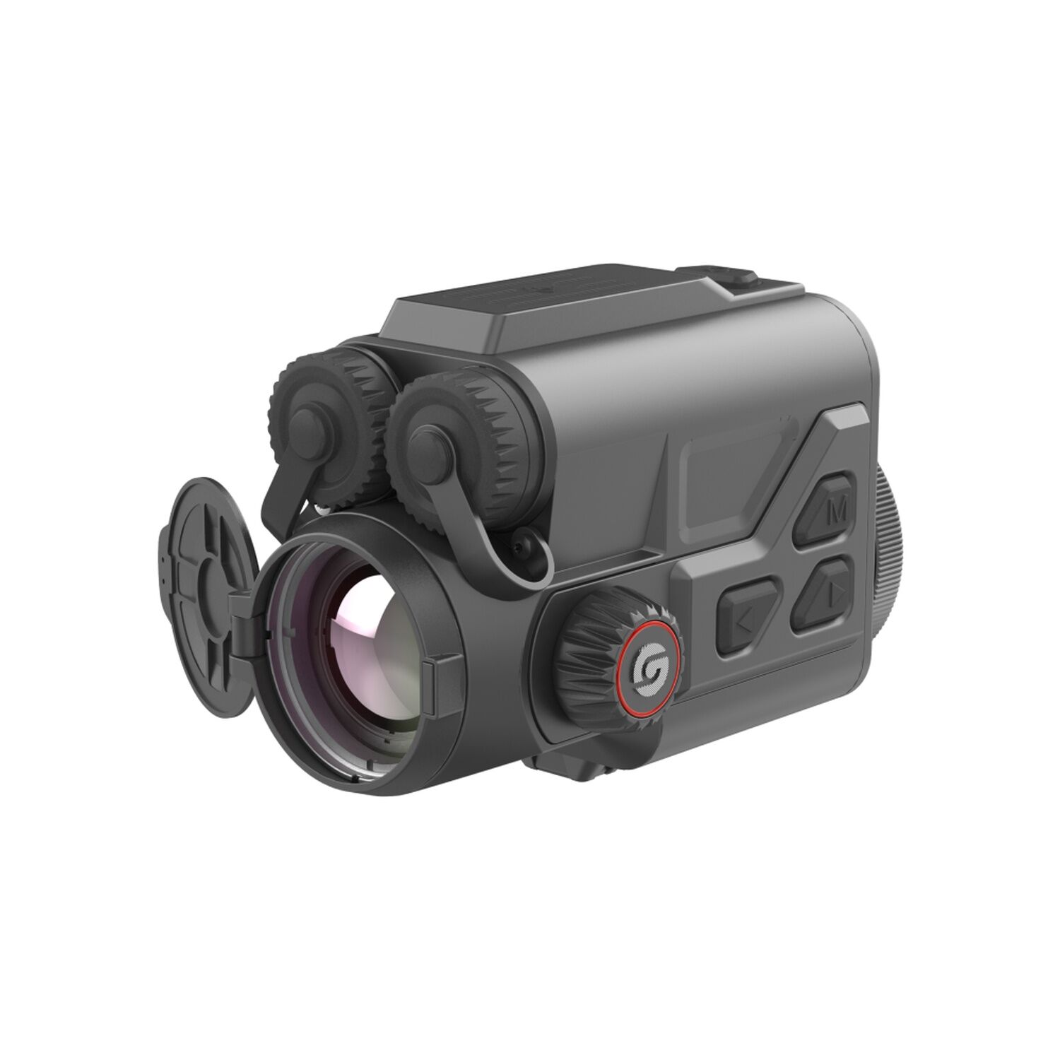

Are the mounts for the Athlon and Guide proprietary? Has anyone tried making any fts mounts work?
Yeah it is proprietary, it's pretty wonky too. Was trying to 3D print a conversion to go to a wilcox flip up, but the screws are located in a wonky position. Guide has stated that they're coming out with the FTS option soon, but the mounts in general are pretty bad.
Someone needs to make something for this unit. Would be amazing.
If Guide could make a QD mount for the TB1250 it would cement me buying one no question. Someone made a 3D printed picatinny rail mount but I'd like an ADM style QD mount
Won't happen without the cantilever unfortunately. Not studs on the bottom to mount to.
Unit really shines with a Rusan adapter though, which kind of sucks at the same time.
