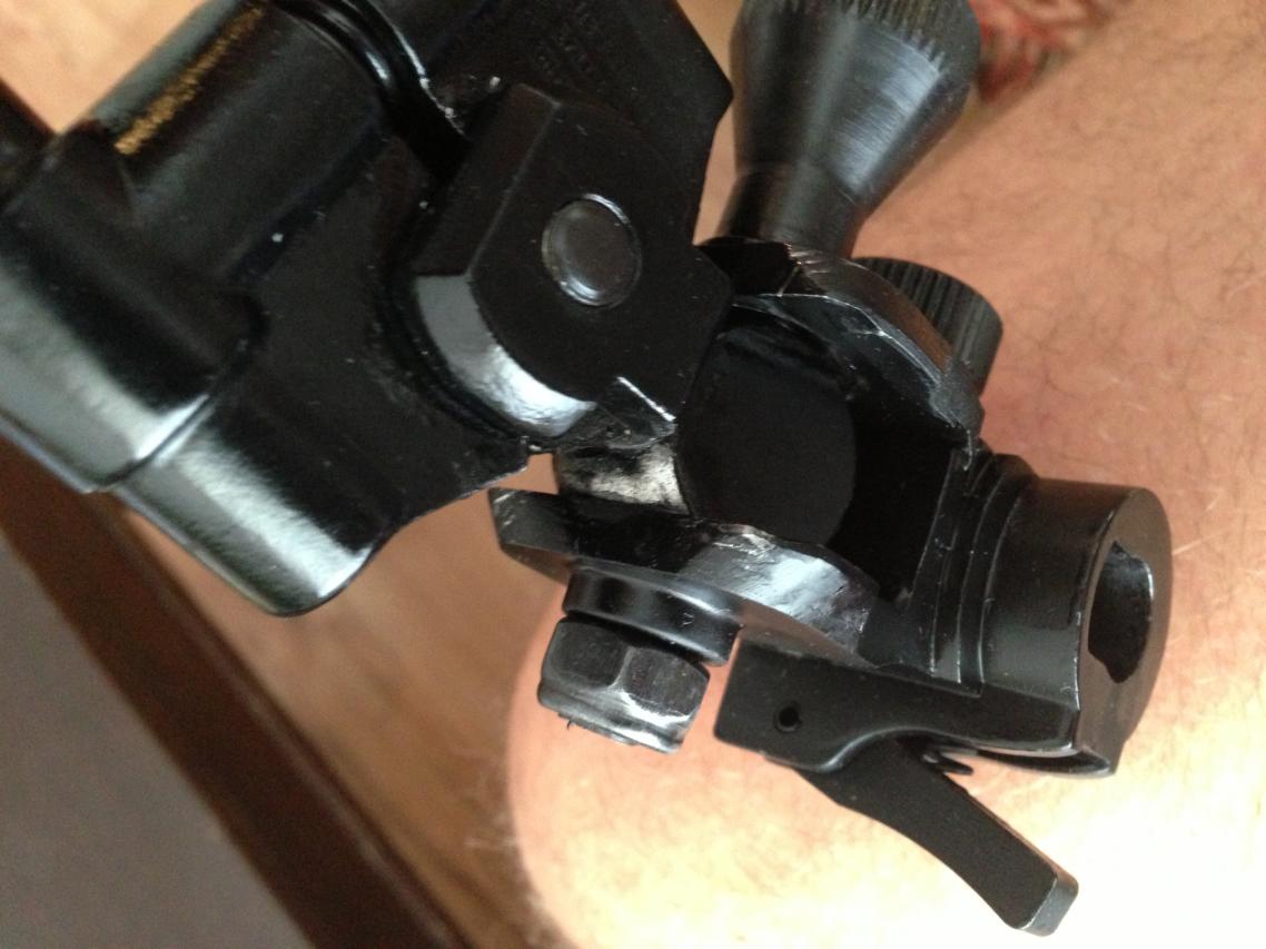

Firstly I want to point out how disgusted I am with the Versa Pod line of bipods. It came on the Steyr SSG 08 rifle.
I can't believe that before shooting, the black coating of the bipod is completely worn off and I can see the metal beneath it, and there are tiny metal particles all over the place cause by the friction. Terrible construction on that bipod. It looks even worse in person. And the other side is just the same!
So I want to change it. I have looked at the Atlas bipods and they look nice. Any experience?
Secondly will they fit a Steyr SSG 08 which has a Spigot fixed to the stock and not the typical swivel studs...
Best regards,
Nico.
I've got 2 SSG08's, and agree 100% on Versapods.
Mine have both had Atlas bipods for a few years now.
I removed the bipod spike by removing the L&R stocks on the forend (just remove the screws) and driving out the roll pin.
Then I added an AFAR kit to the Anschutz rail and mounted a rail mount Atlas (either version will work).
http://www.triadtactical.com/AFAR-Kit.html
You could also mount a Harris w/ a rail mount on the AFAR, or any rail mount bipod.
I have multiple Atlas bipods, they are my favorite, but I still have a few Harris's around.
The AFAR kit is easy, cheap and good quality, also it doesn't require permanent modification of the rifle.
The SSG-04 comes with Harris, the SSG-08 (.308 and .300) with Versa Pod, while the SSG-08 (.338LM) with the Fortmeier.
So, I sold the Versa Pod and purchased the Fortmeier and never looked back. Best bipod out there in my experience.
And it's ready to go, no mod at all. Highly recommended.
