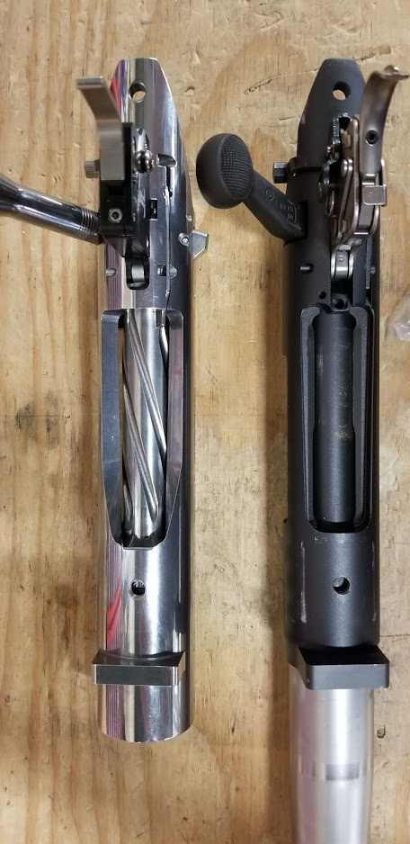

    Left is a Defiance Deviant Elite and right is a standard R700. The Defiance is cut out for AICS and AW magazines and you can see has a large 45*-ish bevel on the underside, however the action design was intended to have this implemented from the factory, the 700 was not. In saying that, I know a few friends in WA who have 700's that have been modified to take AW mags, so it can be done.
    As for the precise measurements, I am unsure of those, but I hope the picture helps illustrate how much material needs to be removed.
