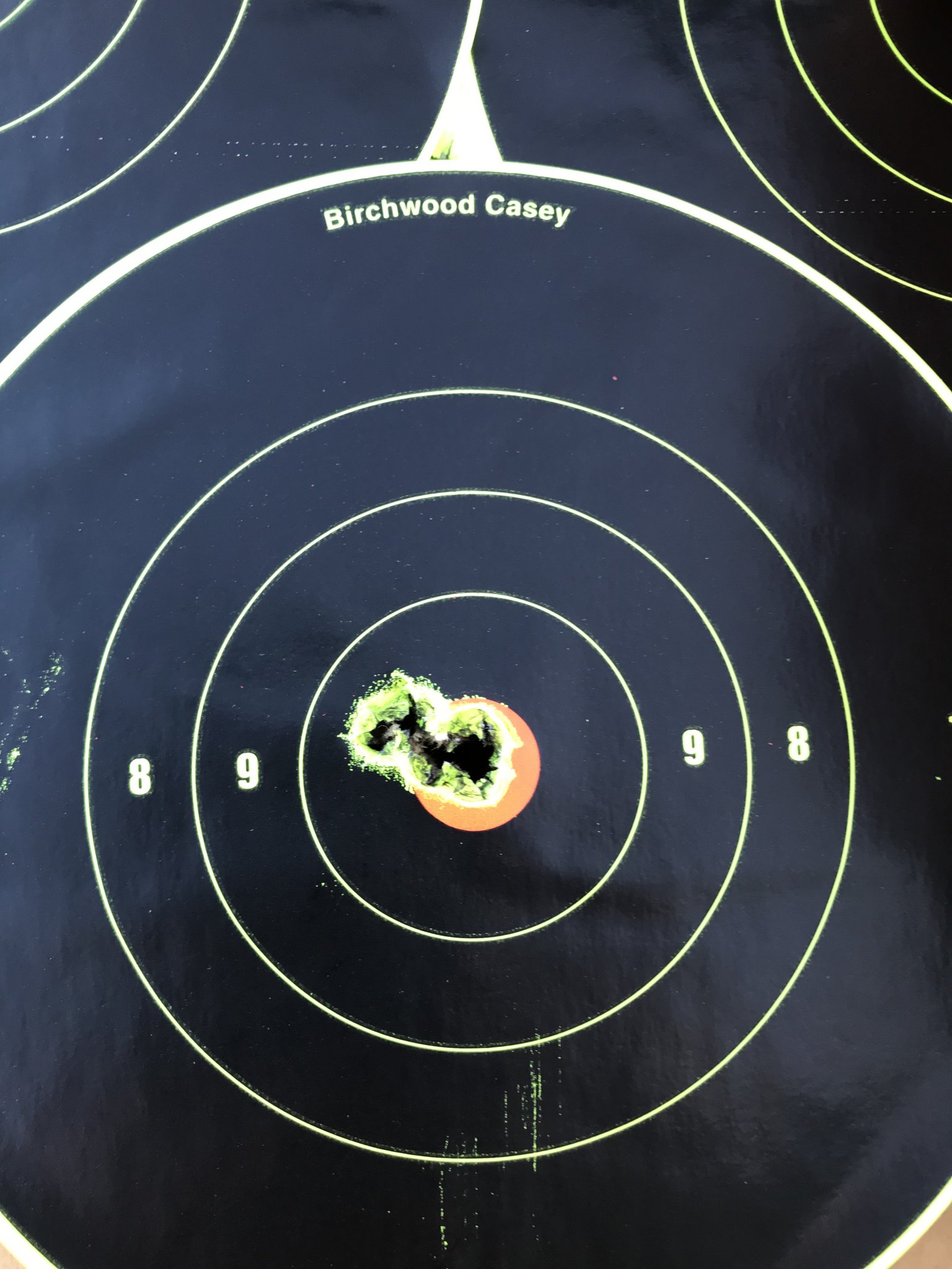

    Just got back from the range. Thanks again for the load data. It hammers in my rifle! 5-shots @ 102y. Time to take it out to distance.
