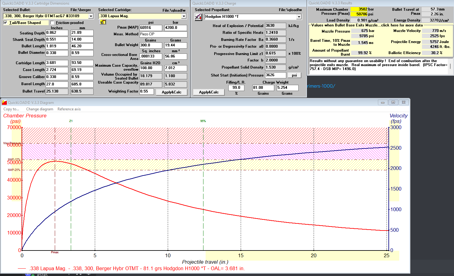

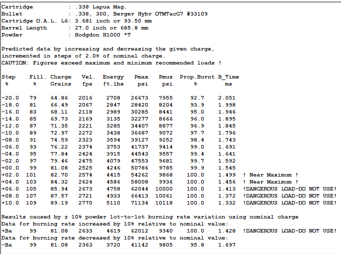

Consulting load data from Hodgdon's Reloading Center is a good starting point, but in the meantime, this is what Quickload says about that combo.
