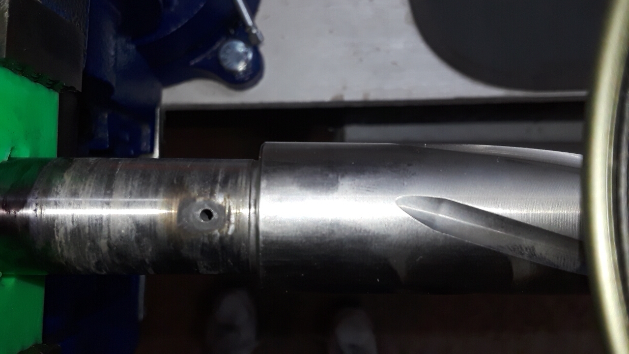

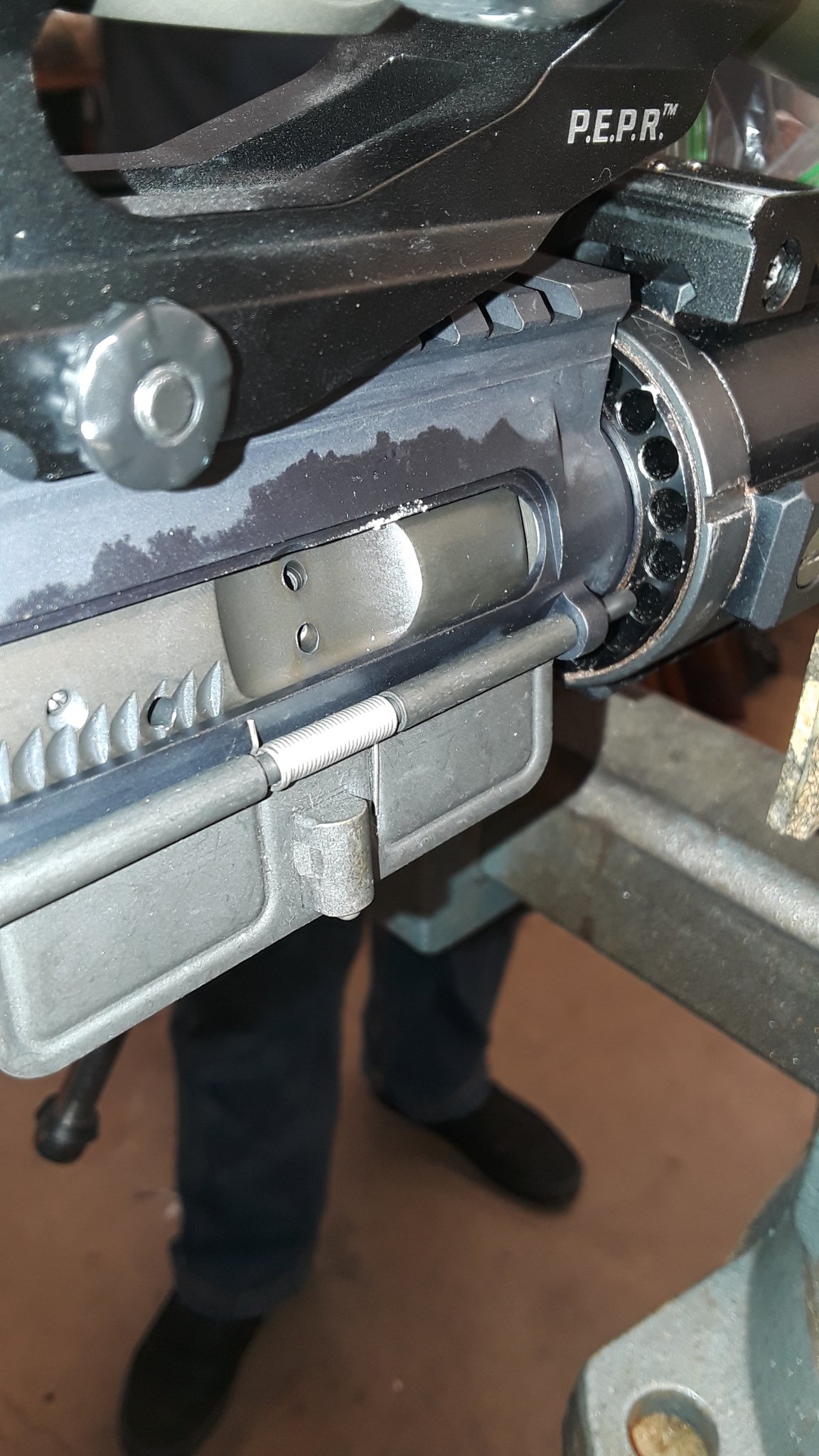

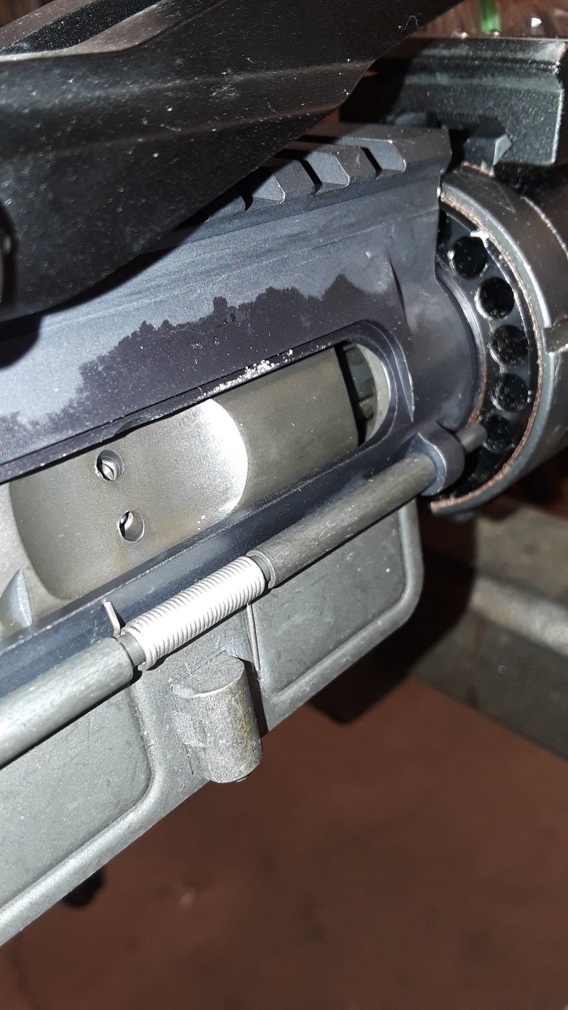

    I wouldn't pull the entire gun apart if you're confident the barrel nut was properly torqued.
    I would start at the gas system, you shouldn't have to pull more than the hand guard to evaluate it. Start by finding TDC of your barrel and make sure your gas port is TDC too. Then use a straight edge down the middle of the barrel on top to put an alignment mark on the shoulder just behind where the gas block sits to indicate the center of the gas block. Then you need to do the same on the rear of the gas block based on the port so you can clock them together. Then find the distance off the shoulder to the center of the gas port, and do the same off the rear of the gas block to find distance to the center of the hole in it. Figure what the difference is between the two and you can use feeler gauges between the gas block and shoulder to set the correct distance and get everything centered up.
    That's the first thing I would try.
    Dissasemble and inspect of gas block position and gas port.
    Port is 1/16 + diameter, could not find precision number drills to try. Resources found said 1/16 is standard for carbine gassers.
    Carbon fowling confirms gas block was centered and no leaks / obstructions found.
    Guess bcg coming apart for second inspection.
    Black on outside of blocks footprint was marker for measuring, was clear.
