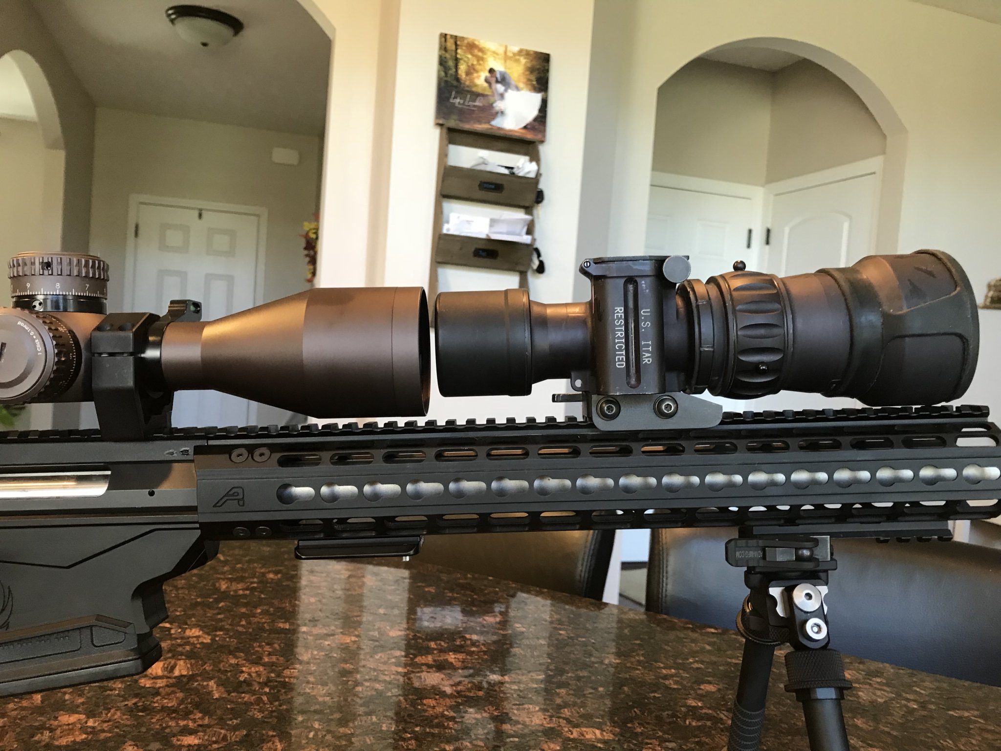

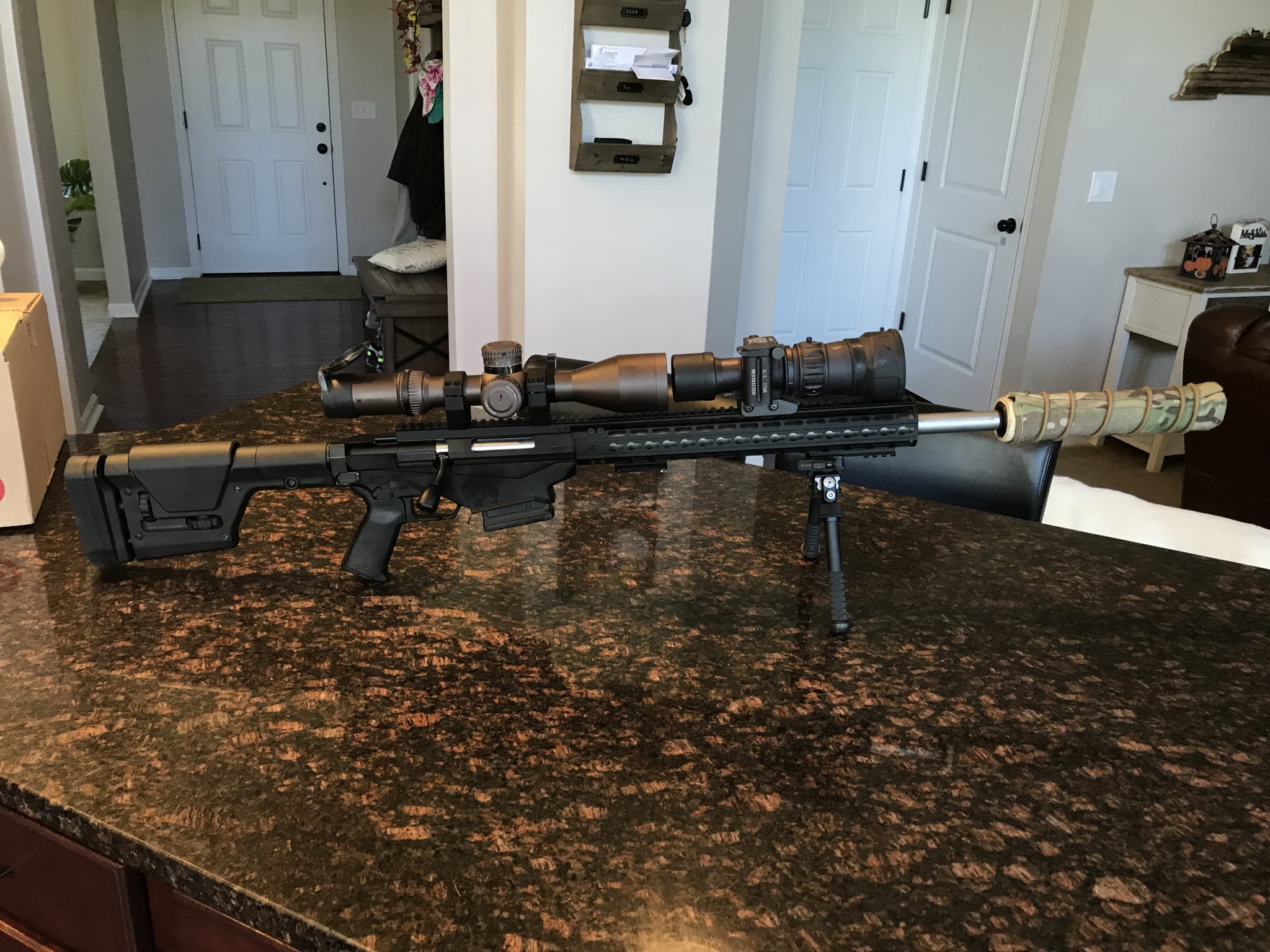

What did you end up going with as far as ring height? Just order a refurb pvs 30. Currently running 1.45” rings on a RPR. Worried a bit about alignment .
Did they make that with a canted receiver rail and flat forearm rail? Smh
No the reciever has a 20Moa rail on it. And the front is 0moa. Honestly probably will switch back to a 0moa on the receiver. Only thing about the razor scope they only have 32 mil of adjustability In them. With a 20 moa rail you get about 5 mil more in adjustability.
Only 32 mil....lol how many mil do you need
Well that’s why I am entertaining going back to a 0 MOA on the reciever. Right now with zeroed at 100 yards and the 20 moa I have about 23 mils up, meaning I would go down to only having 18 mils. I have hopes and plans on rebarreling it to 6.5 and trying my luck at a mile so I may need it then. Right now I’m hitting steel at 1000 yards with a dope of 11.2 mils. I bought the rifle used and it already had to 20 moa rail on the reciever.

I use the Badger mounts, the one piece and the SASR rings. I believe they're at 1.5" but whatever they are they're dead on for the PVS30. It's all I use anymore.
As for cant, I have a Larue SPR mount and it has some built in MOA that I wasn't aware of right away. It's on an MR/T and though it's canted a bit, it still works fine.
But ideally you'd want a Badger mount with no built in MOA. They also have lots of specialty caps for mounting SIMRAD, ACI, railed caps, etc.
I'm sure there are other fine ring and mounts available, but Badger just left nothing wanting.
