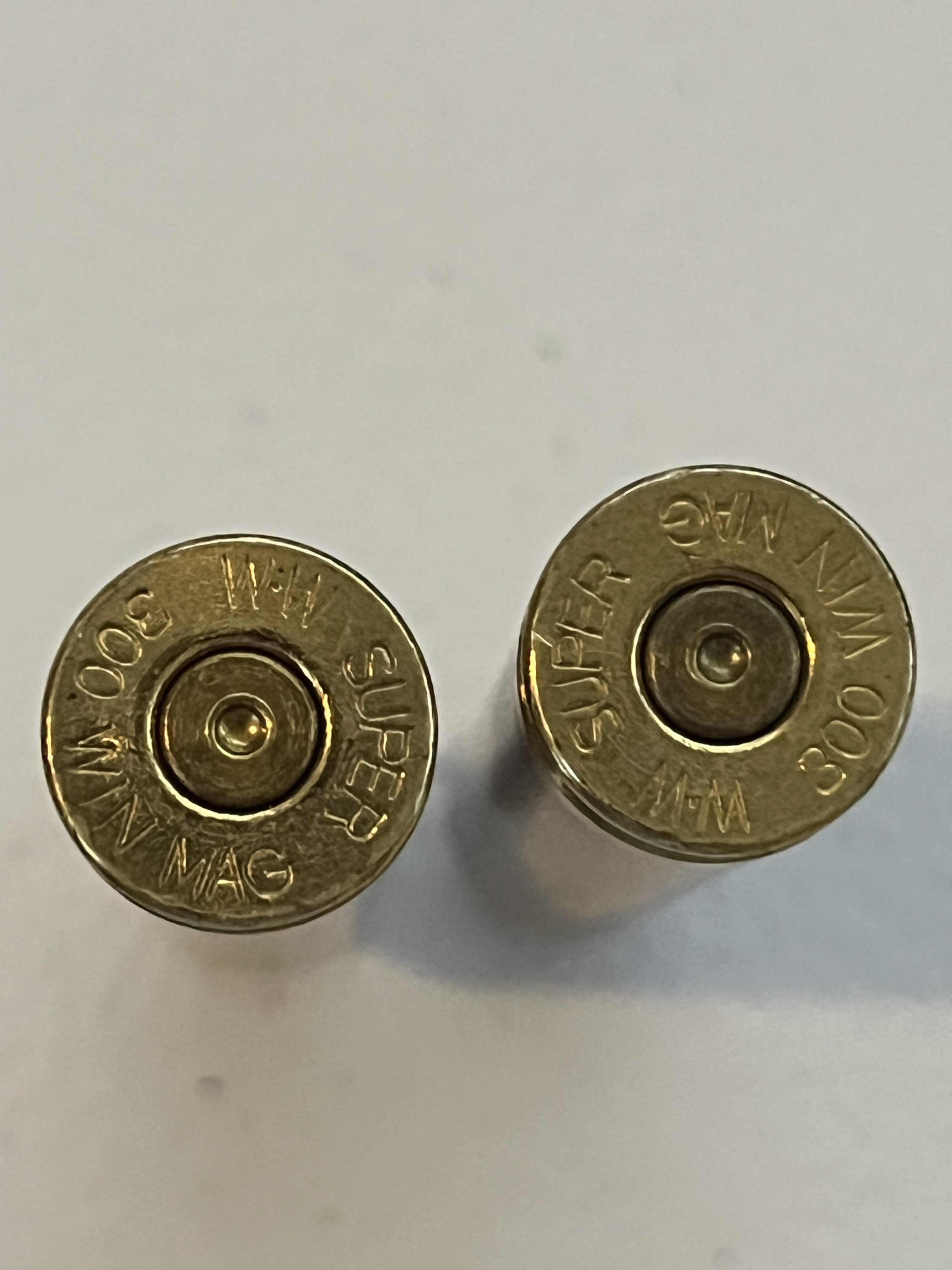

I’m adding a picture of the fired primers, and if I am on the wrong track about anything, sorry!

You do have ejector marks on the fired brass.
The cratering on the primer isn't right, but it is very common on remington rifles.

Nothing wrong with that brass. Rem 700's are known for having heavy primer flow into the firing pin hole. Look for ejector swipes on the base or super flat or pierced primers.

There are many "signs" when one thinks they are over pressure and, frankly, none of them are showing up on this brass. As stated the action screws have zer0 to do with pressure. Hard bolt lift, which I think you interpret as over pressure, can be caused by the fact that when you tightened the action screws you either didn't set a torque value or inlet allowed the action to become stressed (warped).

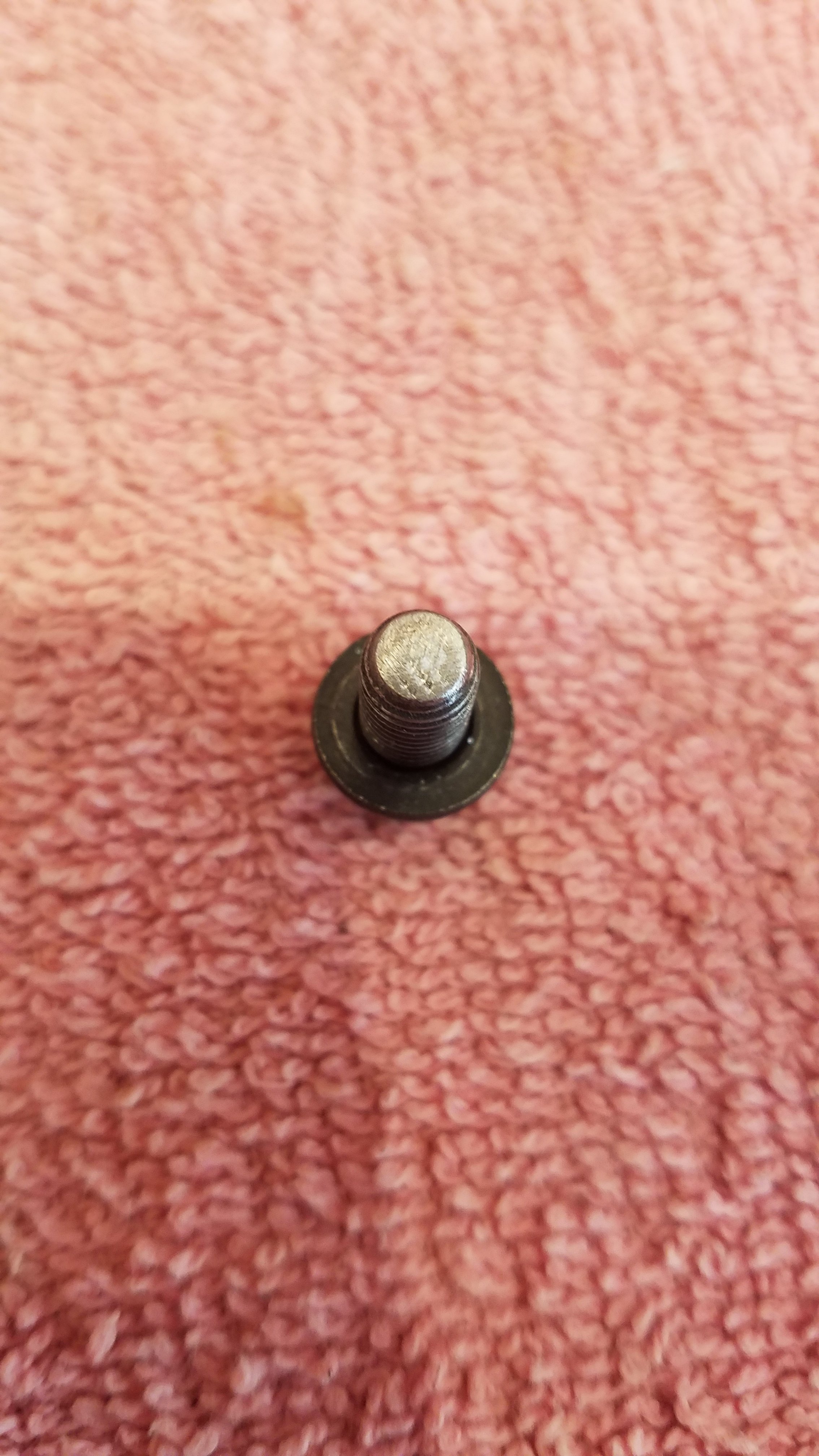

Your brass looks fine, your sticky bolt may be from a front action screw that is a tad long. You changed stocks, minor fitting can be required.
When going from stock to stock, the action screws can need fitting.
-way back when HS precision was cool, I had a stock take a dump, HS sent me a replacement stock. The original action screws were a tad short and the replacements screws were too long (hs ships new action screws with their stocks).

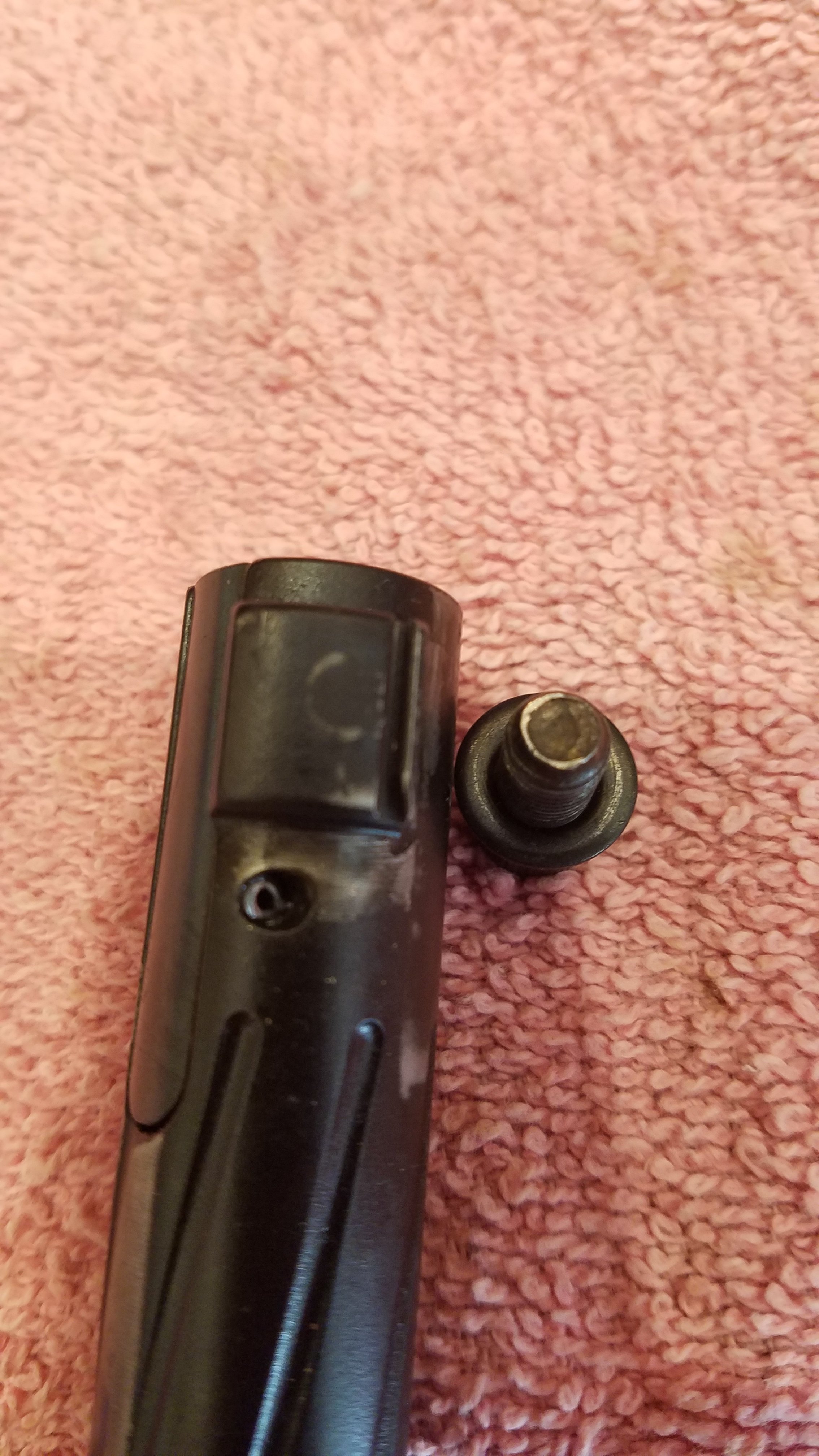

There should be a mark on the bolt lug if the screw is too long.
If unsure:
Take a marker or paint and coat the top of the front screw, reassemble the gun and work the bolt, if the paint is in the bolt or paint is missing from the screw then the lugs are making contact with the front action screw.
Brass looks fine. Is there any galling/wear on the bolt lugs on the back side of lugs? Might be as simple as a lack of lube or a rough mating surface for the lugs.

Here's an example of a fairly long term issue with a front action screw that was too long.
The rifle would shoot an occasional good group and then just throw shots.
Filing the screw eliminated the contact and the fliers.
Mike, this is an incredibly helpful picture. I can see where my screw made the slightest amount of contact with the lug. If you don’t mind, how much did you file the screw down? I would imagine a small change would alleviate this.

Until it stops rubbing, then one or two passes more for good measure. Id take one thread off to start with

Those case heads look fine to me.

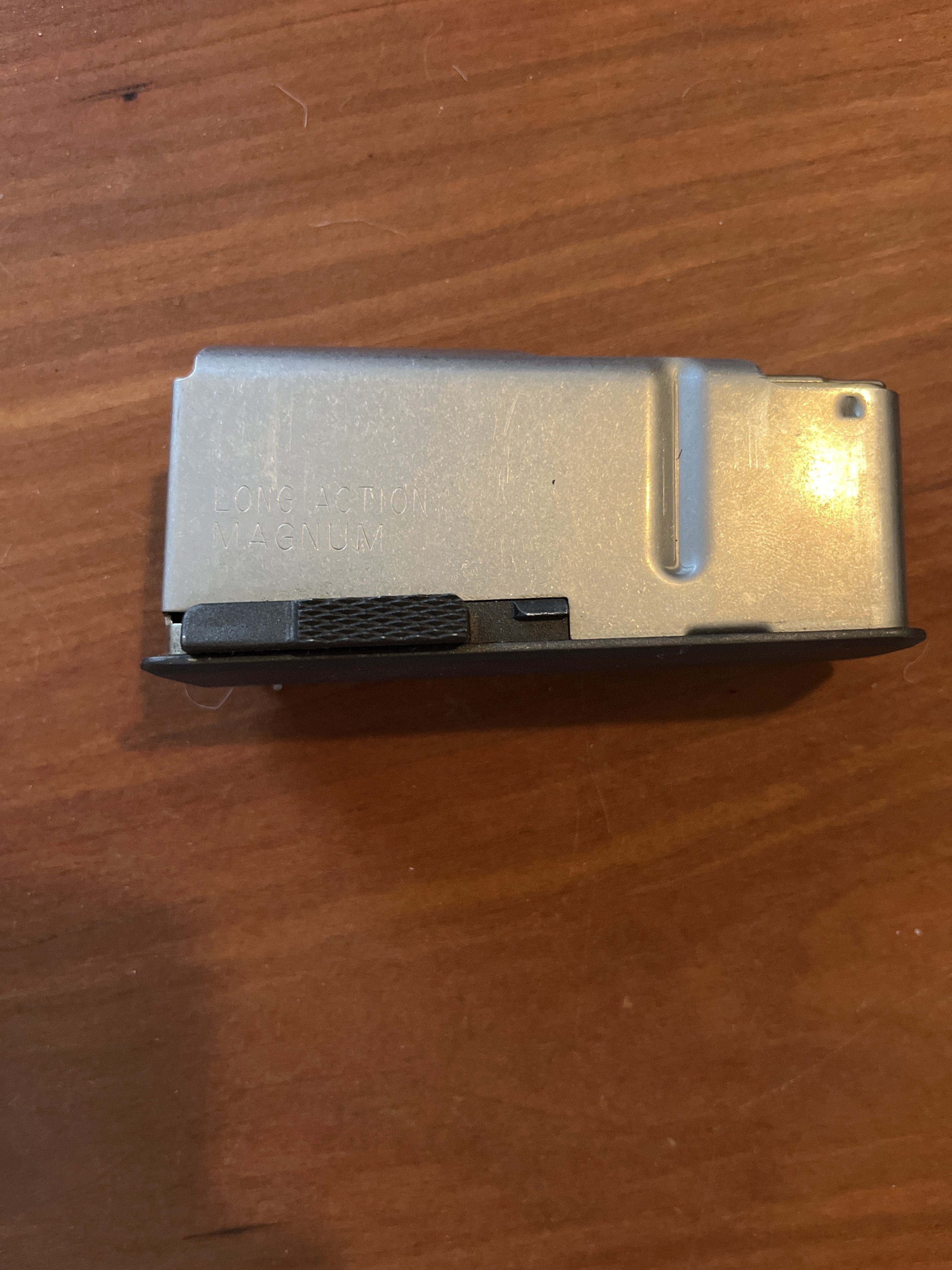

Show some pictures of the magazine and the magazine release.

Thanks again for all of y’all’s help! I’ve done a deep cleaning, and I will be trimming the action screw once I’ve got the time to do so. Looks like once I get the magazine issue figured out all that’s left will be figuring out the permanent glass for the gun. I’m more confident in that field!

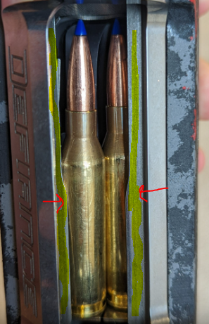

With bdl the action has to be cut for the rounds to sit against the aciton itself and still feed without spitting up out of the action.
Stealing someone elses google pic here, I highlighted in yellow and put an arrow to the action itself being cut for that

Nope. Spife’s pic shows the rails. Those are milled out for the factory DM system. I should know, I have a 260 Rem DM from way back and it wouldn’t feed from the factory setup. The geometry was off quite a bit for some reason. I bought a different stock and CDI system and sent it to Jeff for the inletting. AI mags and CDI had a reasonable price on the BM and inletting that nobody else could touch price wise and he’d inlet the stock and have it back to you in a week or less. I still have a spare CDI SA in my box of crap.

Before grinding on the action screw, it’s not a bad idea to run a 1/4-28 nut onto it so you can chase the threads to clean them up.

As to the magazine, those factory Remington DBM’s are pieces of shit. Seldom do they function correctly. 2013-2014 also puts your rifle in the timeframe that their QC was at its absolute worst. It was better right after freedom group took over and then was improving again right before the bankruptcy. It dipped down hard in the middle of the time period freedom group owned it though.
Beyond shortening the screw to try that and minor stuff you can do yourself to try to get the magazine working it’s not worth messing with any further IMO. If the screw doesn’t fix it I’d send the barreled action down the road for the value of the action for someone to build, eBay the stock and bottom metal assembly, and put the $$ towards a better rifle.
I think a lot of people have used duct tape to pull that particular magazine up tight where it feeds. I beleive it's an hs precision bottom metal and is a well known problem child. The bdl go thourgh on ebay quite a bit but you will need it all. Spring follower and magazine box.

Bottom DBM.
That is a Rem OEM POS. Def not any iteration of the old HS Precision.
The OEM bottom metal is so thin and crappy that most shops would refuse to coat them during a rebuild because they were so thin and fragile at the corners there would be a high probability of breaking them while simply abrasive blasting them in the cabinet.
Those mags will only work with the period Rem OEM bottom hardware ( it is not even worthy of using the word "hardware").
