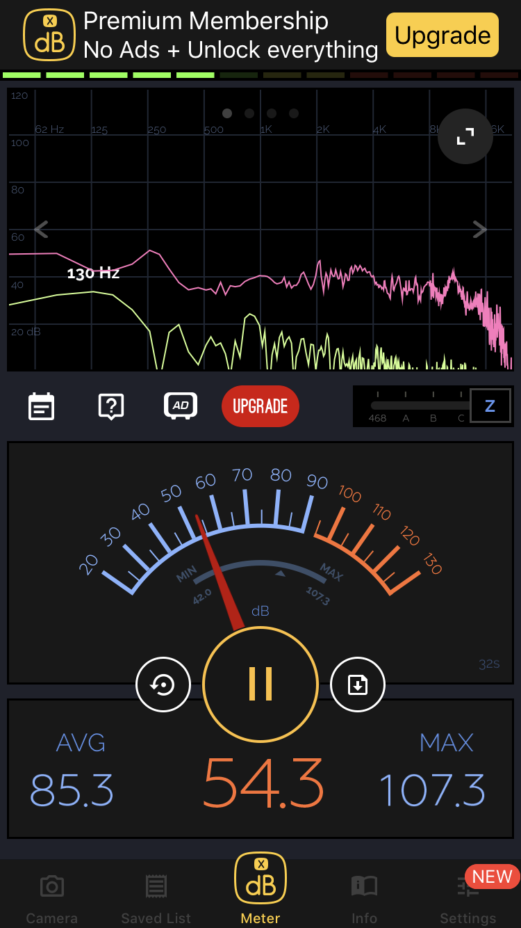

    I have a Tac Ops 5.56 suppressor that I had mounted on an Aero Precision 10.5” SBR. I never check what the decibel level was on it. However, I did try and shoot it without ear pro and I’m sure I did permanent damage.

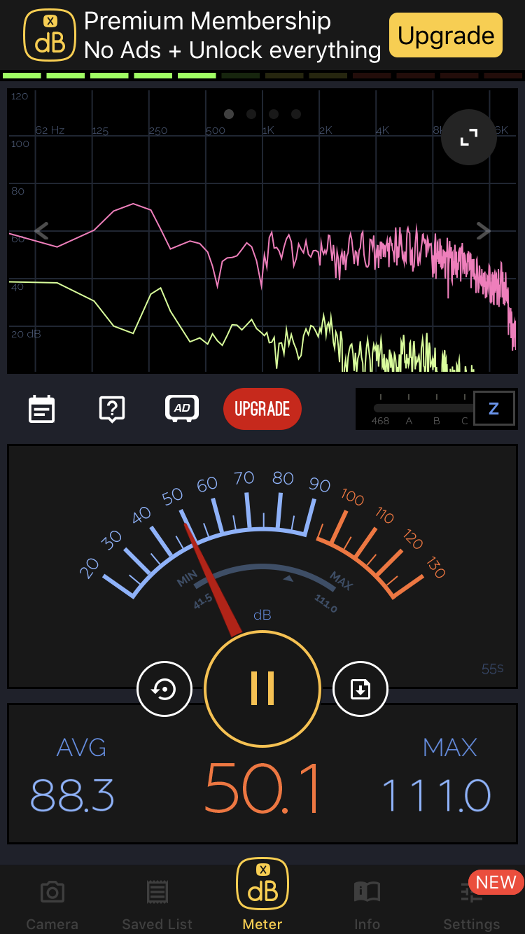

    I saw a YouTube vid saying that 11.5” barrel increases the FPS by 100 fps over a 10.5” barrel. So I figure it burned more of the powder off. That said I purchased a BCM 11.5 upper for my SBR and put the Tac Ops 5.56 can on it. While using ear pro I shot the weapon and checked the decibels. It averaged 109 decibels with Federal 55gr plinking ammo. So, I removed my ear pro and shot it and it wasn’t bad at all. I will still shoot it with ear pro, but I was pleasantly surprised and now will use this SBR a lot more.
    Ya I don’t think your readings are correct. The bolt alone is at least that. And your in the teens generally speaking with 300 blackout subsonics suppressed. Anything supersonic is going to be around at least 140. Are these subsonic 55 gr?

    This is just the standard Fed 55 grain. I measure at the muzzle (end of the suppressor).
    Ya I think you need another decibel meter. Most suppressed AR 15 will be around 140 ish at the bolt (at least on a DI gun) and around low to mid 130’s where your measuring from. I don’t think you understand how quiet 109 decibels is. I’ve run a Thunderbeast ulra 9 for several years on 16” AR’s. There regarded as one of the quietest suppressors on the market. And I’ll guarantee you I’m lucky if I’m below 130 decibels at the muzzle with that. Not saying it can’t be real, but I think the results are lying to you.

    The more I google this, it doesn’t seem possible. I used this app with my race car for when I have to add baffles to my car to make noise levels and it’s been right on with their test equipment. That said it just doesn’t seem possible to get these results. I will say it’s a lot quieter on the 11.5 vs the 10.5.

    Yeah those apps have some use for constant sound but only very expensive equipment can accurately measure the fast rise time and short impulse peak of a gun shot. Meters that are decades old still cost thousands of dollars.
    Go look through the spreadsheet at nfatalk.org to get an idea of typical levels--they use good equipment.

    Yeah, what Zach said...There are basically two sound meters that meet the req's for suppressor sound measurement until you step up to piezo pressure transducers and a fancy data acquisition system. And the android or iphone do not meet these req's to say the least. I heard one person state that they measured 79dB out of a suppressor, while my real meter said that a dryfire of the same rifle measured 110db. And as another example, a suppressor on a bolt gun reads 125db and the same suppressor reads 145db on an AR gas gun.
