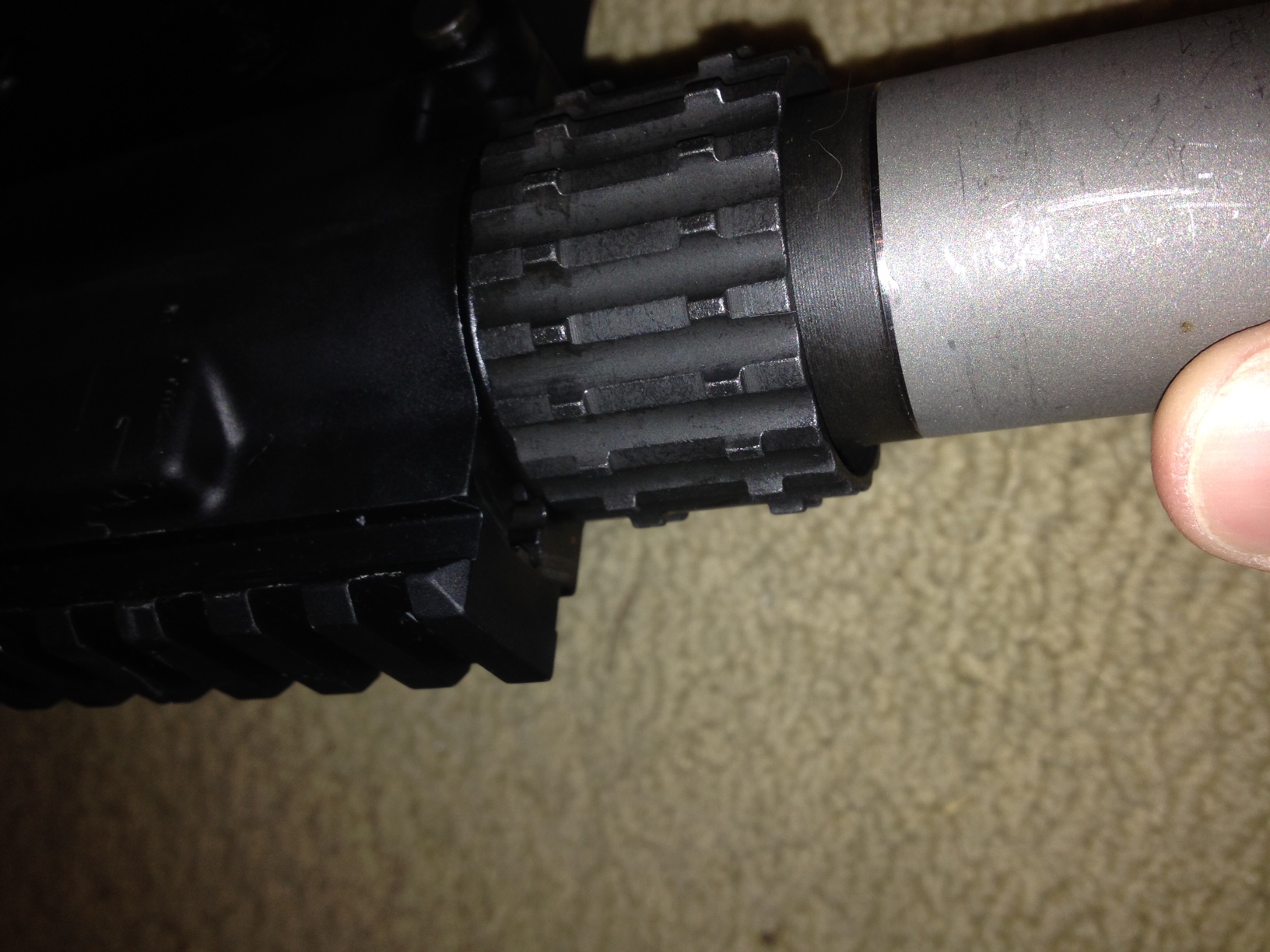

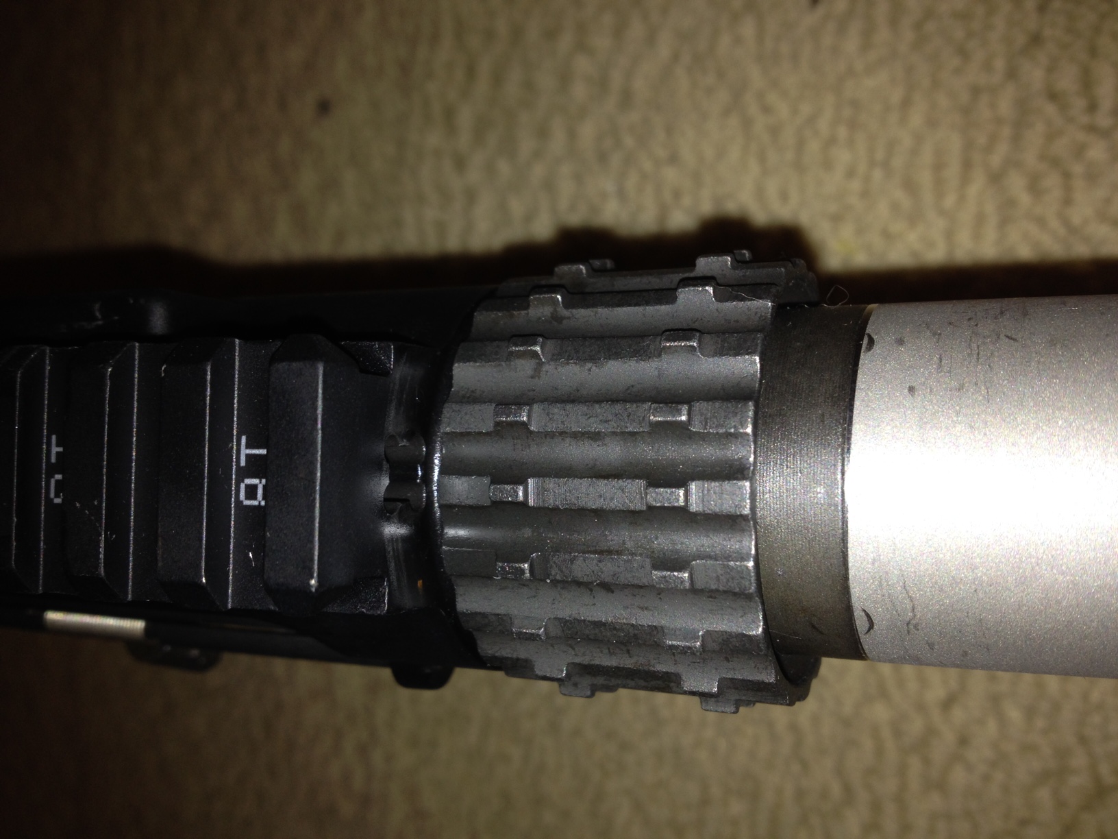

I am installing a Troy Alpha rail on my AR10, and seeing as I do not have a vise or KAC barrel nut extension wrench/other tools, I took it to my local shop to have them install it for me. He came back and let me know that the teeth barrel nut would not line up correctly with gas tube hole on the receiver and that he would have to torque it past 90 to get it to fit correctly. He recommended that I snag some barrel nut shims and bring it back to have it fit correctly. Did some research here and elsewhere on the internets to see that there are a few different methods to making this fit correctly. My questions are: Is using shims the proper method for correcting this is? Should the timing be an issue at all with a torque range? Should I only use other methods to correct this issue? I can post pictures if needed, but I want to keep my hands off the upper because the more I put my paws on it, the more I want to grab a dremmel and say "%*(# it" and grind that tooth down.
BTW: Per the instructions, recommended torque for this is 30-50ft/lbs.
Thanks.

NSO/Sierracharlie,
It's not an issue of getting the rail to be flush with the receiver. It is an issue with the teeth on the barrel nut blocking the gas tube port on the receiver. The AR10 Alpha rail has a proprietary barrel nut which is different than the stock AR15 one, and installing the Alpha rail on the AR15 was a dream. Once the barrel nut is in place, it was easy to install the rail and line it up correctly and tighten it down.
SMM,
I added some pics, and the tooth is covering the left side of the hole. When the guy went to install it, he put it on and backed it of 3 times, and this was still the result we got. So it looks like shims would be needed? He left it at 30ft/lbs, and that is where it sits in the pic. It is still blocking the hole. The link below is what I have found for barrel nut shims.

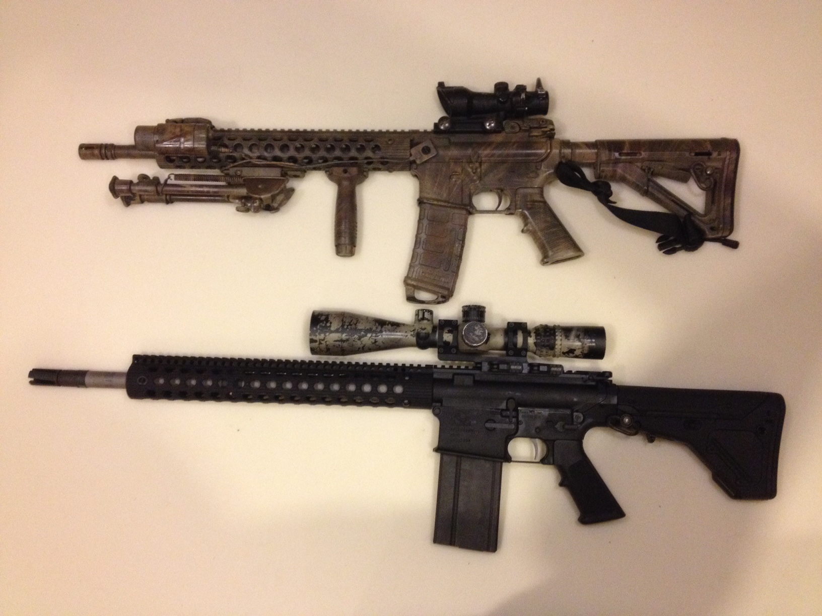

To give some closure on this and help anyone else who may have this issue, I called Troy's Customer Service who were very helpful with the issue. Explained everything to them, and their recommendation was to torque it up to 85ft/lbs, and if this did not solve the issue, order a new barrel nut to try. The advised against using shims to fix the situation. Went back to the shop and tried it again. It had to go all the way to the 85ft/lbs in order for the teeth to line up with the gas tube. Now everything lines up and is put back together. Pics are below. Troy Alphas on both rifles.
