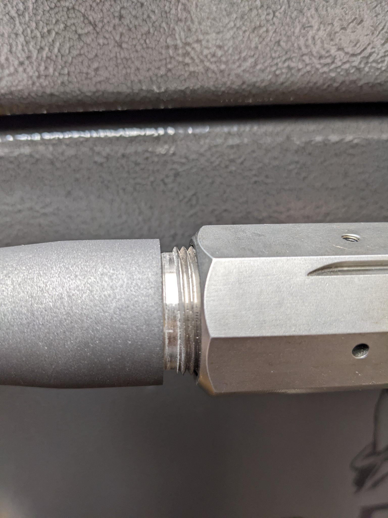

Gunsmithing Barrel thread and shoulder machining?
Get your action back then out the smith. That’s terrible work. I haven’t cut threads for 10 years and I’m sure I could do better.
I spoke with customer service and the action is now in the mail and arrives tomorrow by 7pm. After that I'll get in touch with the owner/head guy and confront the issue of the threads. While there are likely serviceable, they sure don't look professional.
That’s a disaster!
I see a few things wrong with that.
I’m a rank newbie and my work is better than that!
That's good looking work.

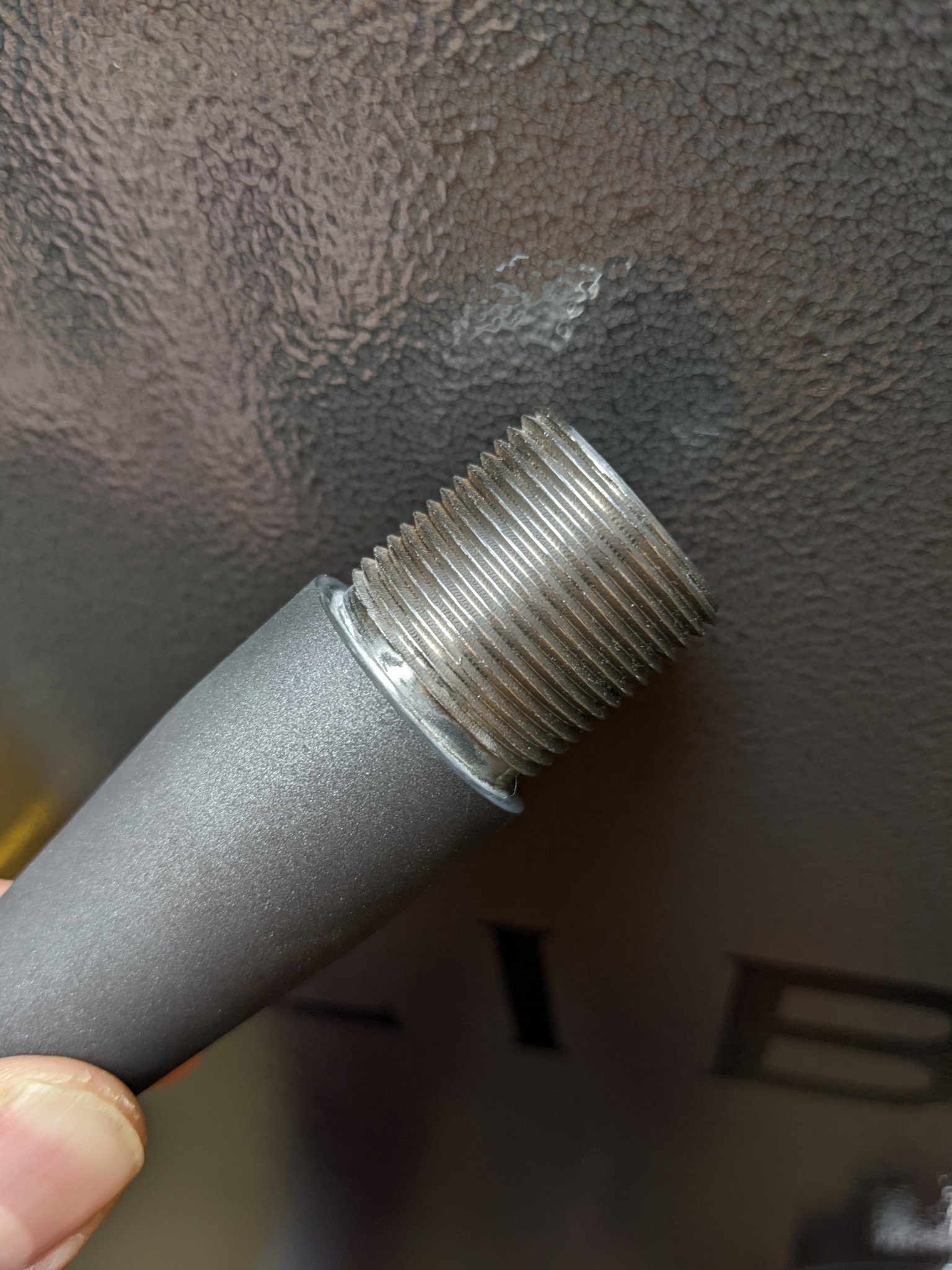

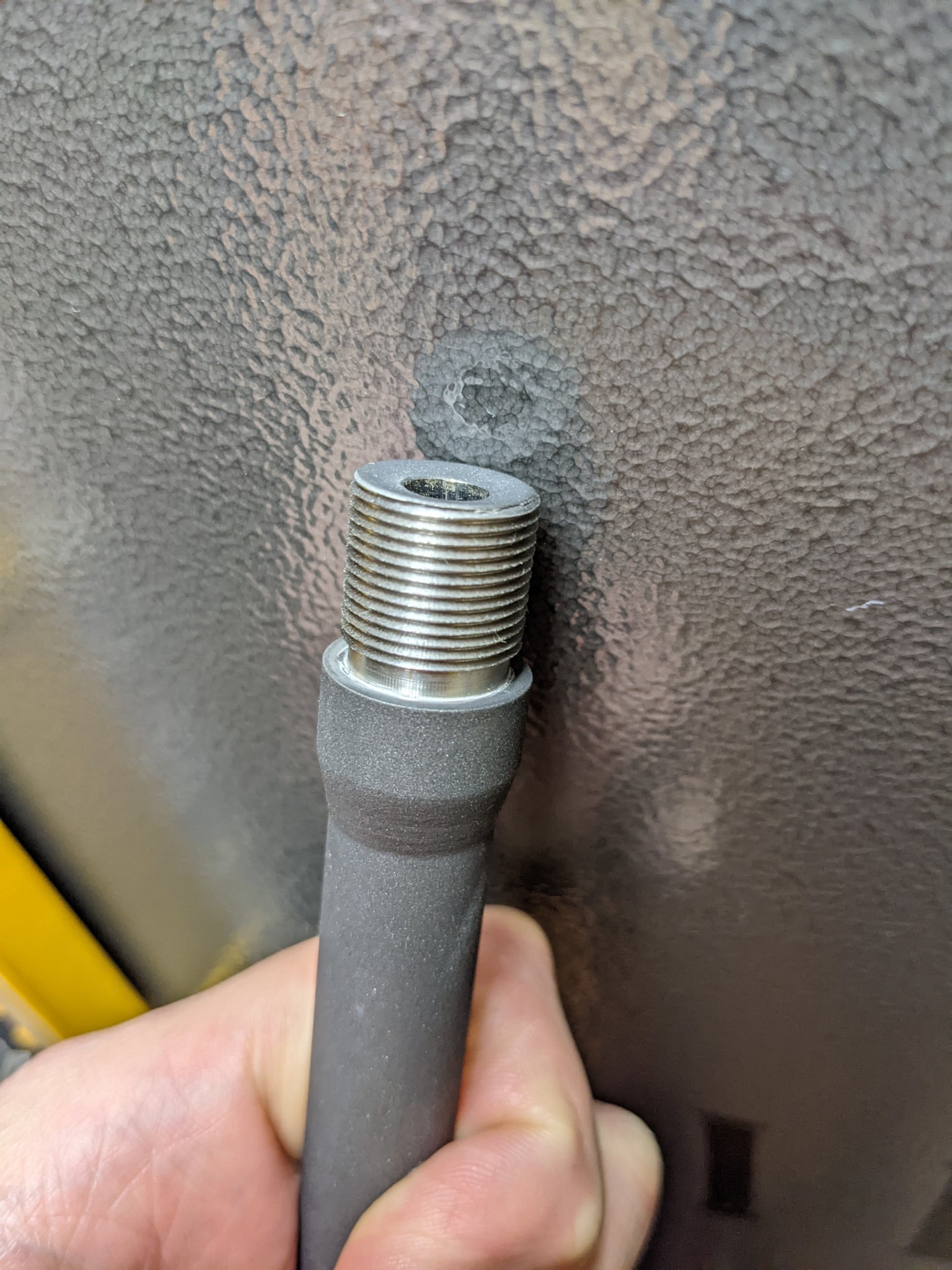

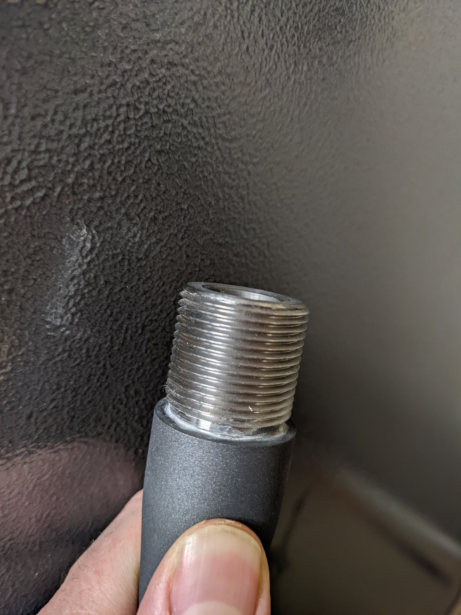

How do you think this last set of threads were messed up? I really have no machining experience but I'm thinking I need to learn.
This is the second thread?
1-The beginning looks smeared and wasn’t cleaned up or a botched start.
2- excessive chatter an burr’s never cleaned up on the peaks
3-see that partial thread at the end? That need to b cut back with a chamfer as that’s asking for problems in whatever it getting threaded on it it cutting you.

Looks like the half nut may not have been fully engaged on one of the passes too.
The chatter can be from a few things as previously mentioned.
I just can't comprehend how you let that leave the shop and hold a straight face.
Indeed! You gotta wonder, with such poor attention to detail, are the threads even remotely bore concentric?
By the way, what kind of action do you have?
Tikka.
And yes, that's the second barrel. We had a conversation about the first set of threads so I was very surprised to see these.
How long does it take to learn to cut a good set of threads on a lath? I have access to one at work but have never used it.
Sadly, these are not the worst set of threads I've seen. The inside of the chamber and barrel look excellent though.
Wouldn't count on it being concentric at all. I also hate the thread relief, looks like a quick plunge cut with a parting tool. Then left 90 degrees so the last thread tapers to flaky wire edge.

Have the machinist at work show you how to use the lathe, setup, threading etc. Lots of on-line resources too. Barrel work is pretty focused, and you dont need to be a school trained machinist to do it.
You could probably also assume that the barrel shoulder itself was established with the parting tool....another no go.
That might be the case. Right where the action would shoulder to the barrel there is a groove on one side and flush on the opposite side.

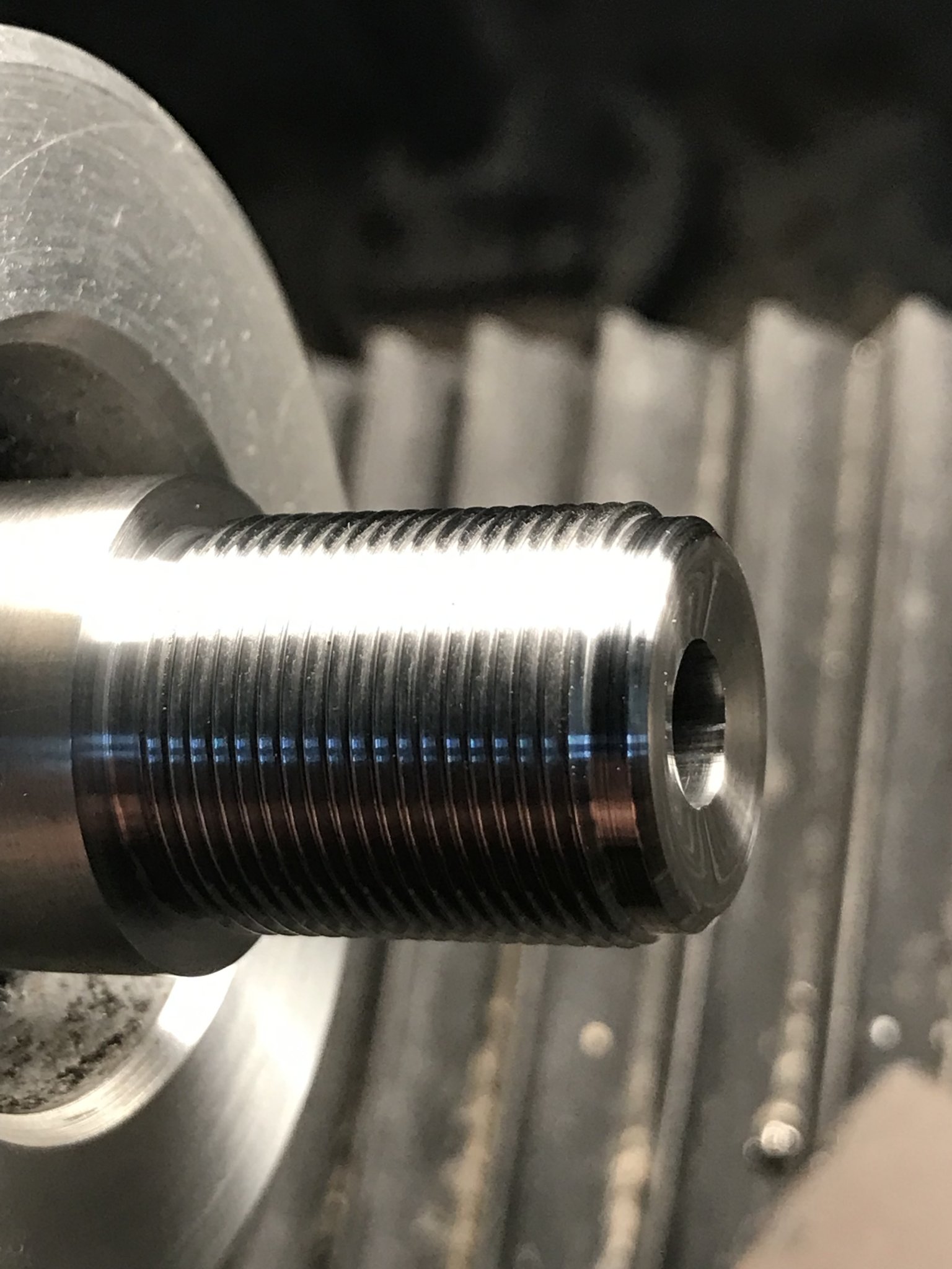

As an update, the refund came through from McGowen. It was 100% of purchase price. I had thought of sending it off to someone to thread 9/16 and forget about my dream of 5/8x24. I'm glad I didn't keep that barrel. Prior to sending it back I did try to screw the action on but didn't want to force it too far. it became apparent that the threads did not match close enough to my action. I probably could have put a wrench on to torque it but I had no interest in screwing up a good action.
So, that brings me to today. I received a barrel this evening from another maker and it looks PRO. The threads are immaculate and the action spins on like butter. The only issue I've found with it is that it's marked 260WSM instead of 270. I was a bit confused by it at first but I'm going to chalk it up as a win. I'm happy as a lark that everything else looks good.
thanks for all the replies and help with these issues.

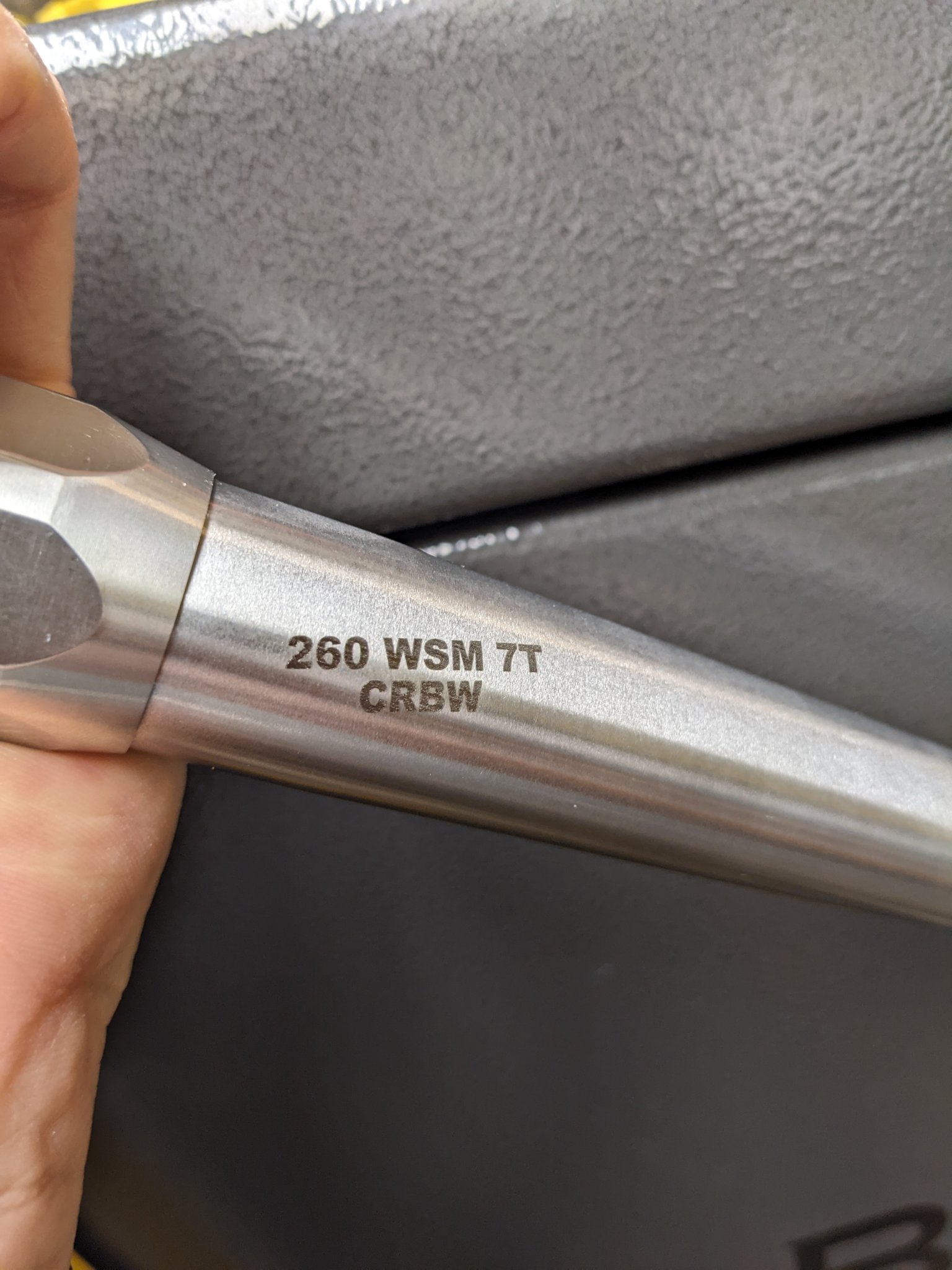

I would at least verify chambering before torching one off. Yeah it could be a typo, or it could actually be a .260 WSM
I hope we are being trolled. Dealing with “Gunsmiths” in this industry can’t actually be this bad.
I wish I was trolling you. This is just how things go for me. Caveat emptor. I'm new to custom and semi custom guns but not new to guns in general. I spoke to the Smith tonight and he verified the mistake. I also did my own measurements to confirm. He really did great work and made a typo. There was an offer to fix it but I really don't care about it. I'll likely put cerakote over it anyway. Now I just need to choose a scope and decide if I want to mod the factory stock or wait for a privateer.
So it is the correct caliber. Looks like things worked out for you. If I were you I would never go to Vegas. :p:p

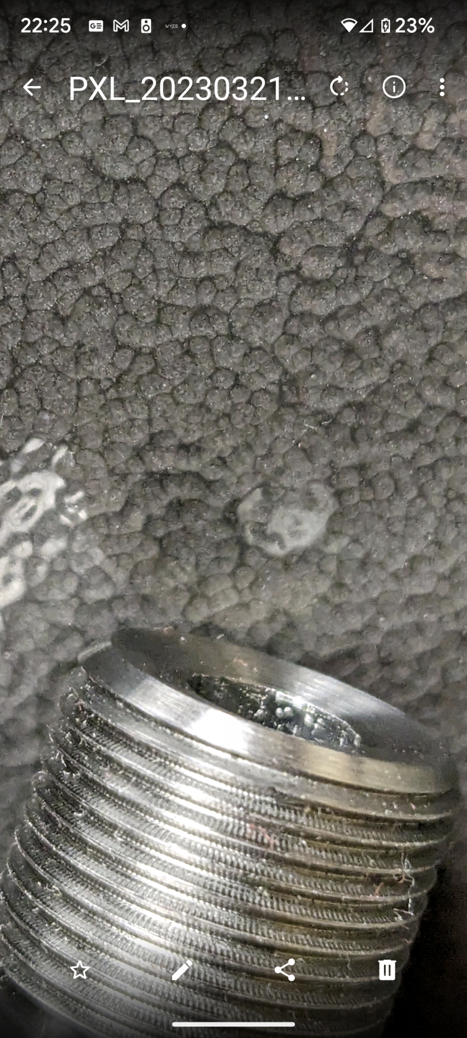

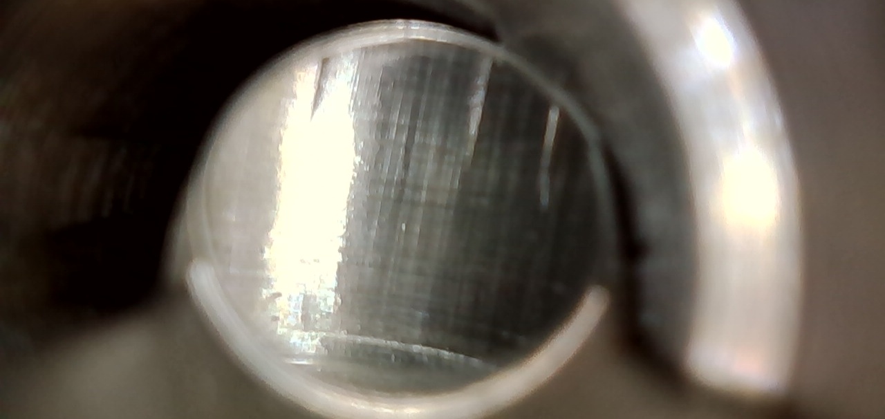

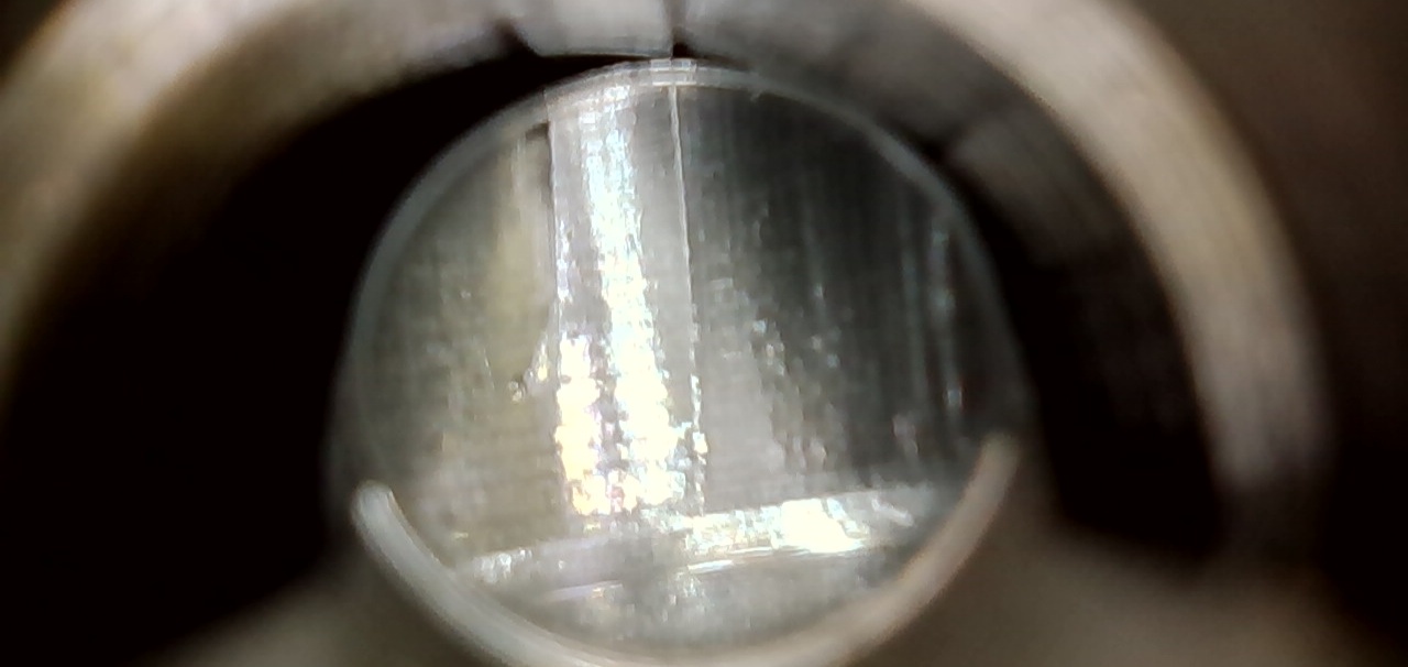

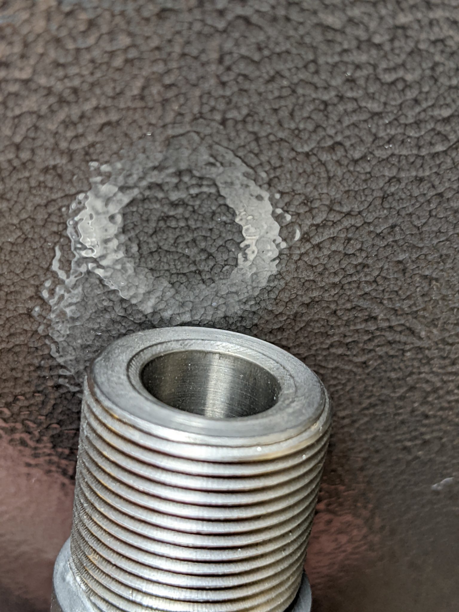

Update:
I rolled the dice again and it came up snake eyes on this carbon barrel. Choppy threads and throat not concentric. I didn't go any further on inspection.
