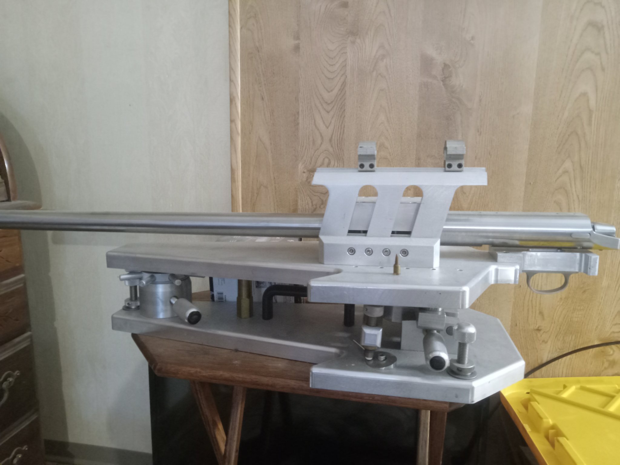

I use this to aid in recoil management

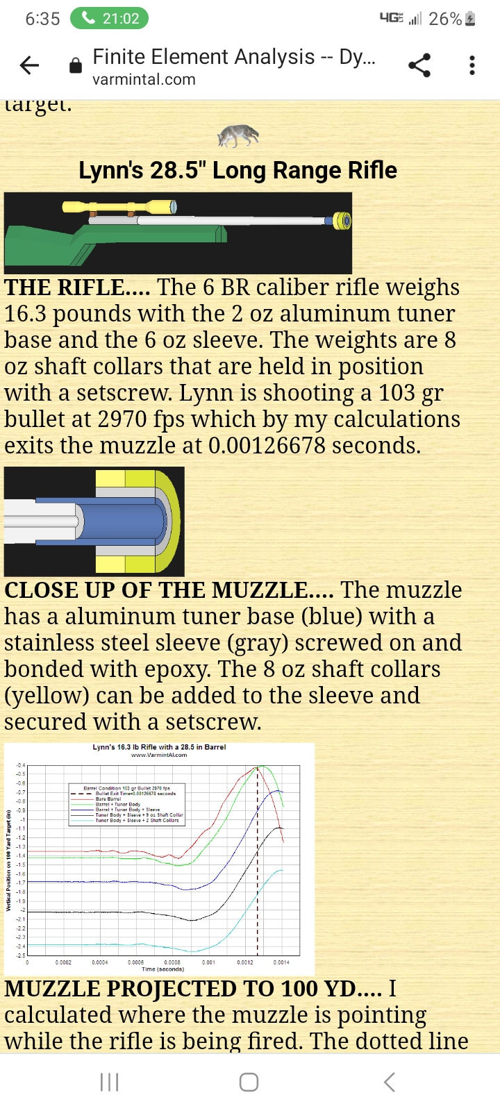

I haven’t had a chance to read the entire write up but came across this on Accurateshooter. https://www.varmintal.com/aeste.htm
That's worth a read, along with most of his other firearms related pages. His model is on the crude side, but his barrel motion plots are qualitatively similar to measured motion data from ARL publications.
The biggest downfall of his tuner related work is a lack of experimental data to validate it. The Esten page has one low sample size test with dubious agreement in the data and the page Lynn is so proud of displays this statement: "Assuming this model is an accurate representation of the actual rifle. This is a very lengthy calculation to come up with just two numbers that might or might not be verified".
IMHO, nailed it. The downfall of most existing tuner related work is the lack of validating data. Anyone that uses competition results as data that certain equipment is better is making a fallacious argument.

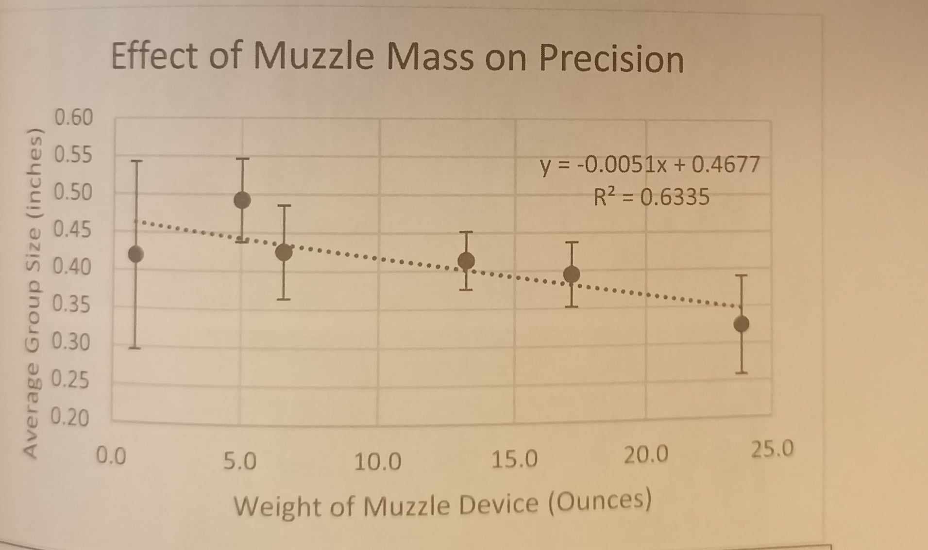

Page 105 ''effects of the muzzle mass on precision'' , kinda goes like tuners work , just not ultralight versions we were testing
That's not quite how I read that... Adding weight may decrease dispersion, but that doesn't imply benefit to moving a heavier weight slightly fore and aft.
Also interesting that there is very little change with masses up to 16(?)oz. The R^2 without the 24oz data would have an even mellower slope. Either way, another good reason to always shoot with a suppressor.
This short exchange actually lines up decently well with the VarmintAl work. If we assume that someone were to come along and validate his FEA model, the single largest takeaway from the tuner pages is that the most impactful thing you could do to induce positive compensation is increase muzzle mass without increasing barrel length. The predicted effects of moving the tuner are small relative to simply installing it. Which, to give @timintx credit, also lines up with what he has argued in other threads in terms of calling heavy, non-adjustable muzzle brakes "tuners".
As skeptical as I come across in many of my posts, the potential theory is there to explain positive compensation, I just want to see clearly organized large sample size data to back it up. (On the other hand I will say that I've never seen a good physical explanation beyond inertial effects as to how a tuner would theoretically reduce overall group size like Cortina claims, not just vertical)

I actually posted the range a tuner can compensate for and I told the world how to calculate the weight and its position in an earlier deleted thread.
I also posted most manufacturers of tuners just make parts and have no clue how they work much like most posting here.
It comes as no surprise that Bryan admits that adding weight to the muzzle is a plus as Vaughn said that over 20 years ago when Bryan was first starting out.

A heavy muzzlebrake is better than a light one but a tuner which is just a mass is no good at all.

The correct way to test would be with a machine rest or return to battery rest like all reputable bullet and ammunition manufacturers use.
And there is no such thing as a blind test when testing a tuner.
The gun either has a tuner on it or it doesnt unless they covered the barrel with magic pixy dust so the shooters couldn't see it.
