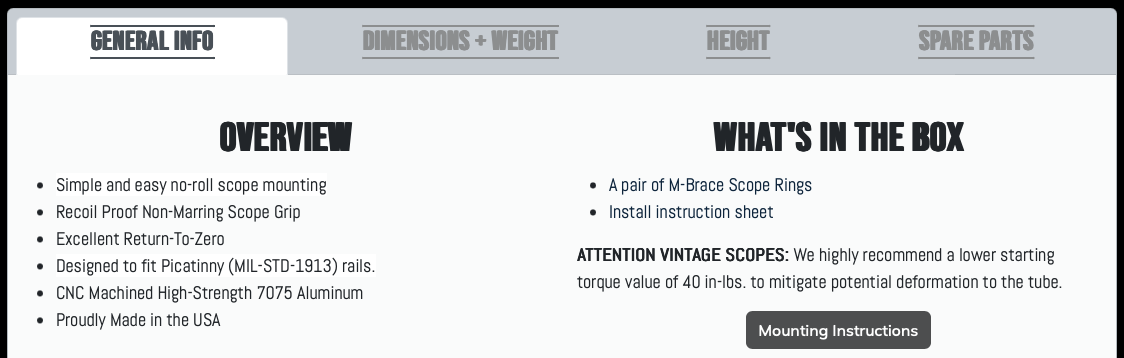

(On another note, I saw recently Ted dropped the torque value of the M-Brace rings to 40ftlbs, down from 55ftlbs)
The lower torque value of 40 in-lbs only applies to "vintage" scopes. ARC still recommends 55 in-lbs in their mounting instructions for the M-Brace.
M-Brace Scope Rings Installation Instructions
